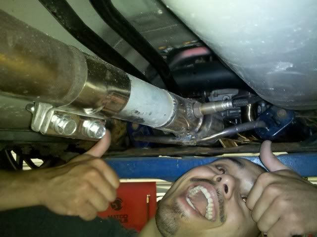

I know I keep bombing your thread for suggestions - but I haven't found anything from a search of the web for my particular issue, and it's probably a dumb question, but I figured if anyone was to answer it - it'd be those that have done the KL-p5 swap already:
I'm using the ebay special headers and y-pipe (2.5") for my KL. The collector that joins it to the exhaust going back doesn't fit quite right, so it's got some play.
When I romp the gas, it should move the flexpipe between the 2, but instead (no matter how much I tighten it) - it slips that collector collar and BAM! ...instant exhaust leak that spews plennnnnnty of exhaust gases into the cabin. How'd you "solid" that up to make it the best fit possible?

No problem, you can always ask questions and I'll help as much as I can. Not to sound like a d-bag but your first problem is probably the eBay headers. I've heard on PT that they usually don't line up very well. I have the OBX headers and they lined up pretty well. Then I simply cut off the collar that is supposed to connect to the midpipe and Josh welded it in for me. Then I used a heavy duty exhaust clamp to seal the top he couldn't reach with the welder. After i removed the motor I noticed the seals from the headers were leaking a bit so I would put some high temp silicone between the gaskets for insurance. I've used it before on headers and exhaust flanges and it's worked great.
Here's a pic. Excuse Josh's silliness. haha;
-edit- he also cut off the exhaust hangers, bent them and welded them into a better location. And the discolored middle pipe is basically and extension to reach my CorkSport cat back. I picked that up from Autozone.
