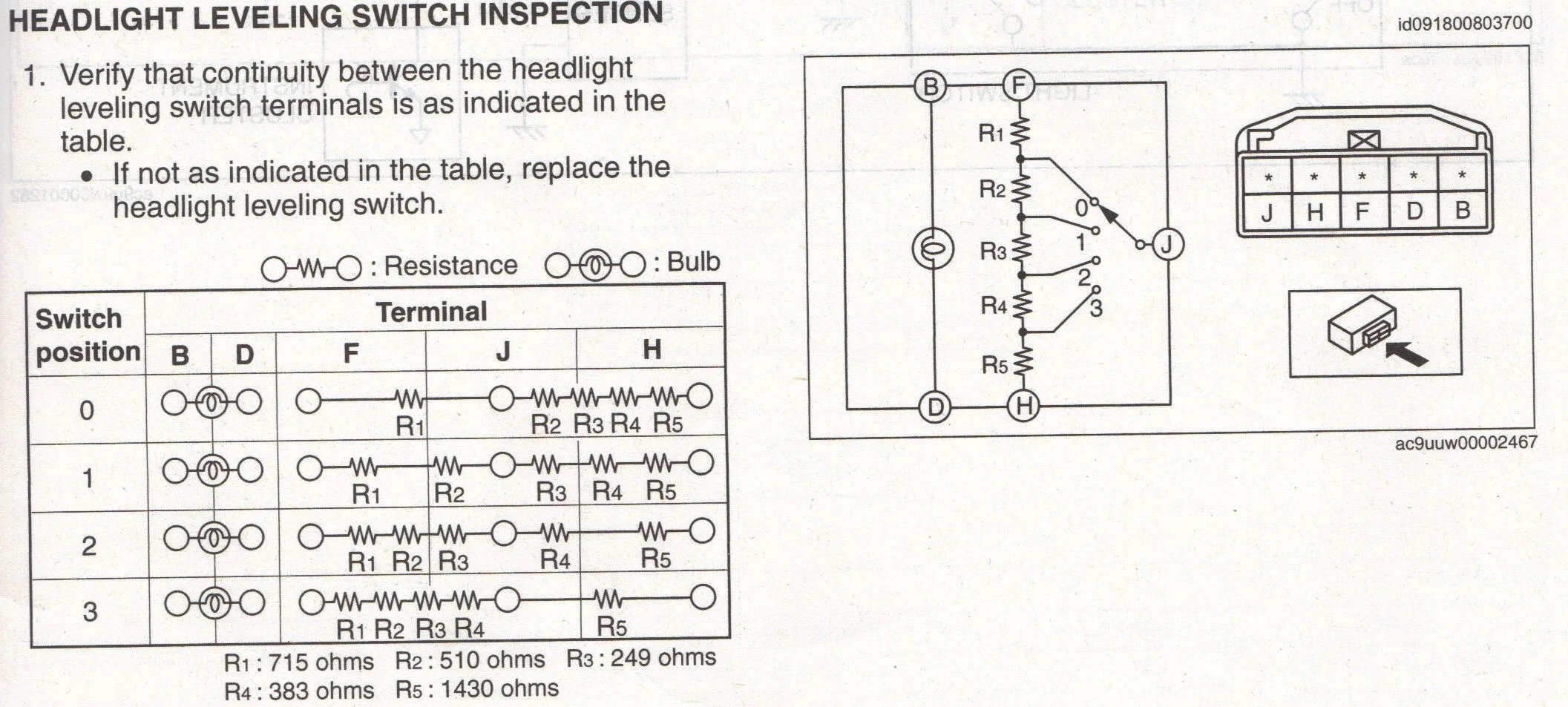

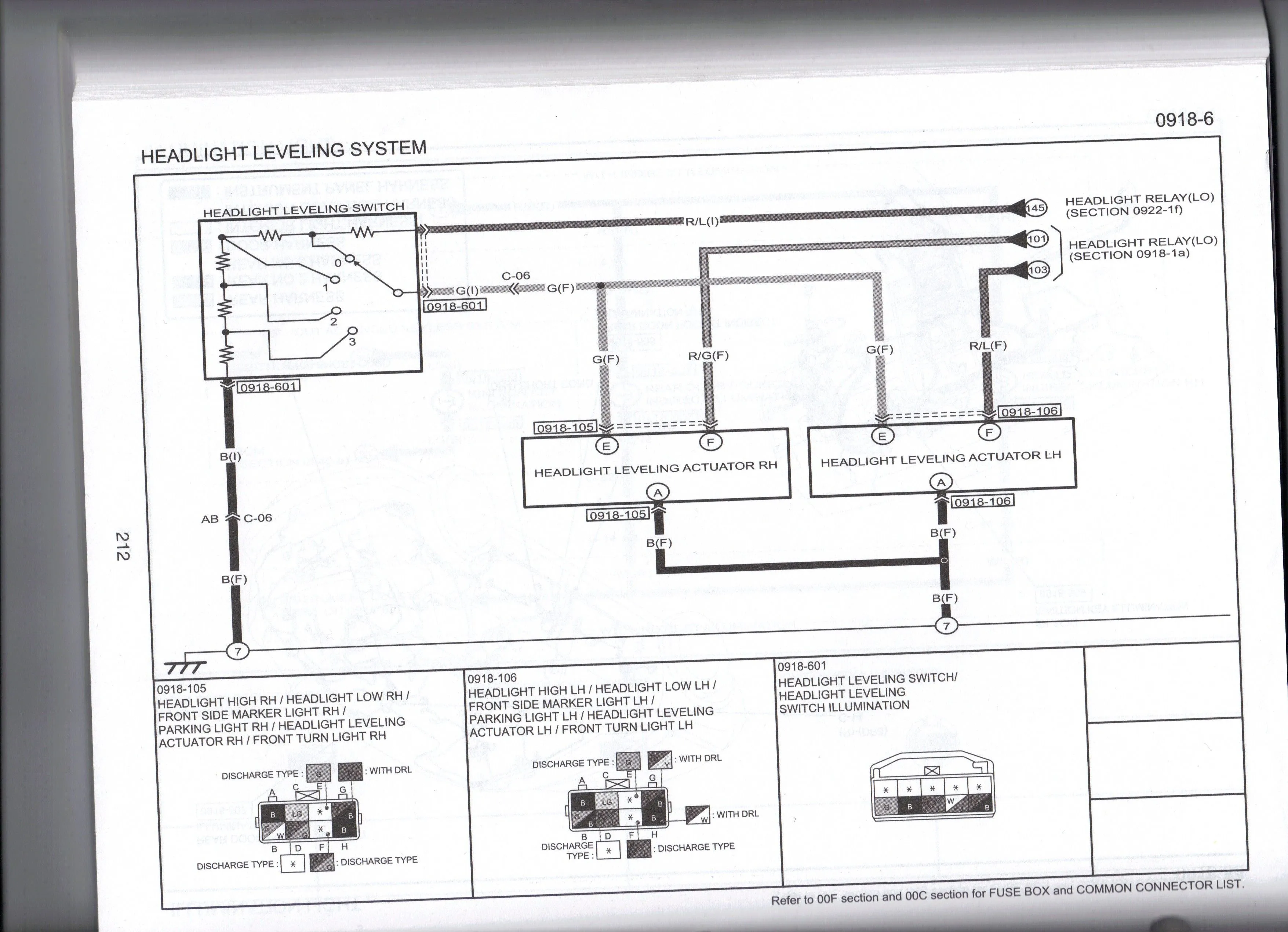

This not driven by the BCM. The same fused 12V are being used as for the lights. So if the lights work the fuse should be good. Maybe you leveling switch has a problem(or the connection to the switch) attached information can help to diagnose
Thanks for the reply. I can't figure out how to get behind the switch to check the connector. Maybe I should just live with it.
