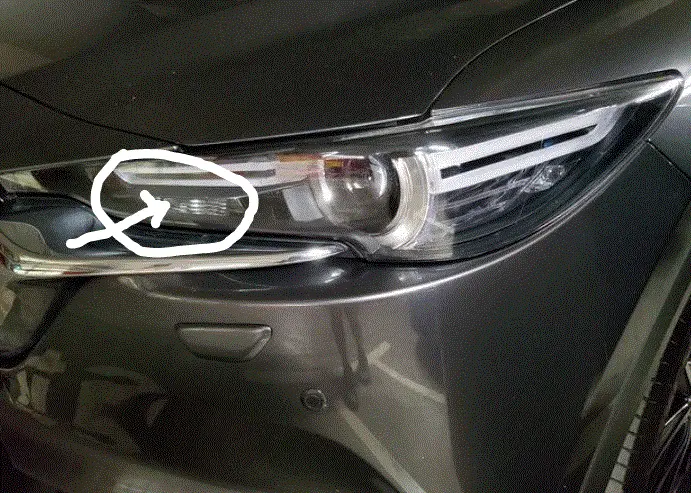

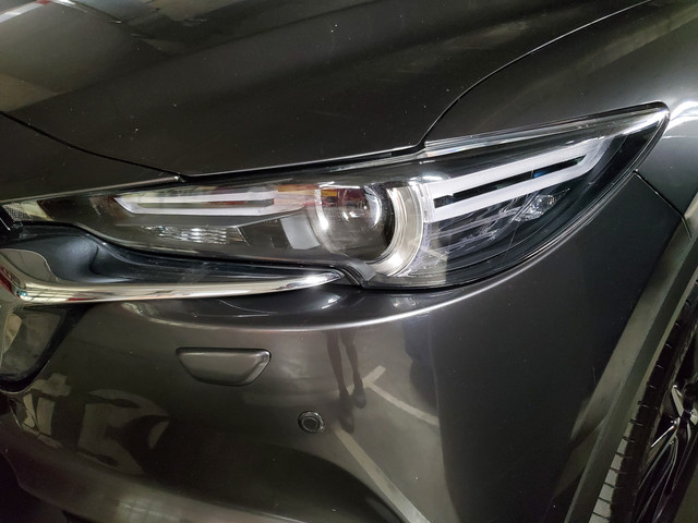

yes, on the US models the headlights on low power mode are the drl. on the european its the Led signature lines (all trims have led lines drls actually) that act as drl.
On the european 2020 model there is no Led signature lines, its LED parking lights as DRLs
Opinions on the Auto mode are not relevant to the topic of the thread. Please stay on topic.
thats what I meant by drl signature lines :) above pics are from the eu models gen2.
same are on GT and higher trims in US but cant be used as drl although it would be great if they could be.
This is DRL in EU, Signature line are parking lights.

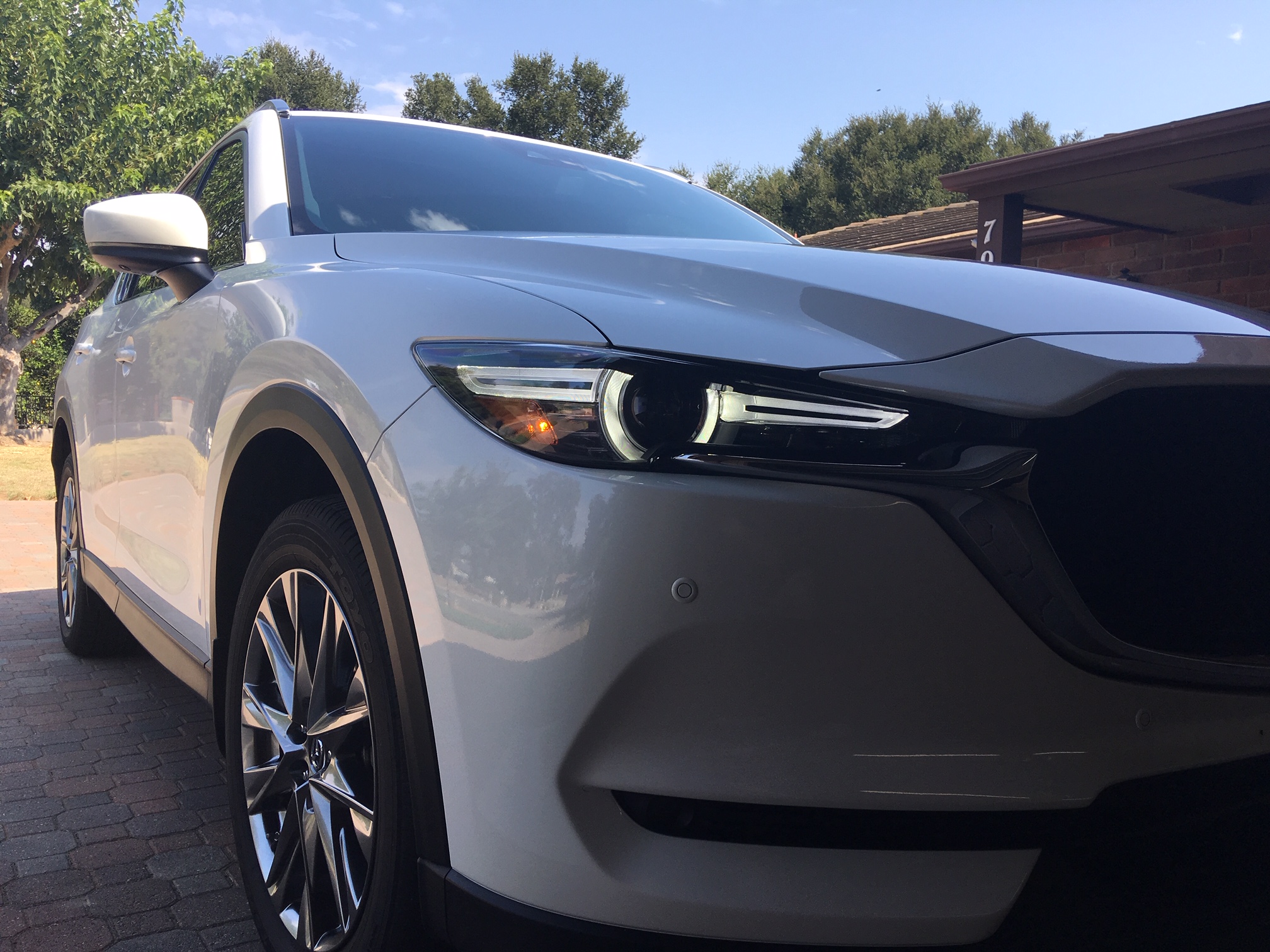

I don't know if this is possible on other trim levels but my Sig is set for just the halo effect while driving and no DRL. I performed the DRL disable procedure and then leave the switch stalk in the parking lamp position. The halos turn themselves off 30 seconds after I leave the vehicle so no chance of draining the battery.
Edit: This is a U.S. spec vehicle.
I can confirm this as I do the same.
