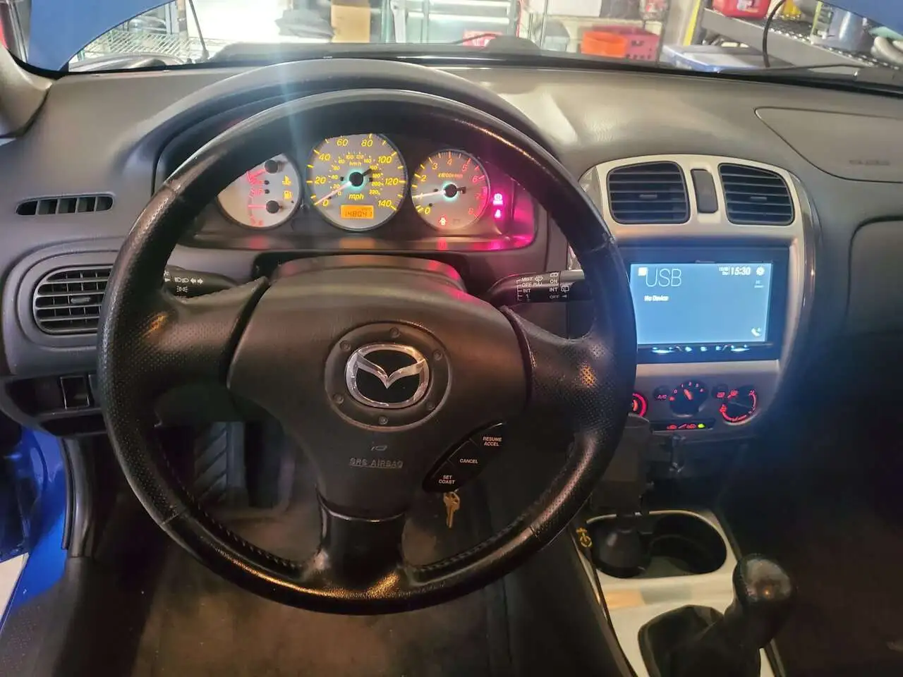

After a few months of contemplating what I should get to daily and mess around with, I finally settled on a P5. Searching the internet led to only a small array of them for sale around the country, and I settled on this one in the Tacoma, WA area. One owner since 2003 and only 145K on the clock when I purchased in June this year. Since then, I have been slowly working on wear and tear issues and starting some modification. Front catalytic converter needed to be replaced along with fuel pressure regulator and vacuum solenoid for the VCTS, but otherwise, car has been running really good for 20 years old. I replaced the destroyed foglights with aftermarket LEDs, have changed plugs, wires, as well as dash lights to LED. Also replaced the probably original trans fluid with Motocraft XT-M5-QS (huge difference is shift smothness!) The touch screen, Android Auto head unit was already in place along with upgraded sound system from the factory (A- pillar tweeters and spare tire sub in back). New belts, Wipers and headlight bulbs, along with tint and a backup cam, round out things so far.

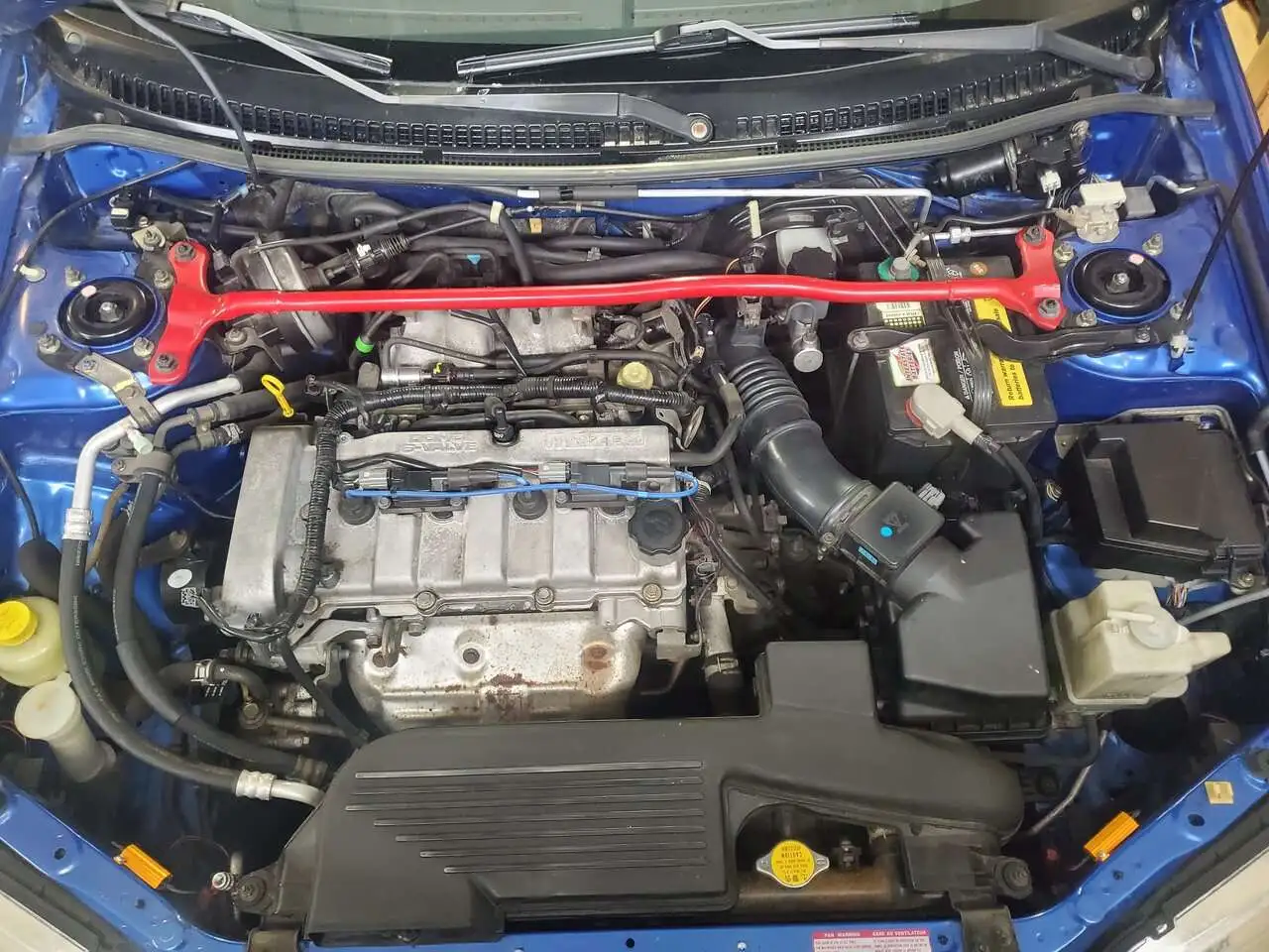

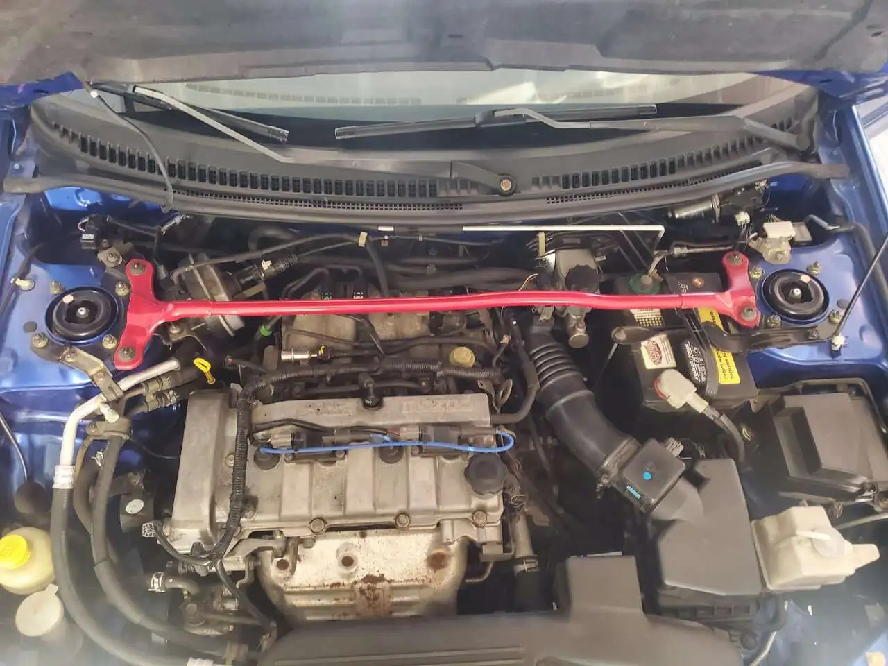

Installed switchback LEDs in the front turn signals last weekend. Will get pictures soon. Also, something that may help others. I was cleaning the MAF and throttle body a month ago and when I had the intake tube off, I found it was split in two places in the accordion section. It wasn't apparent while in place, I only noticed it when I took it off. Engine was sucking extra air after the MAF and affecting MPGs. New one on Amazon was only $24 and matches OEM exactly. Check yours closely.

mine was split too! i got some pieces of home depot rubber 90 degree elbows and toilet pipe. it’s a terrifying setup but it hasn’t failed me yet. duct tape goes a long ways.

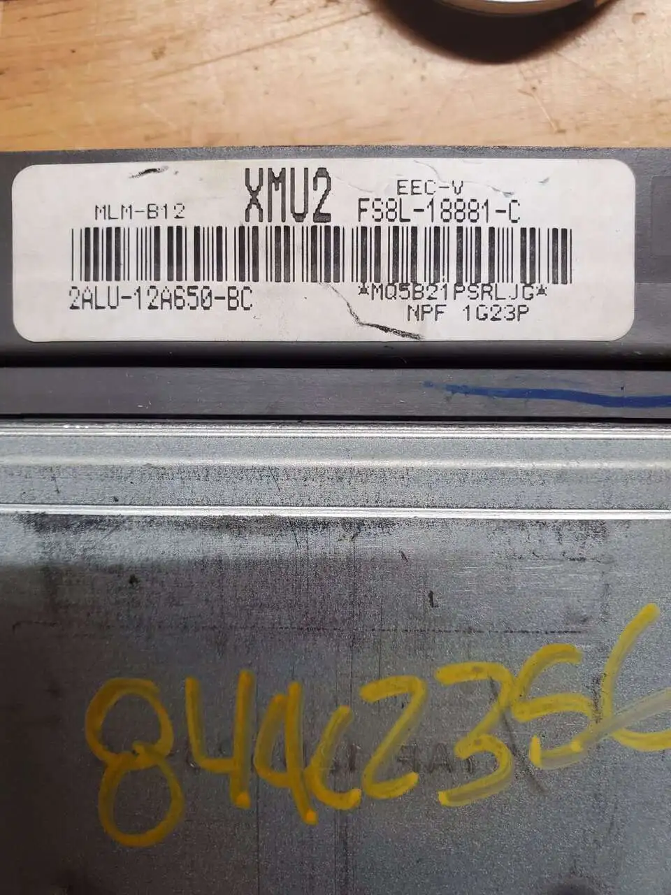

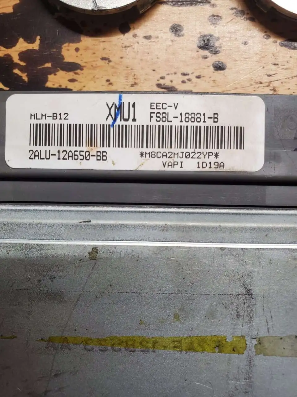

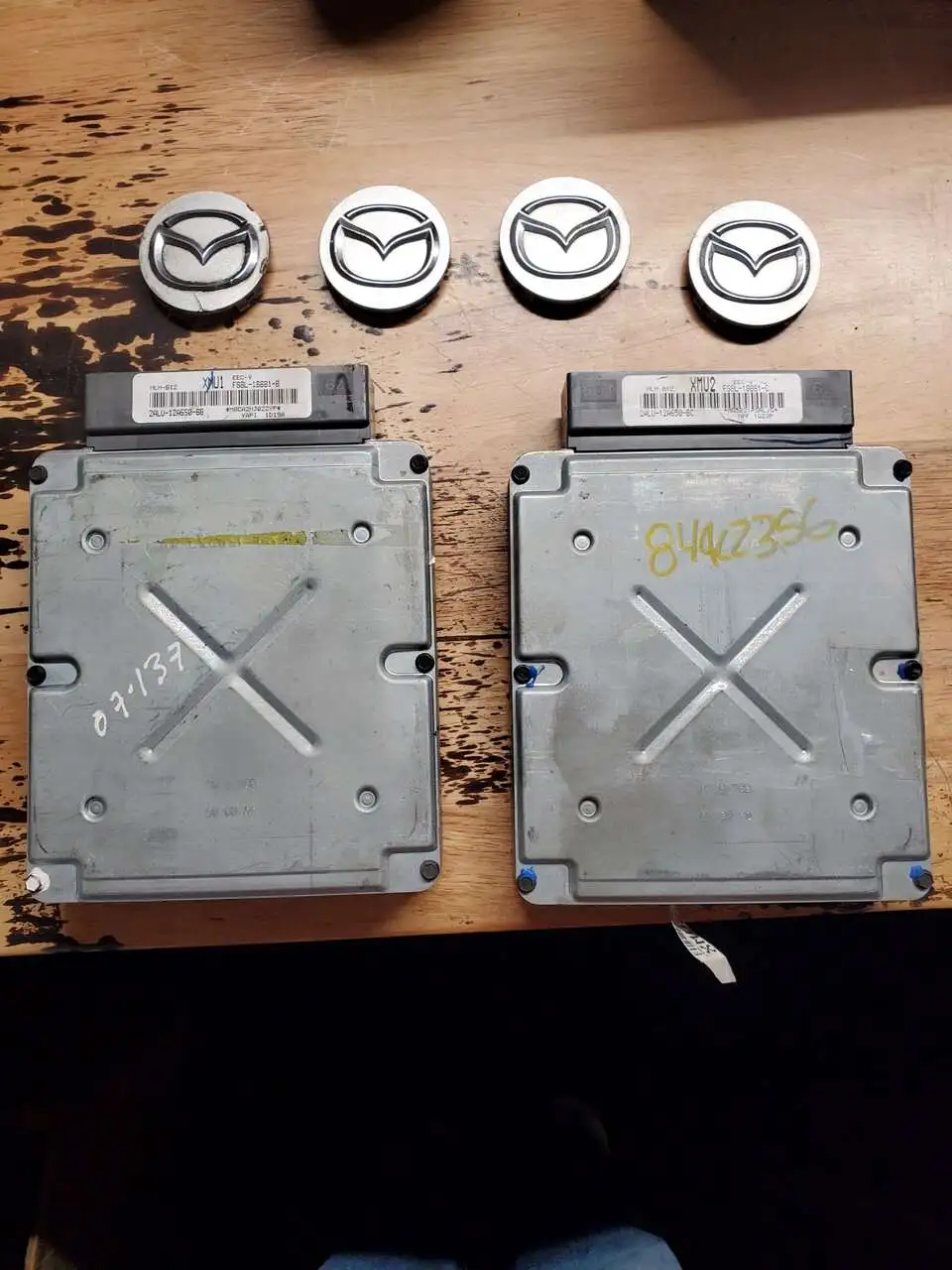

BTW, I have acquired 2 P5 ECUs. I don't know the specific year of each, so if someone can tell me how to decipher them, I can figure out their specifics and have them available for someone who may need them. Also, if anyone is looking, I have 4 center caps. 3 are really good, 1 is marred up a little.

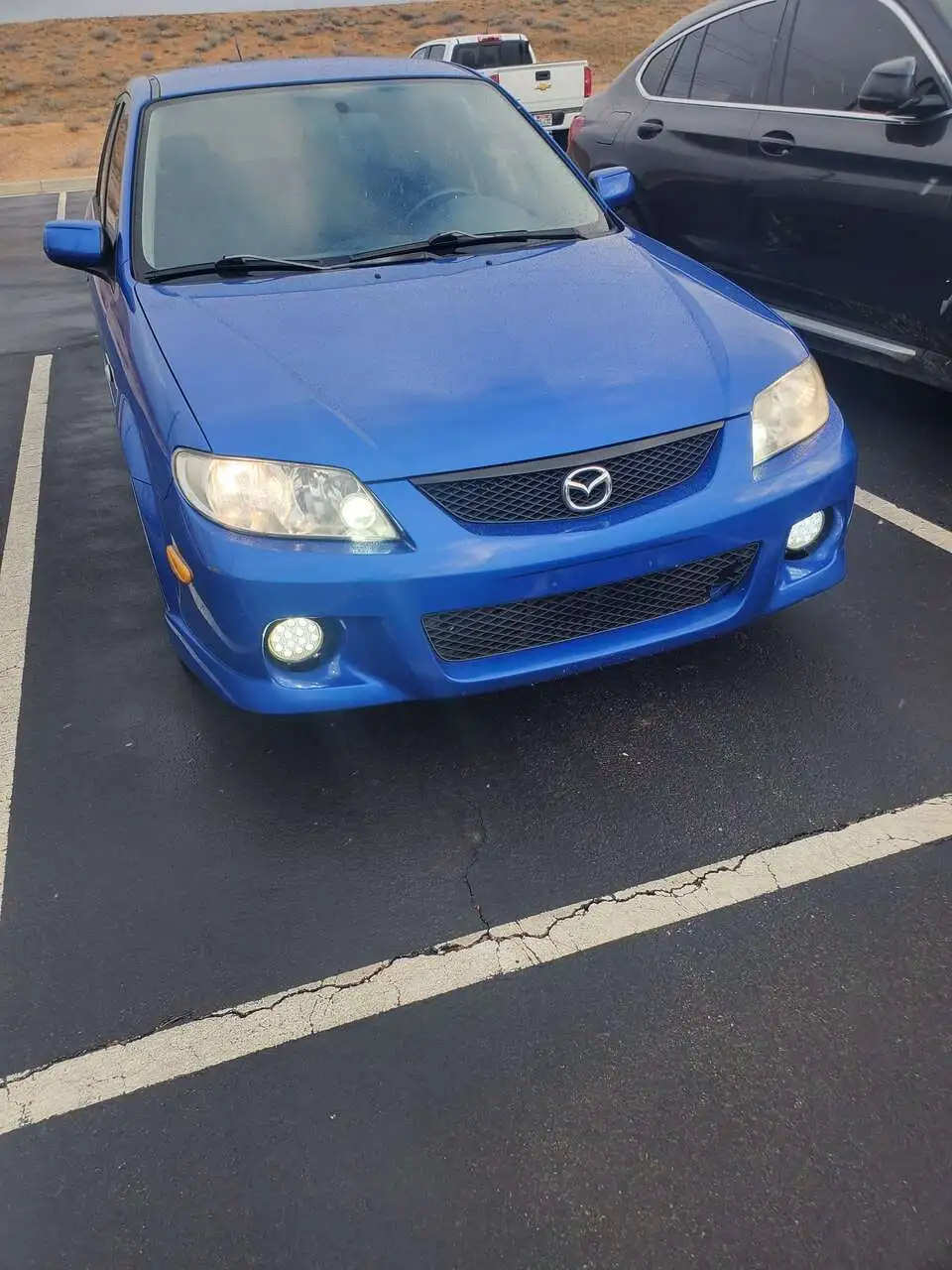

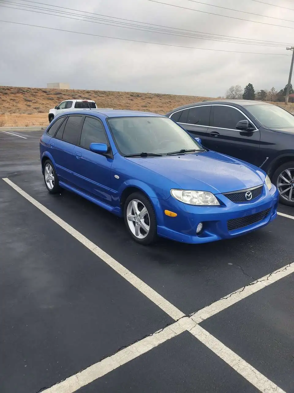

Besides a few dings and some deteriorating clearcoat, this thing is nearly 100% original, with 148,850 miles in it. The stereo has been swapped out for an Android Auto touchscreen Pioneer head unit, and the few things I have upgraded, but otherwise bone stock. I am actually only the 2nd owner of the car. Folks I got it from bought it in 2003. This is the day I got home driving it from Tacoma.

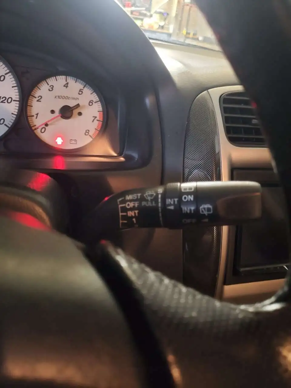

Next upgrade finished today. Very quick install of wiper stalk from 01 MPV to give my P5 variable intermittent wipers. 10 minutes and works perfect.

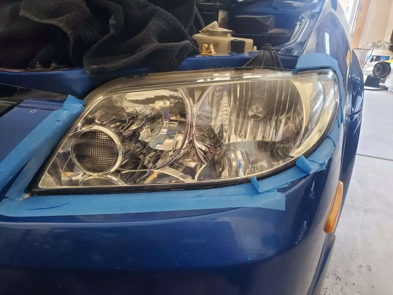

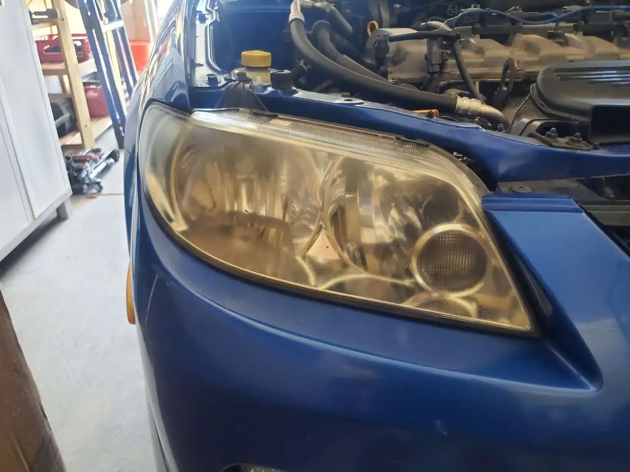

Did a little polishing on the headlights to see if they are salvageable. They look pretty good (see driver's side for after) , at least better than the before (passenger side). However, there are a bunch of little micro cracks in the lens that can't be sanded out. I used 1000 grit wet, followed by 3000 grit and then followed with my polisher. Will eventually have to get new headlight assemblies though. Also put a load resistor on brake light circuit to get Cruise Control working again.

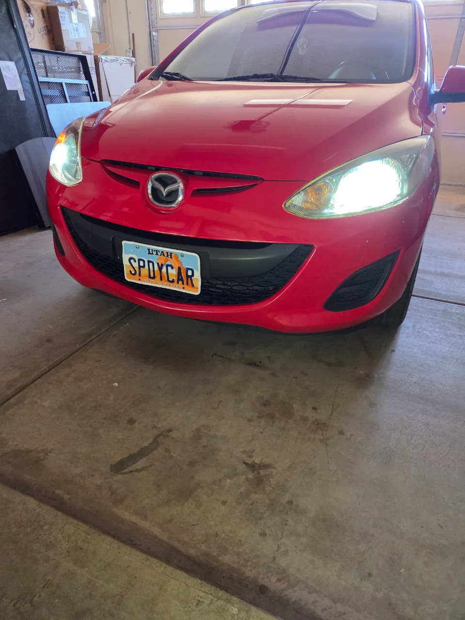

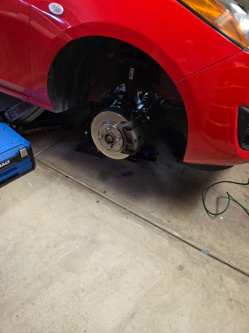

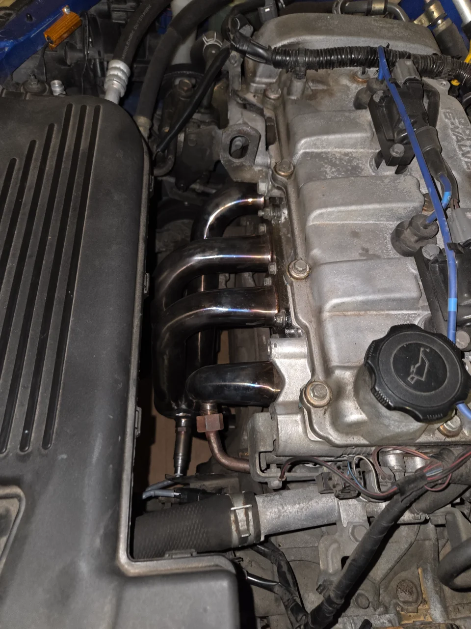

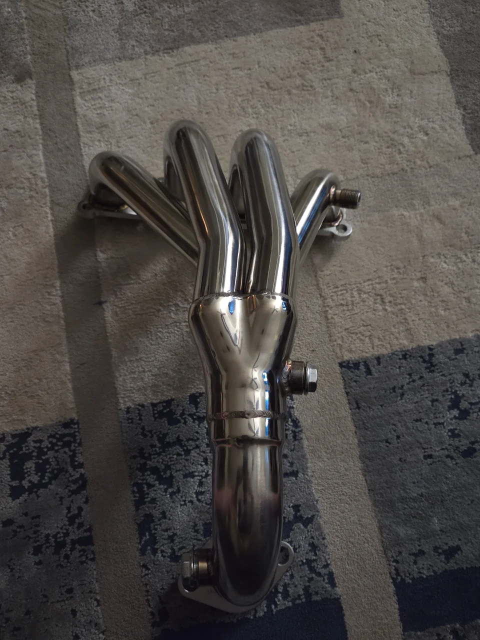

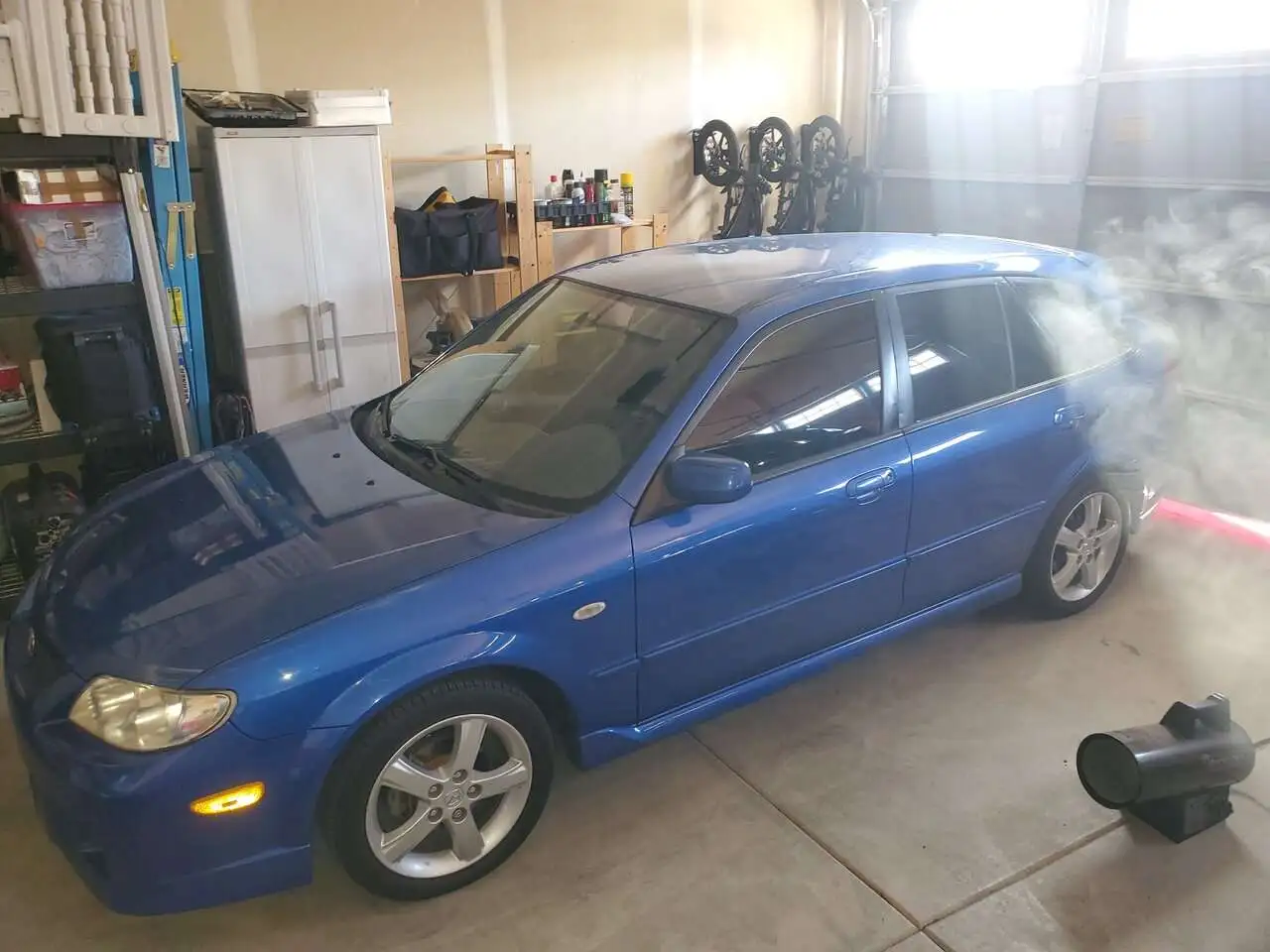

Been a while since I posted because it has been a whirlwind several months. I no longer live in northern Utah, having moved to very southern Arizona, right near the Mexico border. The P5 certainly likes the drier weather and I have a nice air conditioned garage to work on it in. Last upgrade finished a few weeks ago; putting headers on to begin the exhaust system upgrade. Also been working on my daughter's Mazda 2, with new front brakes and LED headlight bulbs

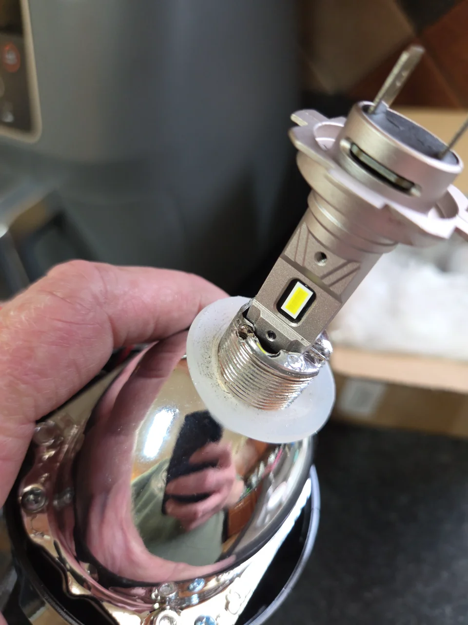

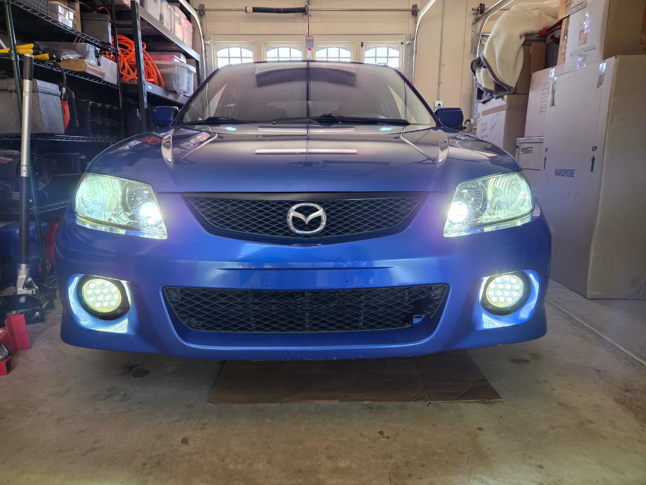

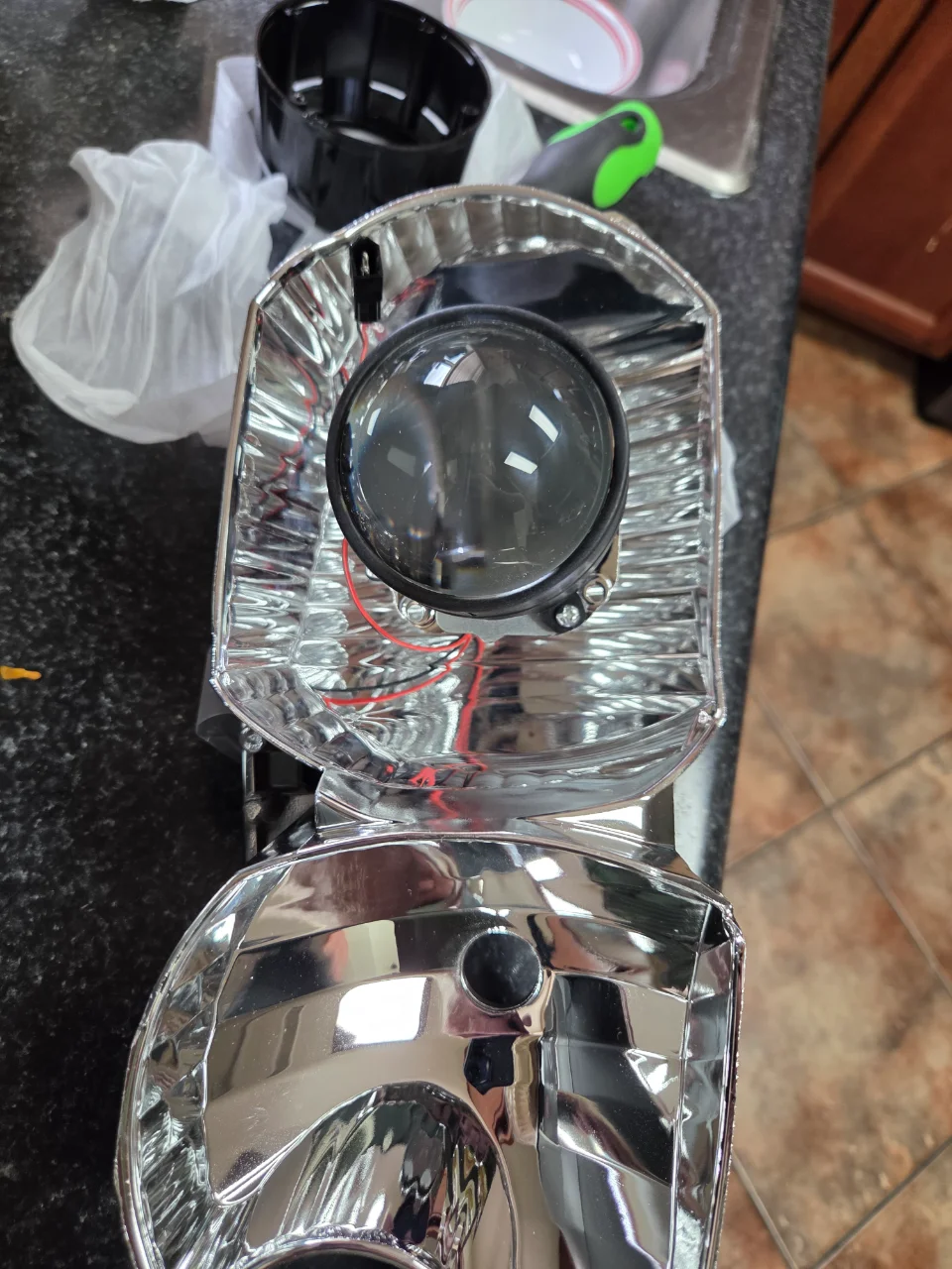

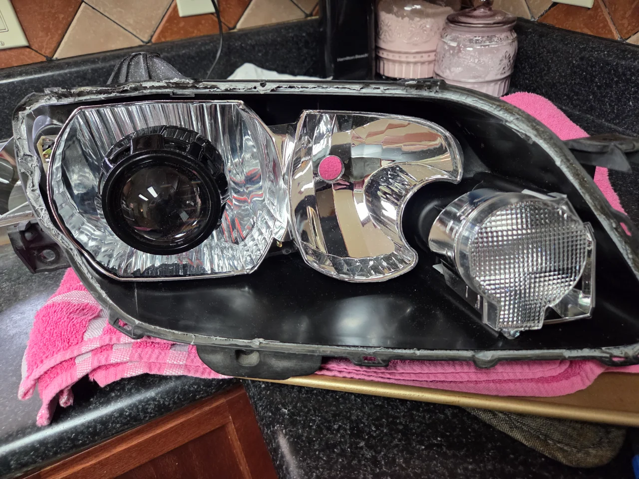

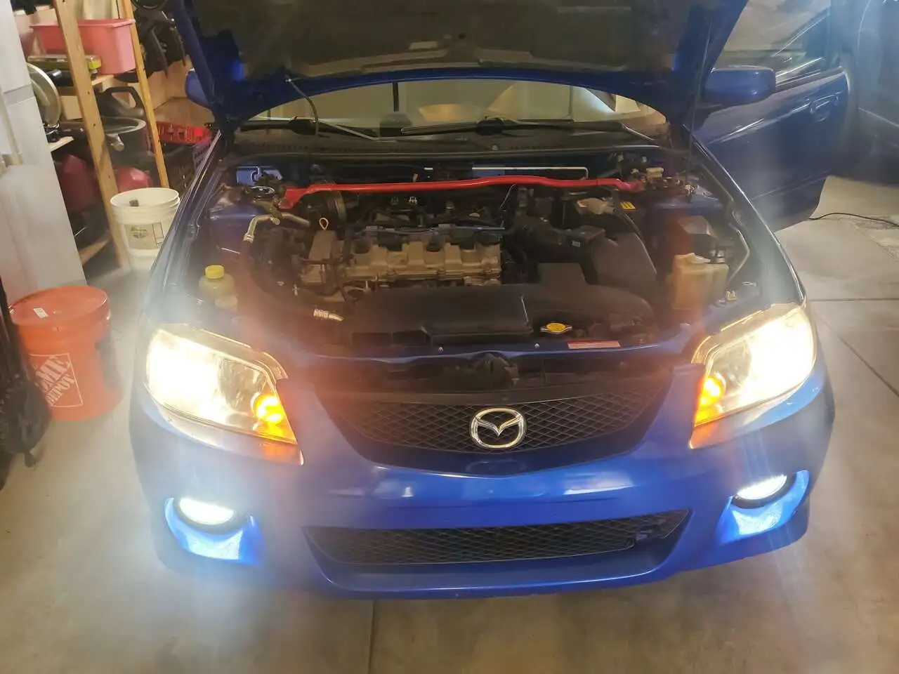

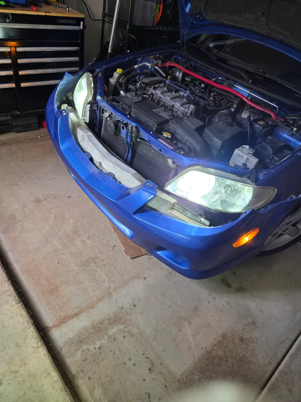

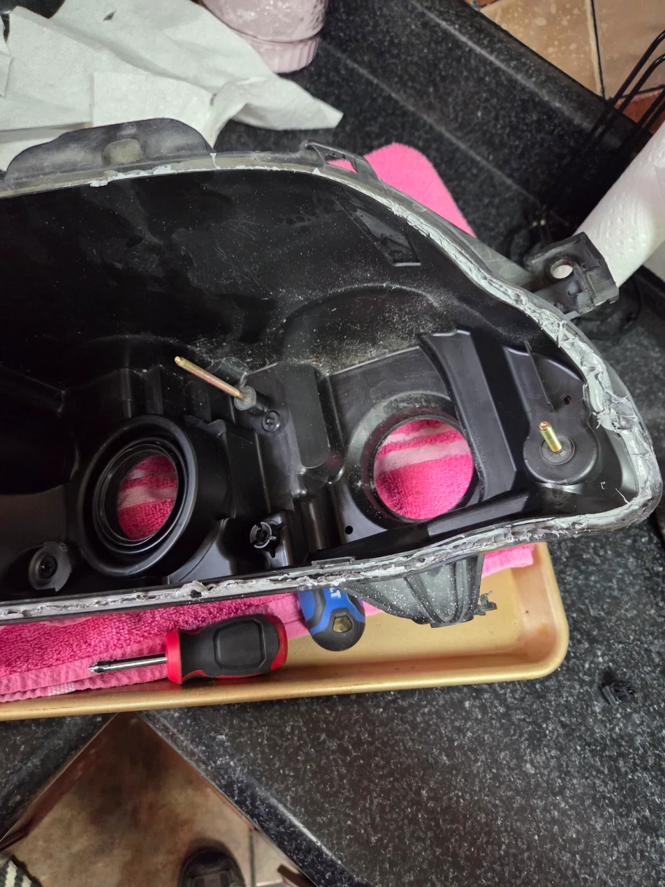

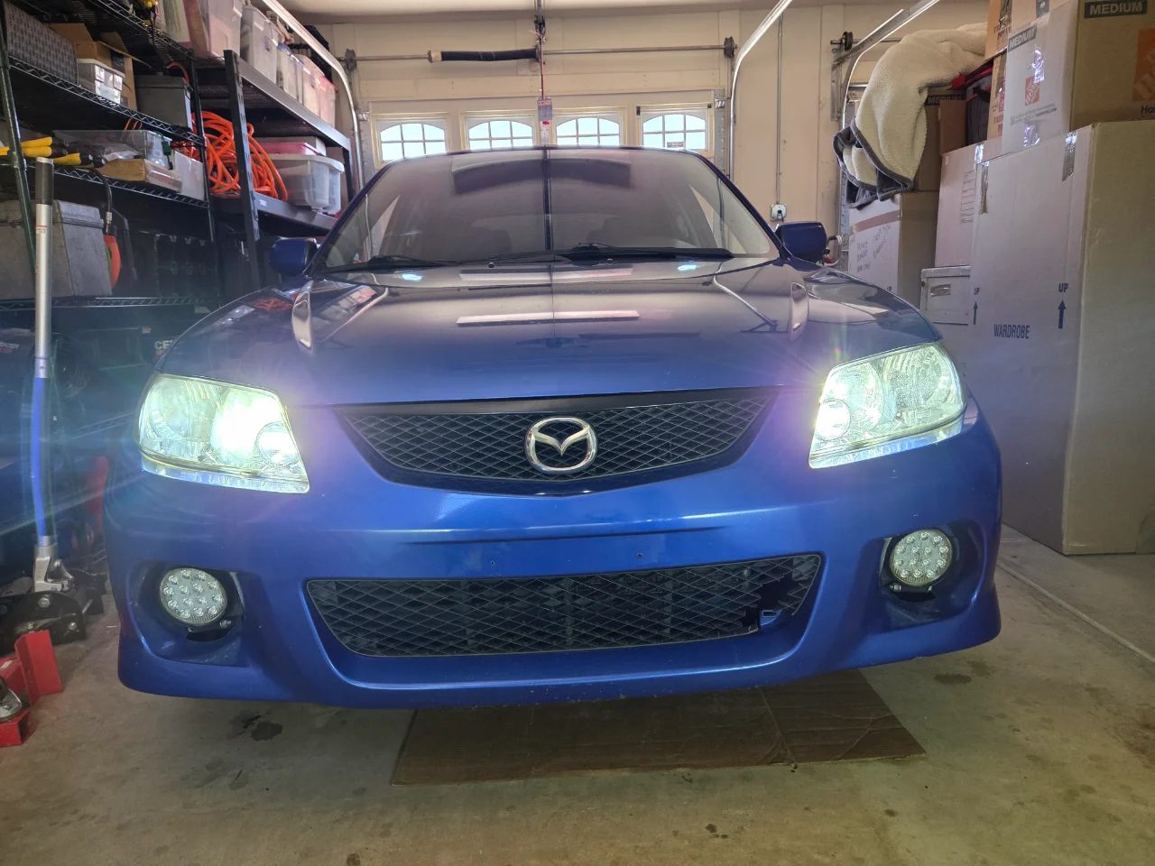

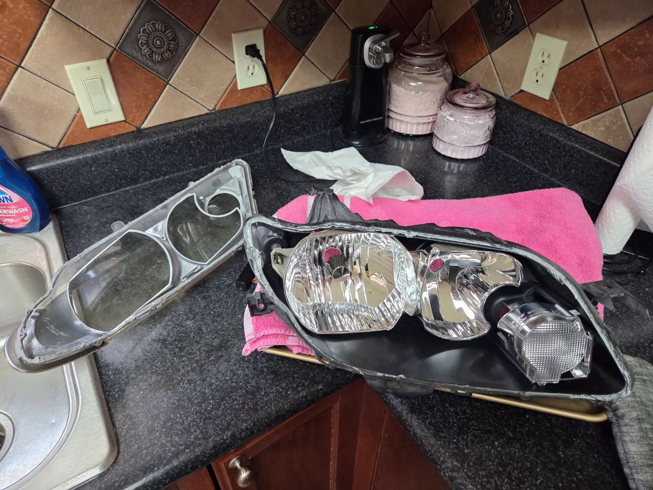

Just finished putting LED low and high beam bulbs in. Did buy a projector beam retrofit kit, and everything was going great until it wasn't. I got the lens off one side without much issue, installed the projector beam kit and started putting it all back together. That is when I realized that despite the description online, this kit only accepted H1 HID size bulbs. My new H7 LED bulbs would not fit. So, took kit back out, baked the lens back on and simply installed the LED bulbs without the projector kit.

All lights on P5 are LED now
