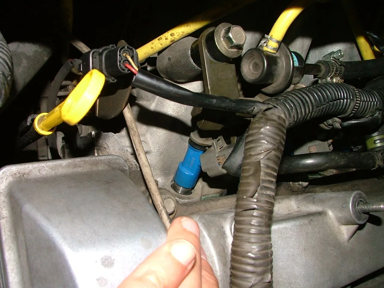

BTW, I forgot to mention in this thread that I am running the WRX 565cc (dark blue) inectors, and I couldn't be happier. No more ignition pop (with 20 PSI spike) when I turn the key on!!! The car also runs smoother.
He had some low impedance something or anothers. They would cause a nasty ignition pop when you turned the key to start the car. Hes running 565's now.
