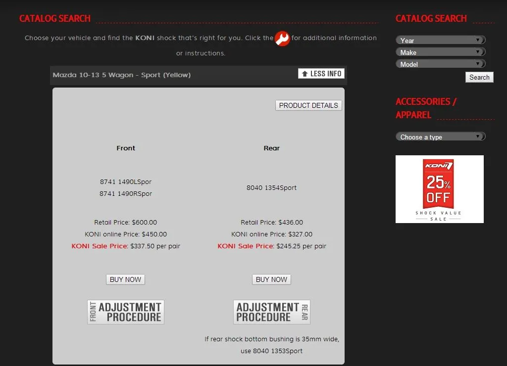

Koni-na has an Koni Sport application for the 2012+ (8040 1354Sport) but there is a fitment note. It says... "If rear shock bottom bushing is 35mm wide, use 8040 1353Sport" Anyone know which to order. The 05-09 Sport application list the 8040 1354Sport.

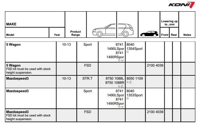

Ok now I'm confused... Koni says the FSD kit for the 2010+ MS3 is the same kit for the 2010+ M5. But for the Sport, it lists a different rear 8040 1354Sport for the M5 and 8040 1353Sport for the MS3.

Just did that. The only specifics that the Tech could give was that the 54 uses a 50mm rear shock bushing and the and the 53 is a 35mm bushing. Got to go measure I guess.
Ok. Measured my rear bushing. The 2012 uses a 50mm rear shock bushing. That means...
Koni Sport
front
8741-1490LSPORT
8741-1490RSPORT
rear
8040 1354Sport
FSD
2100 4045

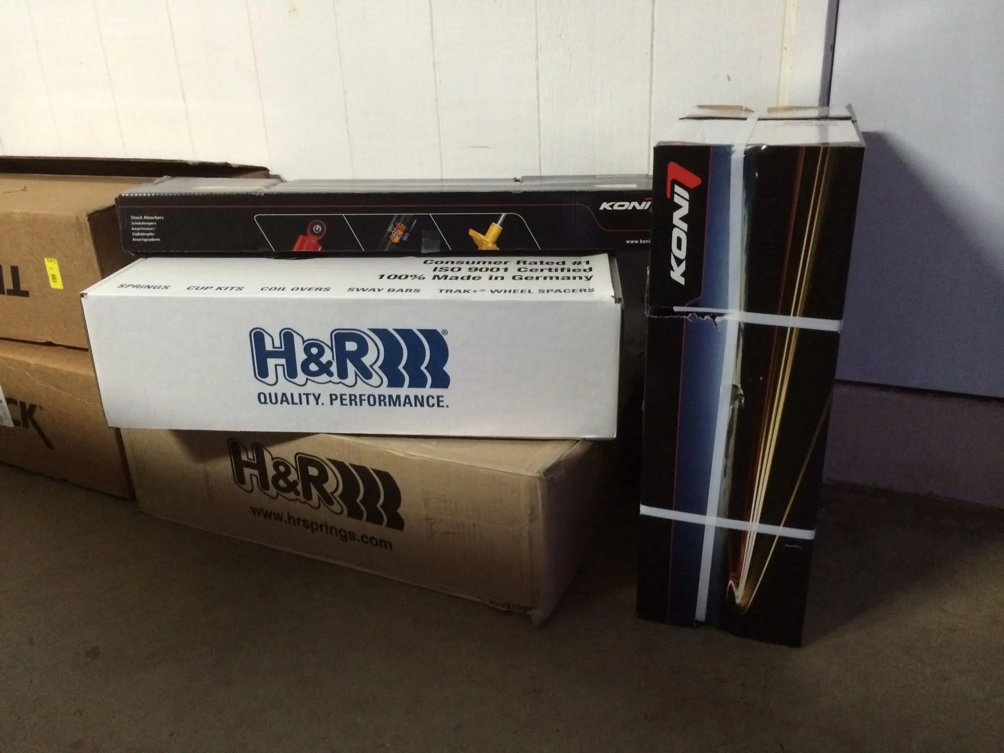

Ended up with Koni and H&R Sports. 8040-1354Sport is the correct fitment fir the rears. Installed and aligned over the long weekend. All 4 set to 1 complete turn from full soft. Rears are a PITA to adjust. Have to completely remove, compress and turn. Keeping the pressure on while turning.

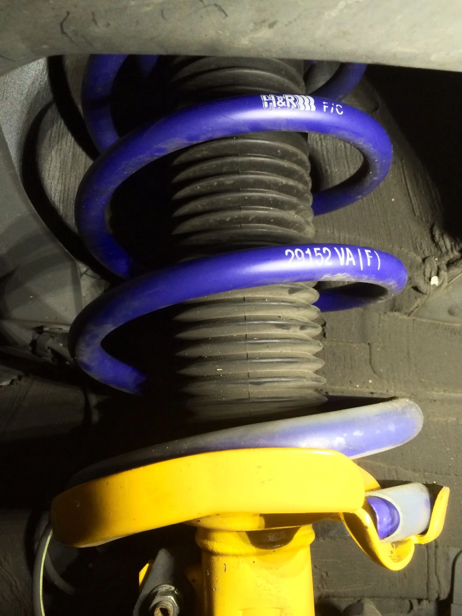

The front shock. I couldn't find information on the white cap that hold the oem dust boot so I just re-installed it. So far it seems OK although it does limit travel a bit.

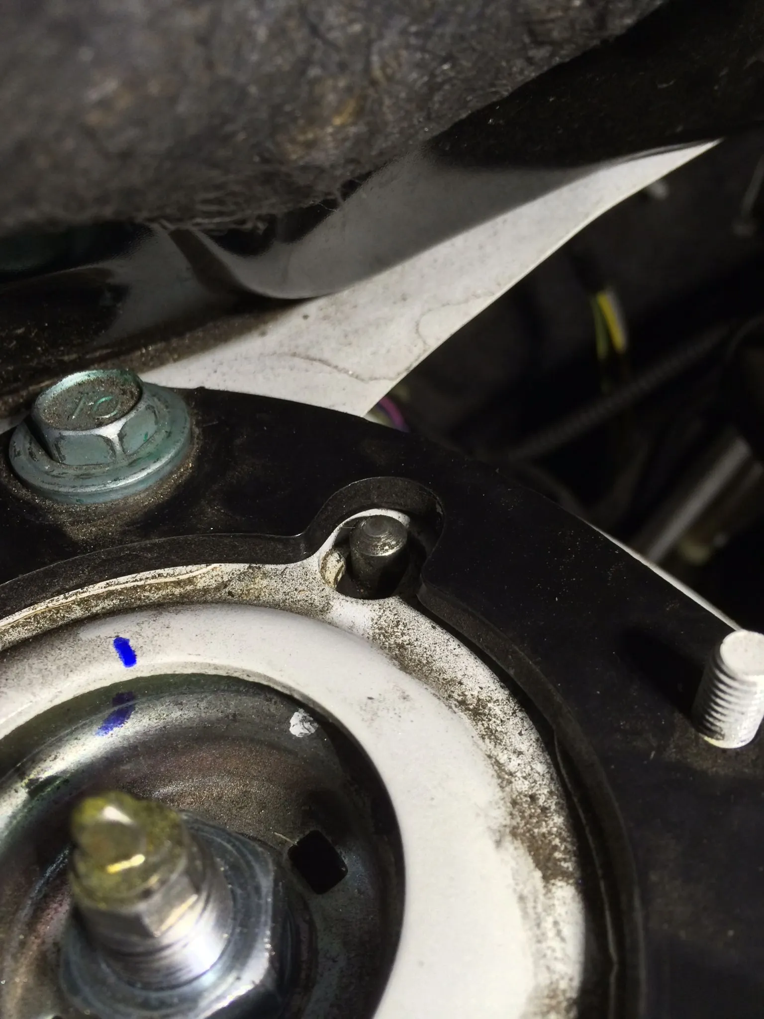

I've seen some post saying that our cars do not have ant front camber adjustments. I found that we do have a little bit of adjust-ability available. By loosening the 3 bolts that hold the strut one can move it inward (for more camber) or outward (for less camber). This has to be done with both front wheels on the ground. The little metal pin can help keep you in check so you don't mess up the caster settings as well. I set mine to the most negative to dial out as much understeer as possible. I would only adjust more positive if a rear camber kit were installed. Alignment was not too bad. Final setting were Front Camber L-1.7 R-1.7 Rear Camber L-2.3 R-2.4. All wheels toe'd in 0.06 to try and even out the tire wear.

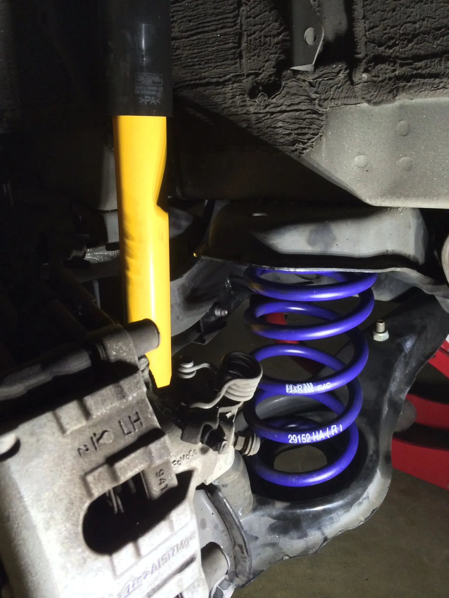

The rear Spring and Shock. The rear spring has both top and bottom positions. Be sure to pull out the top rubber seat and look for the notch. I sprayed a little silicone when reinstalling to make sure everything slid in correctly. The rear shock does sit on it's bump stop. I noticed this right away. Hopefully as the bump stop deteriorates the rear wont sag. I also noticed that it squeaks when the bump stop is compressed and expands pressing against the dust boot. Pull off the dust boot and put a little grease on the lip that holds it on.
