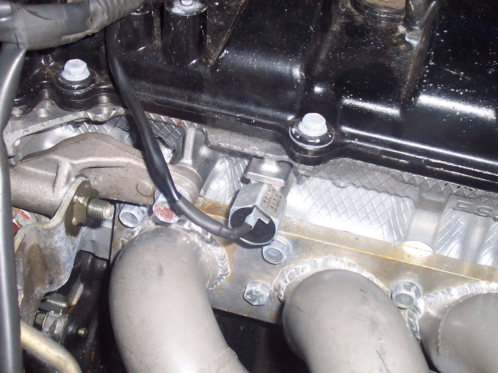

Alright, so a few months ago I had a new head put on.. and the shop that did it found that my knock sensor wires were pretty shoddy. So they replaced it. I got it from Advance and took it to them, but the wiring harness was a lot shorter than the one that was on the car already. Sooo.. the knock sensor is on the front of the block, above the exhaust mani, to the left. I didn't think anything of it until today when I crawled under my car to hook up my wideband O2 sensor, and looked up, to see a knock sensor still screwed into the back of my block with no wires coming out of it. Just curious to see if it is actually okay for it to be in the front of the block, or if it needs to be in the back, like the OEM one was. My car is still idling high, so I don't know if that would be the cause of it, but just curious.

Yup, I'll go out and take a pic right now. I tried driving today and got three codes, P0300 (multiple misfire) was one of them, along with P0037 and P0480. I say "tried" because I didn't get far before my CEL started flashing. I think if they screwed this up, they probably didn't set my timing back right either. Sure doesn't feel like it.

Block - I was referring to the entire thing.. not the particular section of the engine (bottom end, head, etc.), I was trying to describe where it was located.. anyway, the pics are above.

Umm what the hell??? Who the hell would put the knock sensor there!?
There is no way in hell that's working correctly there! Your timing is throwing everything off with the knock sensor probably going crazy from the valvetrain noise! My J&S knock sensor is in the front but only about 5" up from the oil pan!
Exactly what I thought!! I'm getting multiple cylinder misfires like crazy, it's shaking all over, and it sounds like a lawn mower.. can barely get the car out of the driveway.. even after seafoaming it today. I'm going to try to get it back to the stock location, hopefully that will help it out.
I definitely will, thank you so much for your help!! :D That makes perfect sense though, because wouldn't the knock sensor make the ecu advance the timing depending on the knocks that it detects? And since it's way up near the valves, it would pick up tons more, rather than if it were in the lower/rear stock location it would only pick up the ones in that particular location, the ones that it's actually looking for, thus the reason the factory put it there to begin with.

The knock sensor should be on the bottom end because it listens to spark knock in your cylinders, being in the head will mess this up quite a lot I'd imagine. It could be mistaking the valve tick for spark knock which would make it go nuts!!
Also I'd double check the timing to make sure they did that right as timing a DOHC engine can be tricky when the cams don't want to stay in the right place. Sounds like mickey mouse worked on your car, so it wouldn't hurt.
It's not too hard, just pop off your valve cover, take out the spark plug in cylinder 1 and put one of those extendable magnets or something down there. Then crank the engine by hand til you see the piston is at top dead center. Once there just look at the cams to make sure the timing marks line up.
looking from the passenger side at the engine, the cam on the left should have an E and mark next to that and the right cam should have I and a mark next to that meeting in the middle. If the marks line up you're good, but if the letters are wrong thats not good haha because there is E and I on both cams just to make it right easy (Thanks mazda!)

I got as far as taking out the knock sensor, then searching for the old one, and realizing that the alternator bracket and the downpipe is blocking the way for unscrewing it. So I took a chance, and started my car without the knock sensor at all. The odd thing was that my CEL's weren't there. It did the same thing for a couple minutes (shaking), but then when I revved it up to 3K rpms, it evened out, then I took my foot off the gas and it dropped to about 1k and idled fine. There is still a knock sound, but that damn shaking is not there. I put my hand on the valve cover, and the cylinder (I think it's the 1st?) closest to the timing belt had more of a knock to it that I could feel. Going to take off the valve cover in a little while and check out the timing.
