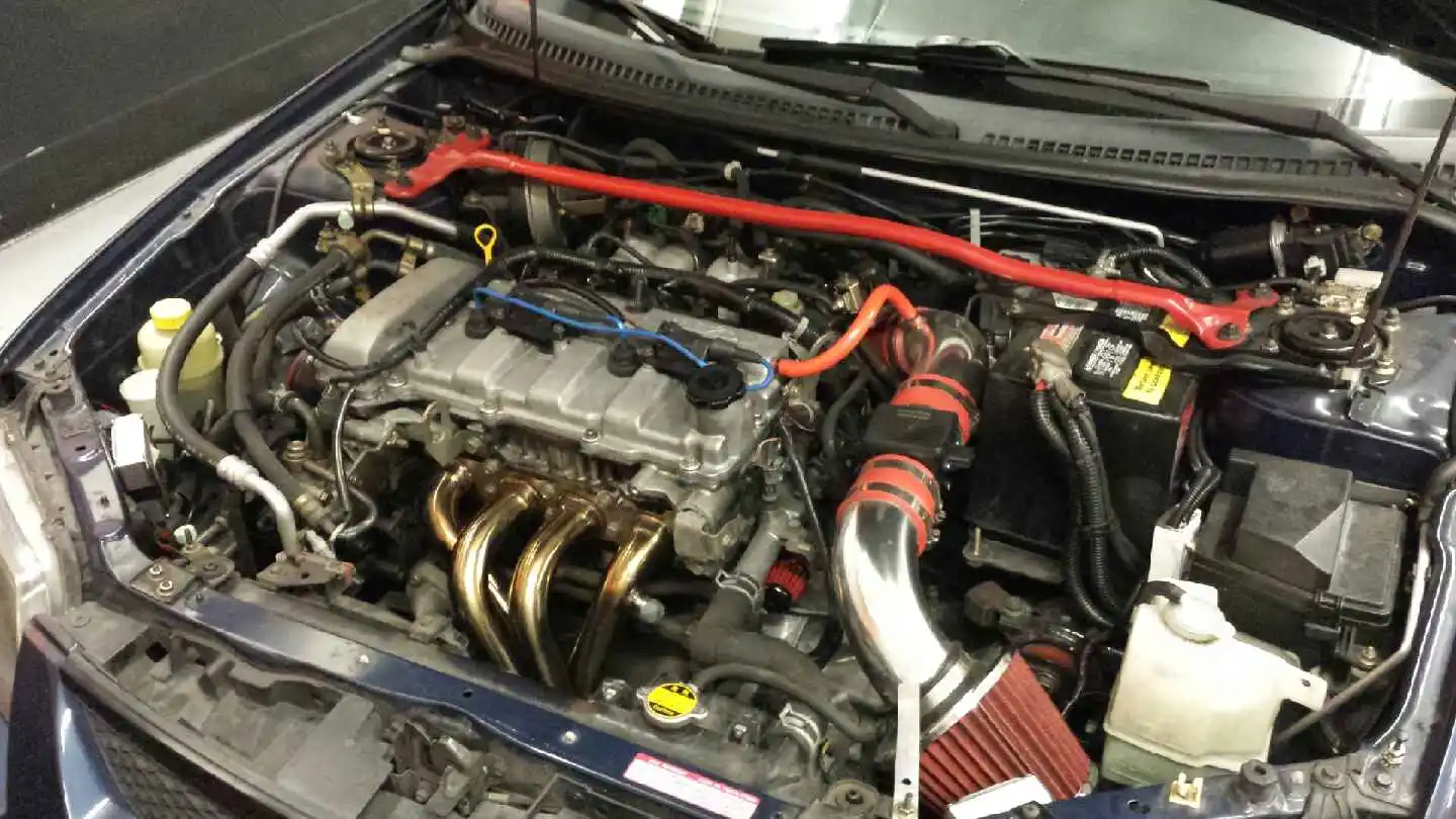

And Could you post a pic of how you have your MAF sitting ? If you get a chance, I want to compare it with mine, thanks for all your help

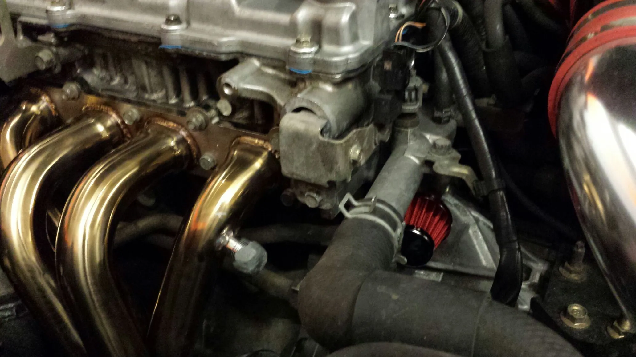

Well got the breather filter on egr cut pipe, works fine. Started off buy using some steel puddy to block off egr fitment, can see in picture, that failed and made the car smell like doodoo. Went to home depot and into plumbing section and found a large enough screw to cover the fitment. Still getting an annoying vibration which I've isolate to also be from this ebay header, where it meets the exhaust, is now rubbing the oil pan.....Tried putting a silicon coupler inbetween, that worked temporarily but must have came out cause vibration is back lol
ill post a pic later today of my maf, but it is nothing special it is mounted to the battery mount. i place the pipes to where they DO NOT tap on anything. i tried using a mount on my engine but the vibrations were wayy too hectic to i just put it back on the batt mount. i also have an ebay header and i also tried all tricks to get that egr pipe to fit but nope. i ended up clogging it with high heat putty, works great if you dont mind not having the valve... i have a breather and pipe cutter in the backseat lol... havent really wanted to do it i guess... how much of a difference does it make??

Yeah the puddy i used didn't work lol glad its working for ya though. Doesn't really make a difference at all to be honest but it looks nicer than having the pipe just sit there lol.

here is an old pic of my bay, i have a new MAF now, but it is still in the original place.
see that wire wrapped around my radiator hose? thats my o2 sensor, just hanging out. Some people say they can be an issue, its back in the pipe again, but it really didnt matter car acts the same.

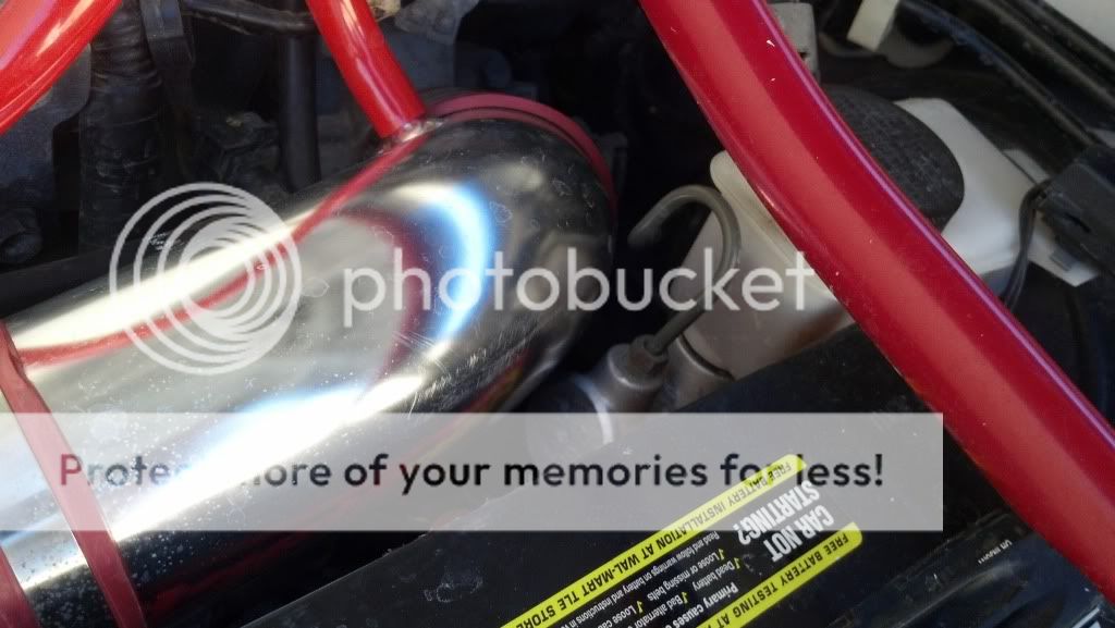

so i said what the hell and went and took pictures of it... here are some fresh pics...

cant really tell in the picture, but they are not even close to touching
