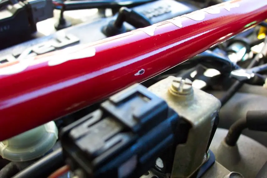

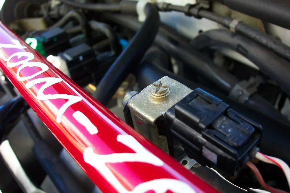

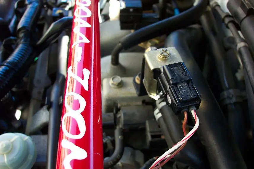

i found it! i think.....
i started my car and put it in reverse and it started vibrating. i put it back into park and it stopped so i popped the hood and started looking around. it turns out its the purge control valve vibrating against the strut bar. when installing the typhoon, it had to be relocated right behind the strut bar. i guess since dosle and i both have the obx header, the vibration is just enough to make pcv touch the strut bar.
i will try to post pics tomorrow of the red paint on the side of the pcv and the spot on the strut bar where the paint has rubbed off. also, i will adjust it and see if it still happens and let everyone know if this was the cause of the vibration.
I don't have a header yet I have the same problem....... I think you're right though, the PCV is pretty damn close to the strut bar and that's where the noise sounds like it's originating.
check the back of the strut bar to see if paint is missing because mine is and the paint is on the pcv
If your not positive that's the problem(and you have an A/T), pull the parking brake when you have it in reverse, and get out and check it? Or do you have to be moving?
i have the header yes. the noise always seems to be coming from dash level inside or outside right below the hood. jose it may take some time to get the same noise i have now, when i first installed it after about 2 months it started making that noise.
matt, i think its the same noise. only mine started about 5 days after the install. my vibration sounds like its comin from right behind the top of the dash. i didnt drive today, so i'll do the park brake tomorrow and see if its it. i will also post pics of the paint that was scraped off.
vibration fixed
the pcv hitting the strut bar was the source of the vibration. i moved the pcv and the vibration disappeared.
the first 2 photos show the paint from the strut bar on the side of the pcv. the 3rd photo hows why it vibrates. i put the car in r3everse and put the park brake on and discovered that they actually touch when the car is in reverse. the fourth pic shows that i moved the pcv to the bolt that is further away from the strut bar. the pic shows the car in reverse and they arent even close to touching.
i hope this helps to solve everyones vibration problems (2thumbs)
