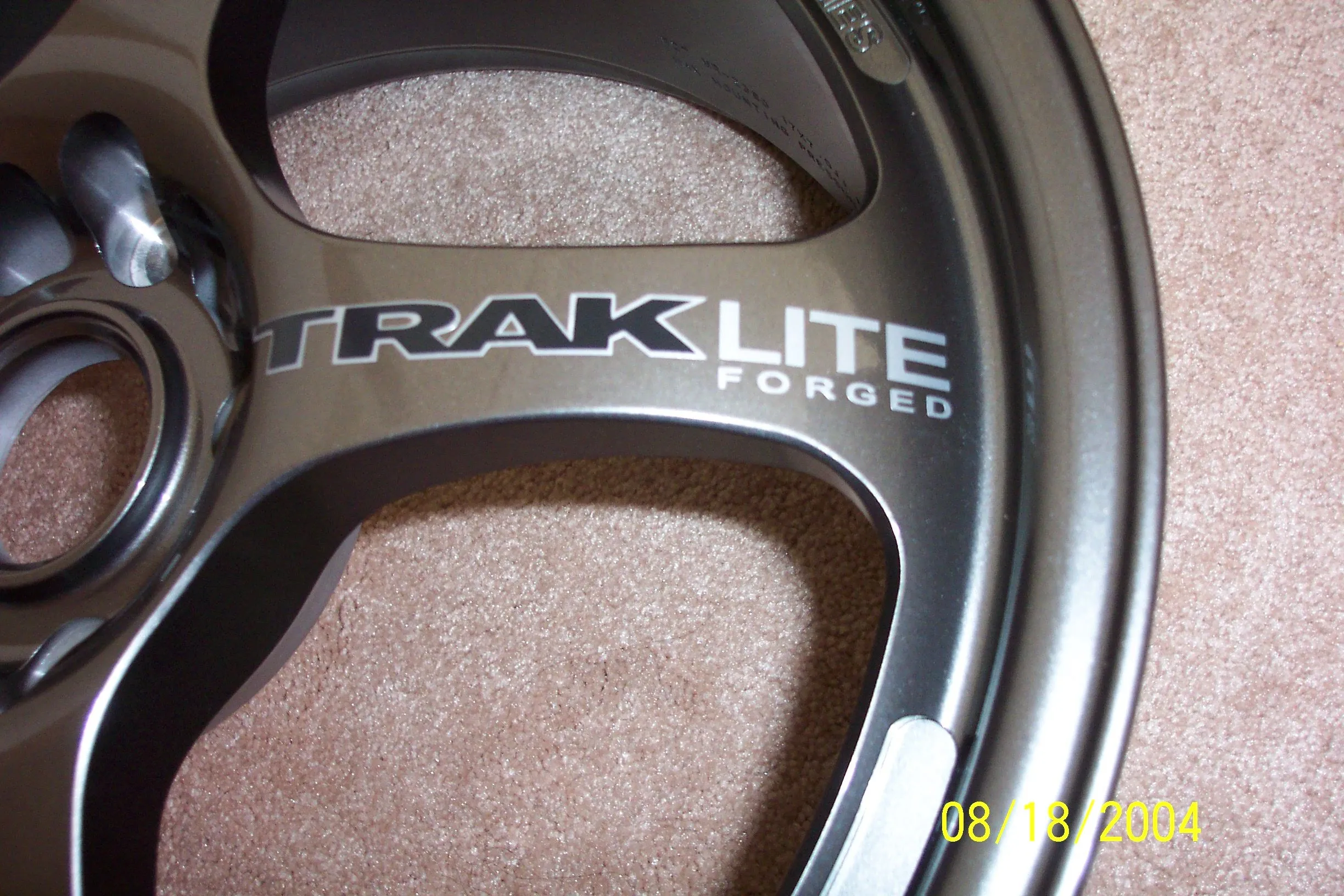

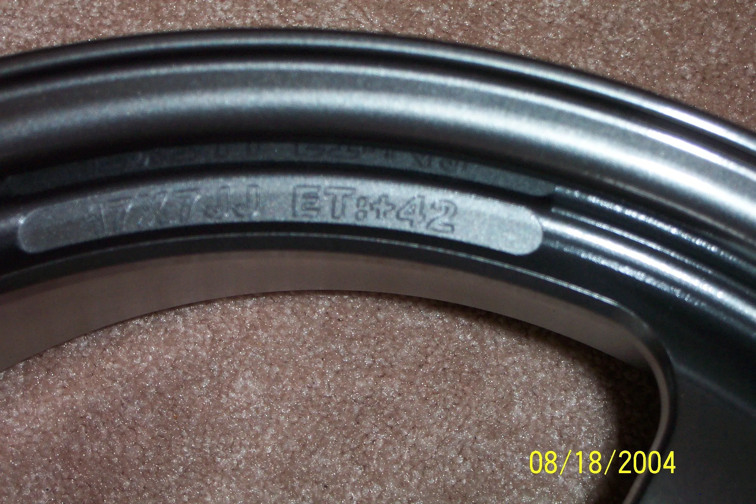

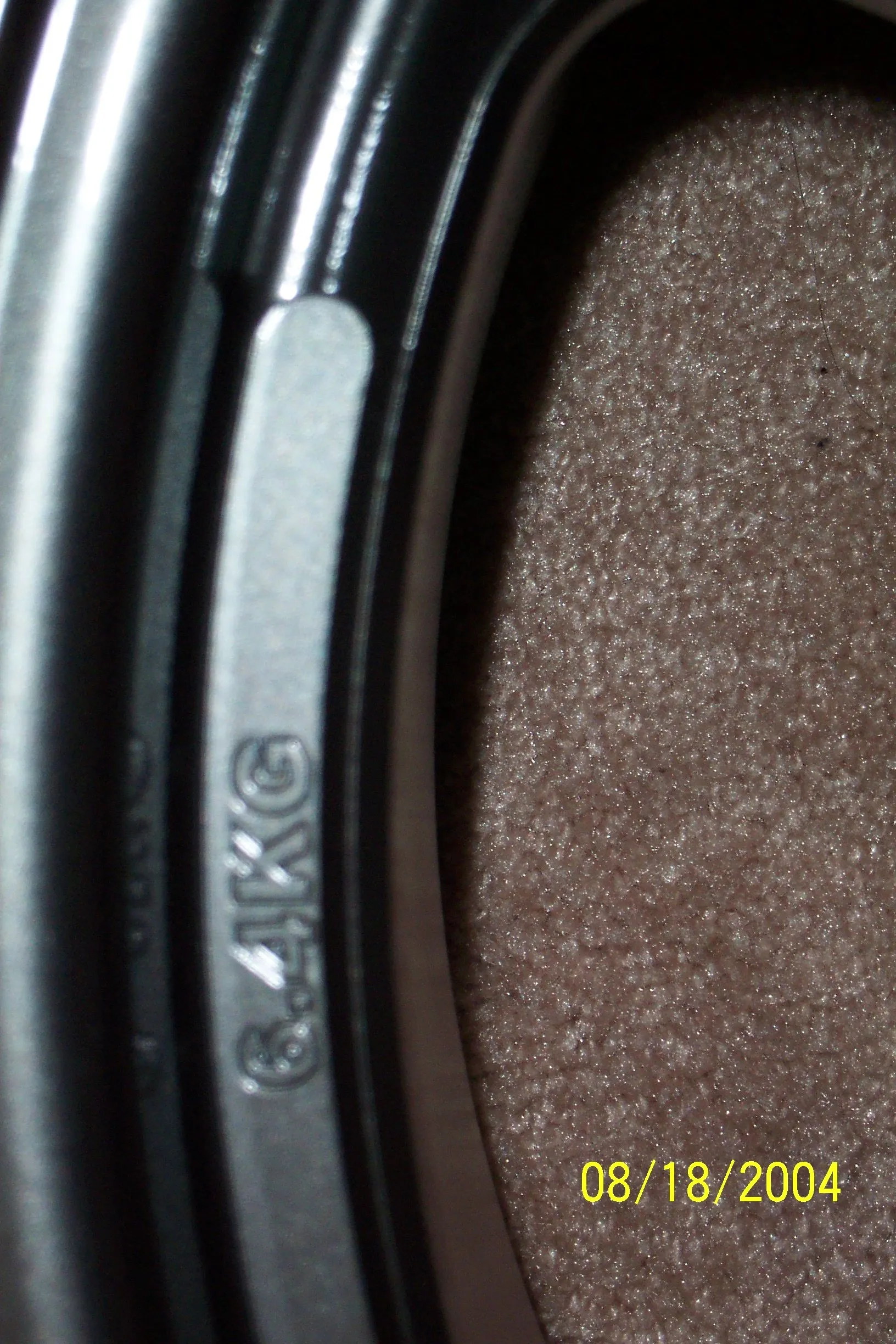

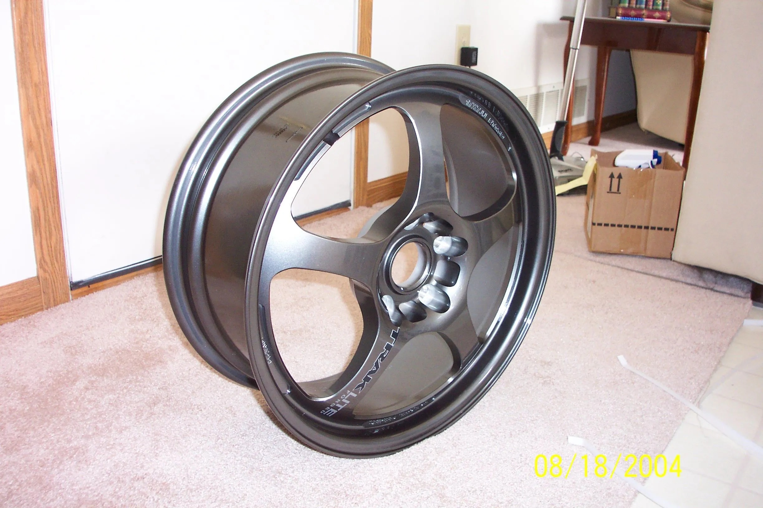

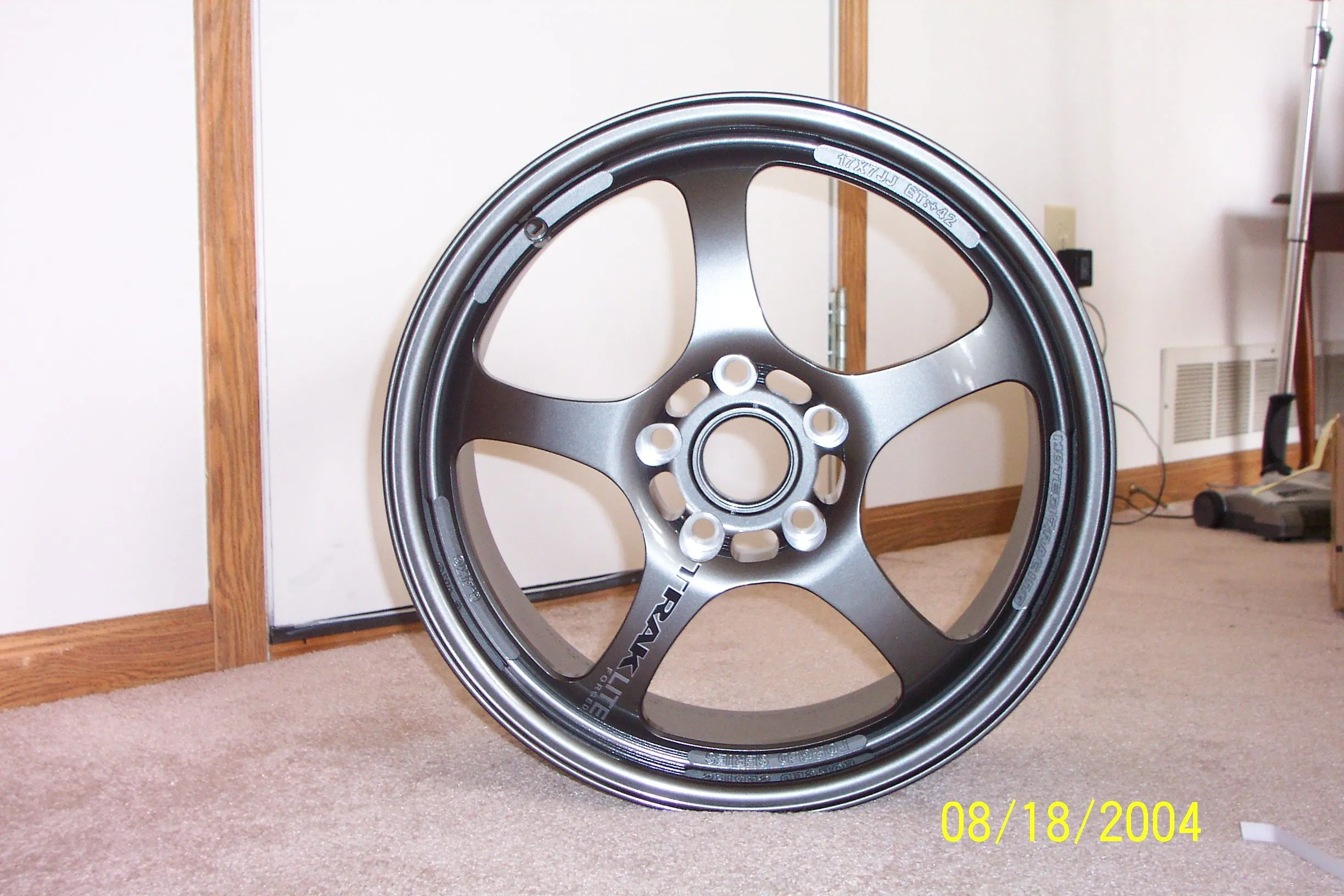

I just recieved my new Motegi TrakLite wheels in gunmetal. I bought them in 17x7, 42mm offset (so they should fit...... knock on wood). I plan on transferring my stock tires to my new wheels and fitting snow tires to my stock wheels..... but I've run into a snag.... I have the tire pressure monitoring system on my car. Correct me if I'm wrong, but I think the actual sensors are attached to the wheel valve stem. Does anybody know the part #? I want to have the sensors installed on my new wheels so I've been bombarding my local dealers with parts inquires (as usual, they've been giving BS about "only genuine Mazda wheels can have those equipped"). Oh yeah, I'm replacing the stock wheel locks with Muteki spline drive lugs (McGard sucks, I had a couple of them strip on my old Mazdaspeed). I've posted some pics below.

14.1 lbs. Nice! I hate 5-spokes but you can't argue with that weight.

P.S. nice looking wheel, only thing I dislike is the track-lite sticker on the spoke.
Those are sick beautiful mags, enjoy them, whatever you paid for them, they are worth the money.
I paid a little under $900 for the wheels... kinda expensive but I wanted 5-spoke forged wheels and the price was a bargain compared to $2000 for a set of volk wheels. By the way, if you are looking into Volk wheels, try Rishie, he's a forum member (runs AutoR&D) and some protege owners got good deals from him. Also try AXRonline.com. Pretty decent prices for Volks there. By the way, I found my Motegis on Ebay (just happened to be at the right place and right time).
Please tell me you took the sticker off!!!
Takes away from the total look of the wheel (protest)
How do I remove the TrakLite decals from the spokes???.... Oh yeah, I just recieved my spline-drive lugs today, hopefully I'll have the wheels installed next weeks with pics.
