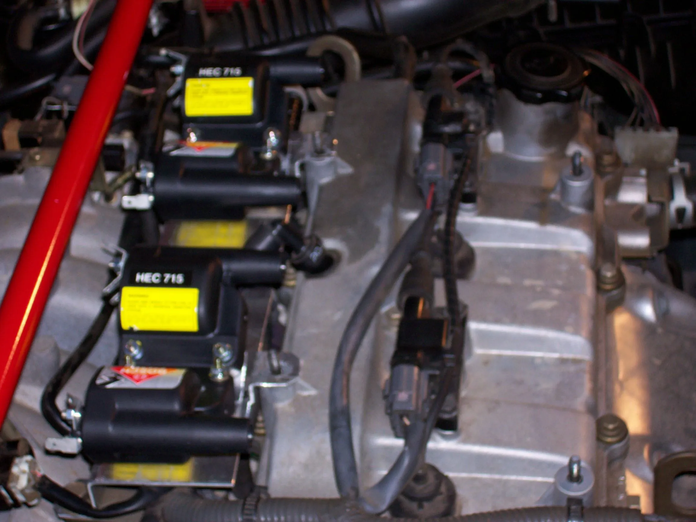

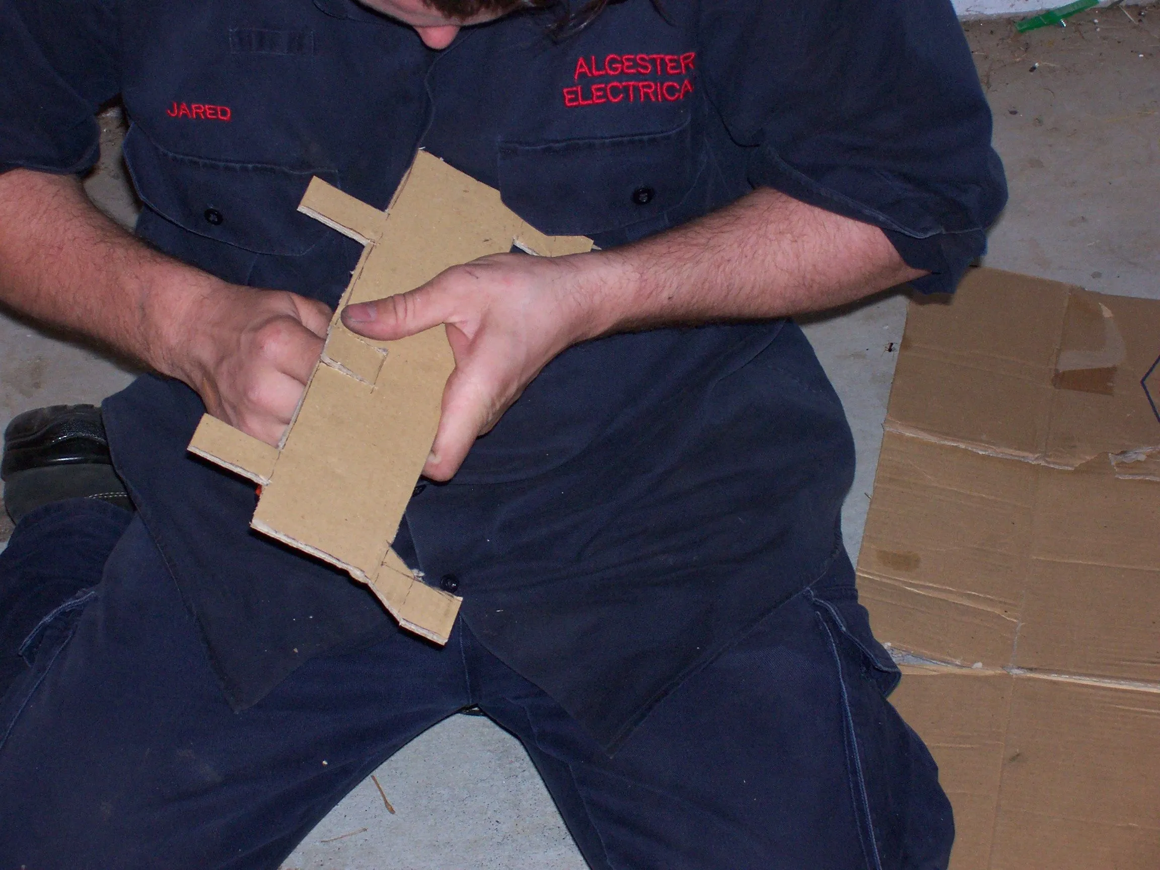

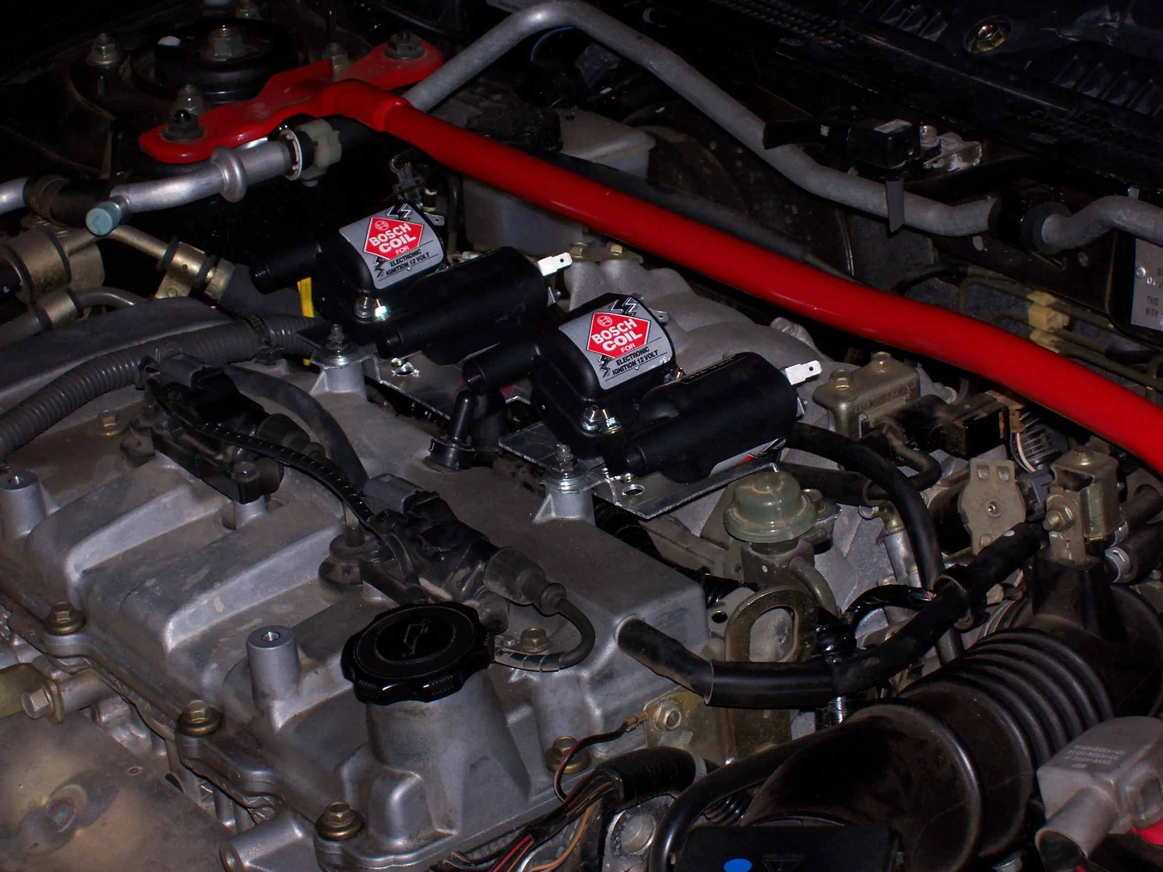

Ok first 4 pics!!!!
Pic number 1: my mate working out the template for the coil pack bracket out of cardboard - we made about 3 cardboard prototypes to get the shape just right then cut it out of 2mm aluminium.
pic number 2: aluminium bracket test fit. Brackets were riveted to this to hold the coil packs in place
pic number 3 and 4, test fit with coil packs. Once we got this on the car we found some limitations in the design. basically it broke, and the coil packs rocked around enough to shake a few rivets loose. I'm getting a 3mm aluminium bracket laser cut which will include the brackets bent up out of the same piece of metal for more strength (no rivets), and then some retainers on top of the coil packs to stop them moving around. Right now its all held down with a ridiculous amount of cable ties....ghetto, but it works!

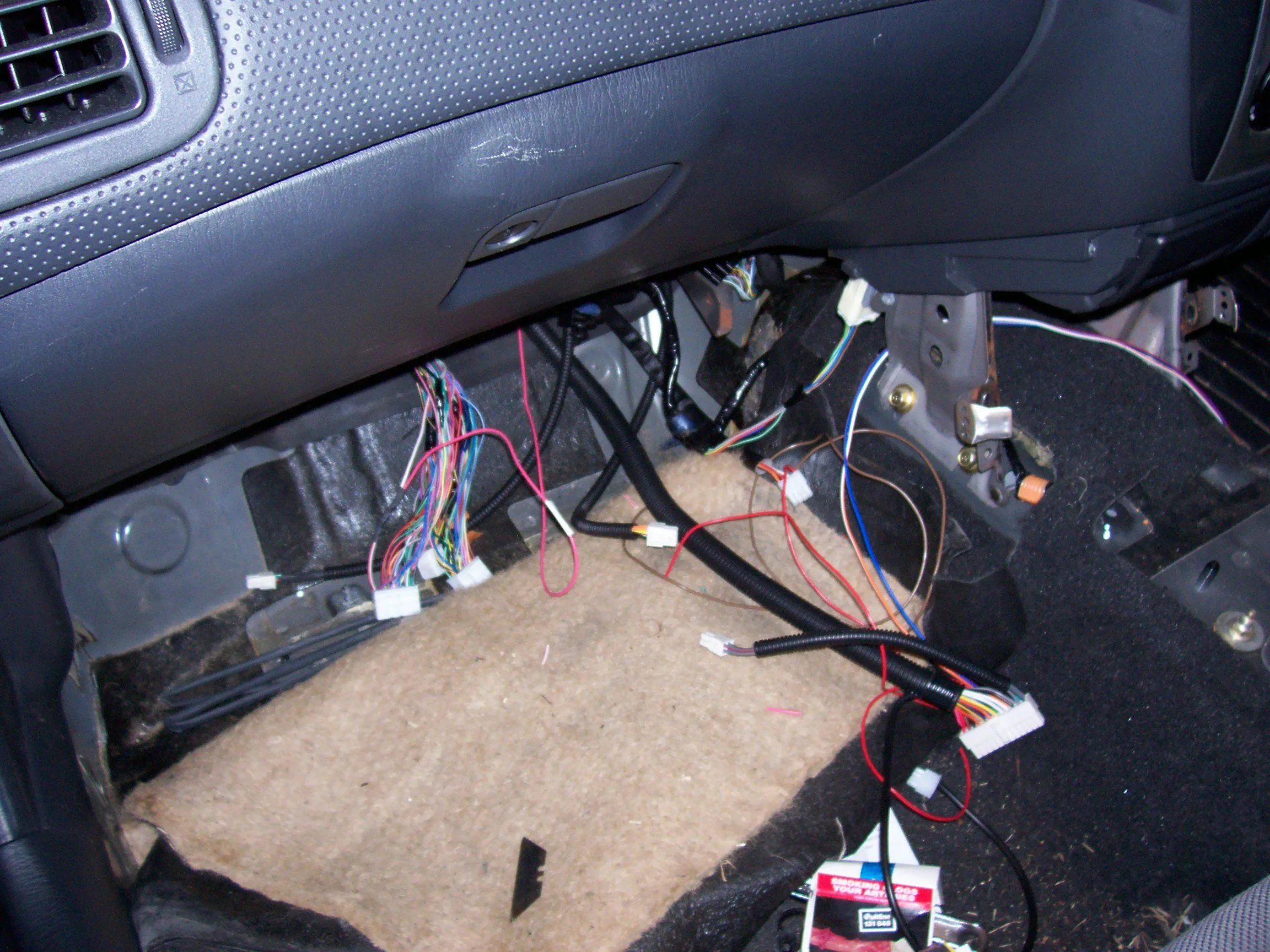

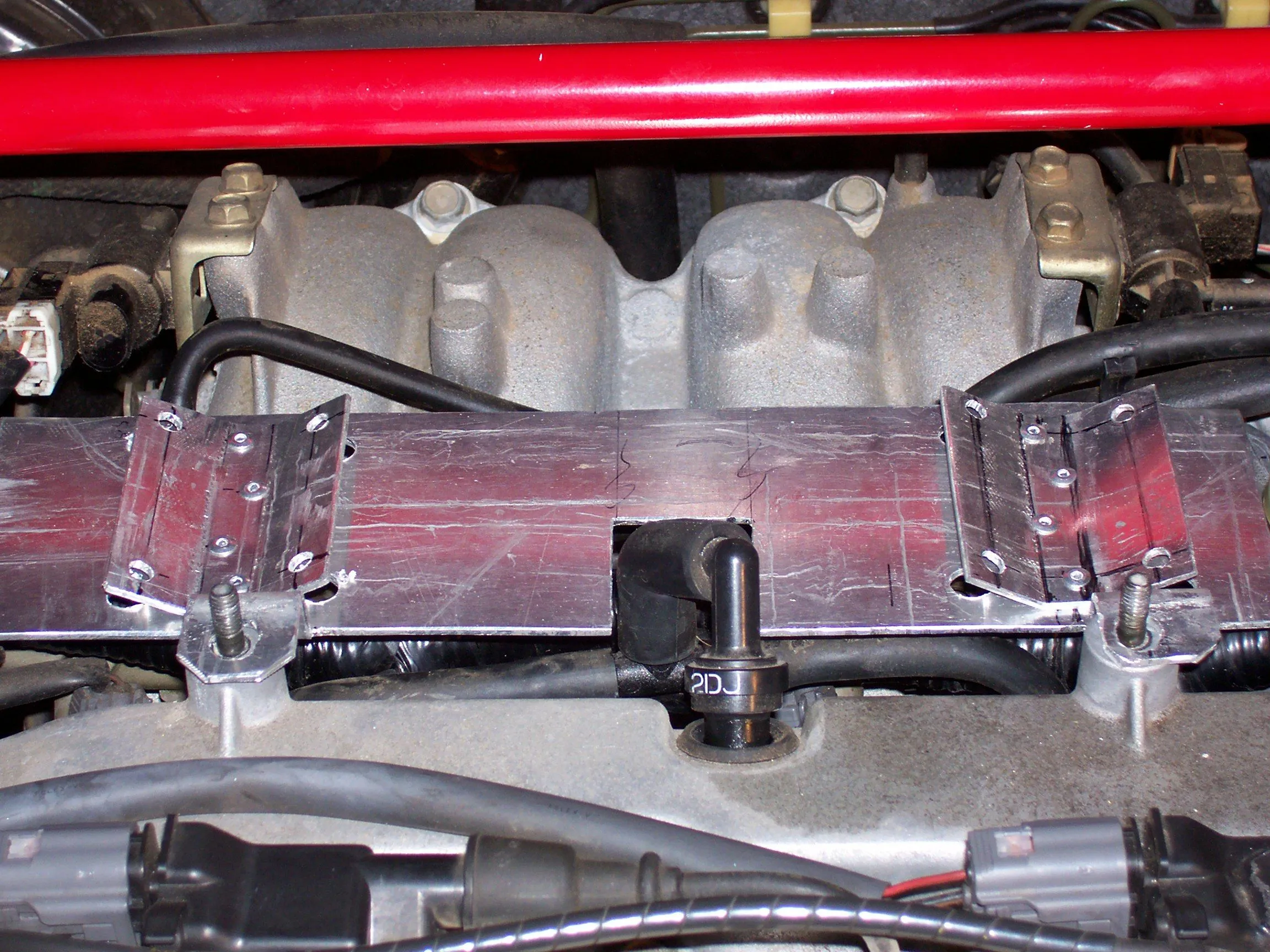

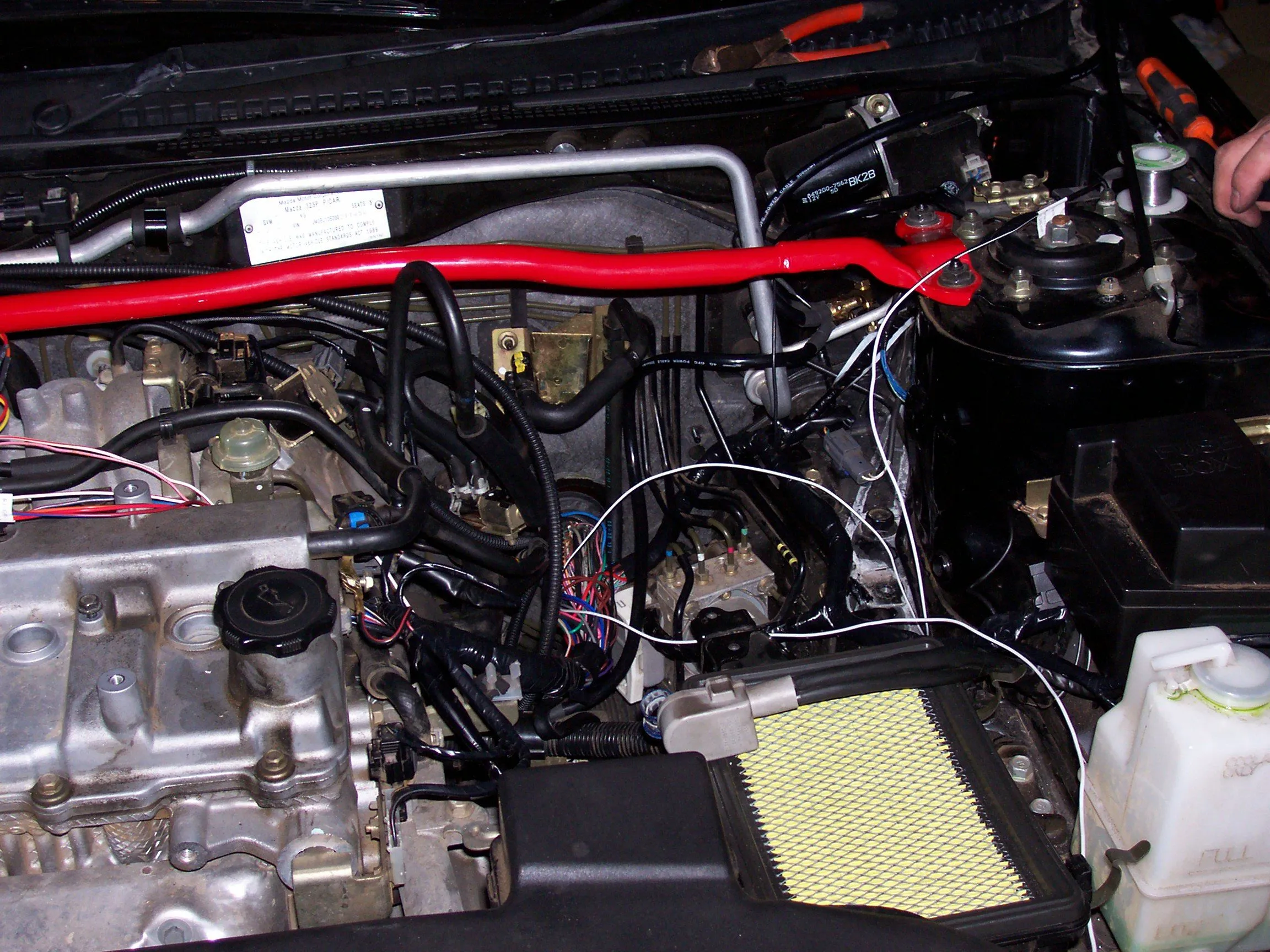

various pics of stuff in pieces..... oh the humanity! haha..
the wiring is pretty messy at this stage...we pretty much just did a "make it work" install... tidy up to come, when the new bracket, new valve cover, and assorted powder coating happens.

once i've got the bracket for the coil packs worked out, i'll be happy to share the cad file (once i am sure it works!) in case anyone else wants to emulate the setup.....I can probably swing together a set of leads as well....
