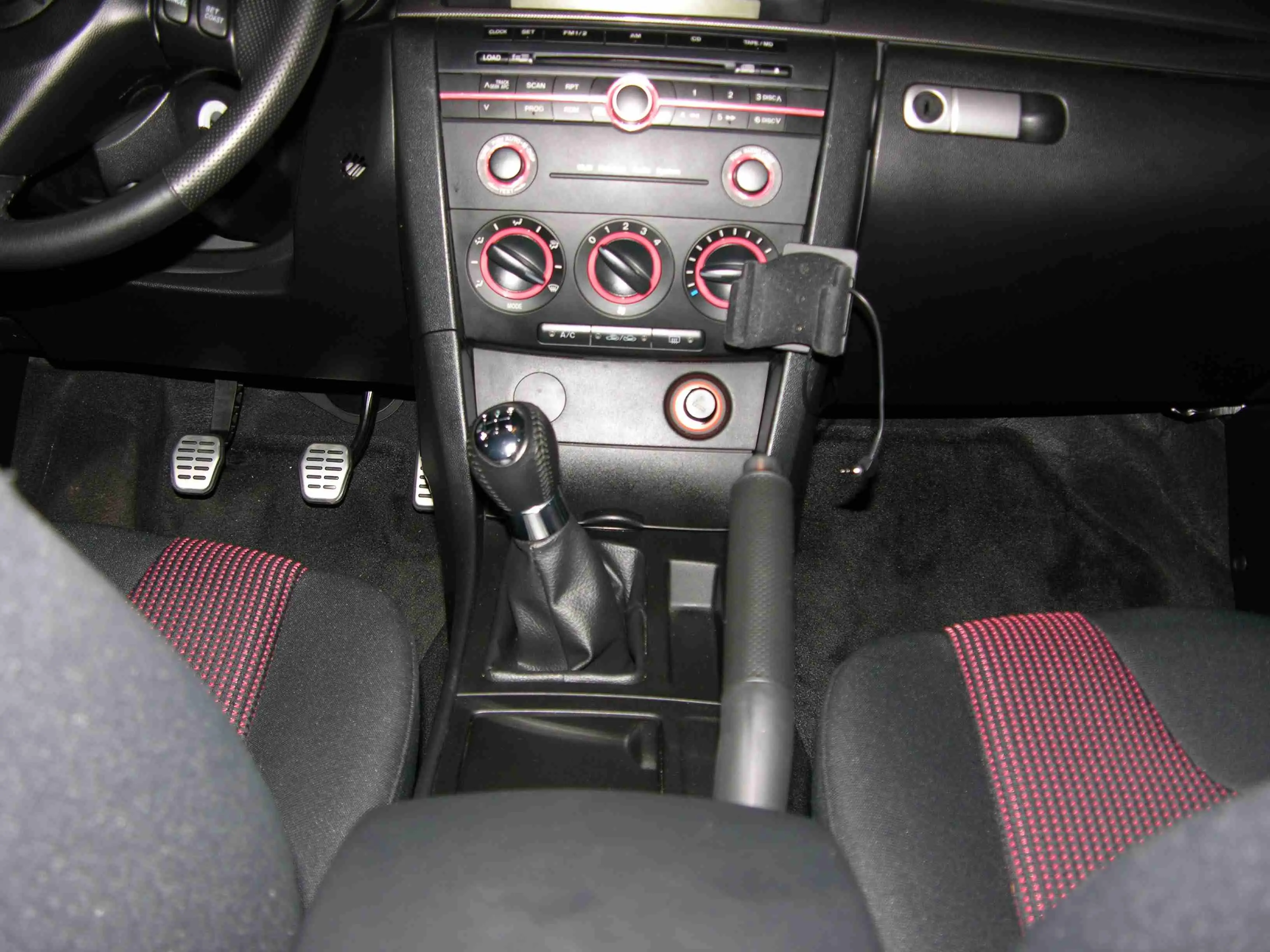

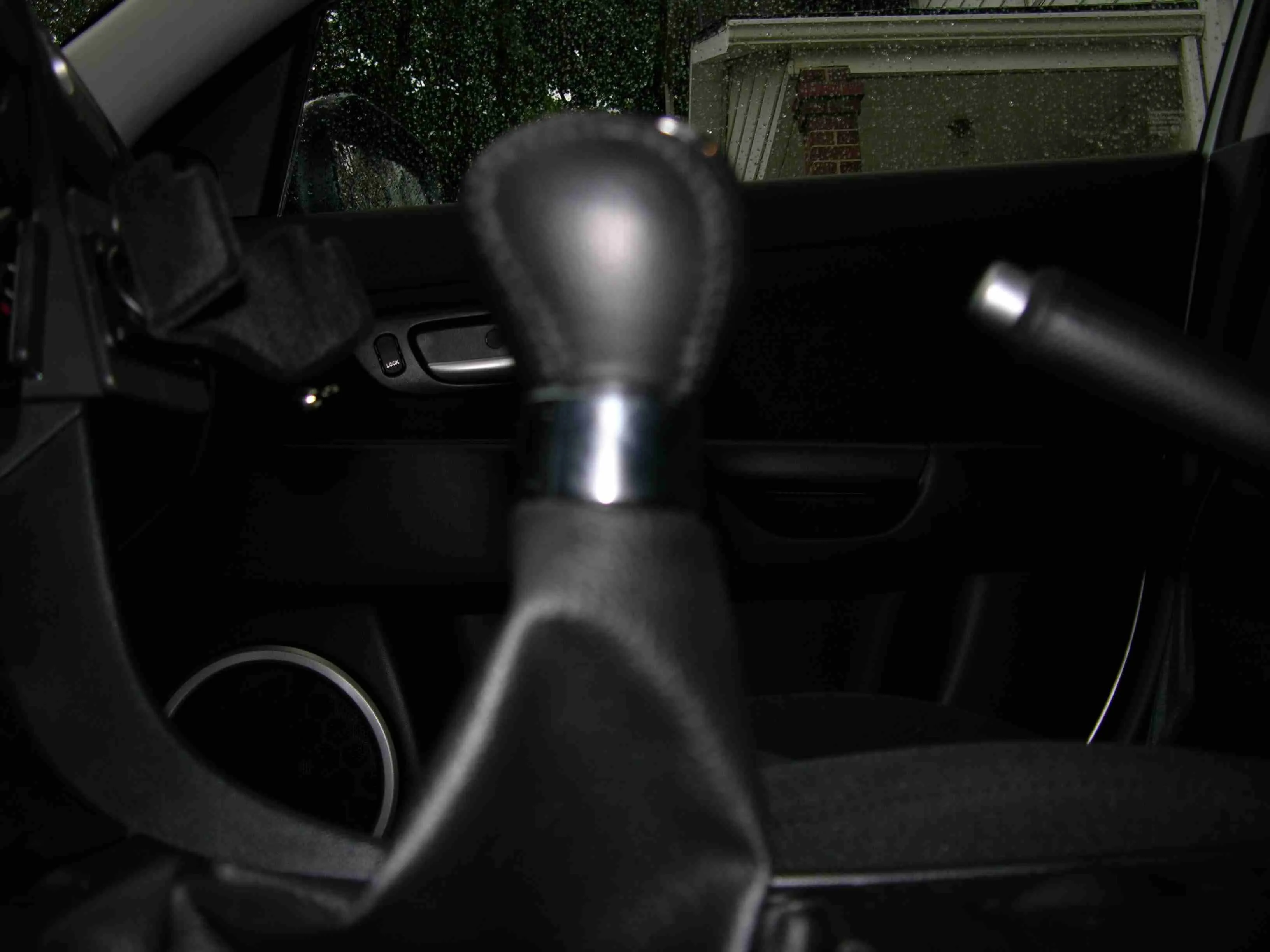

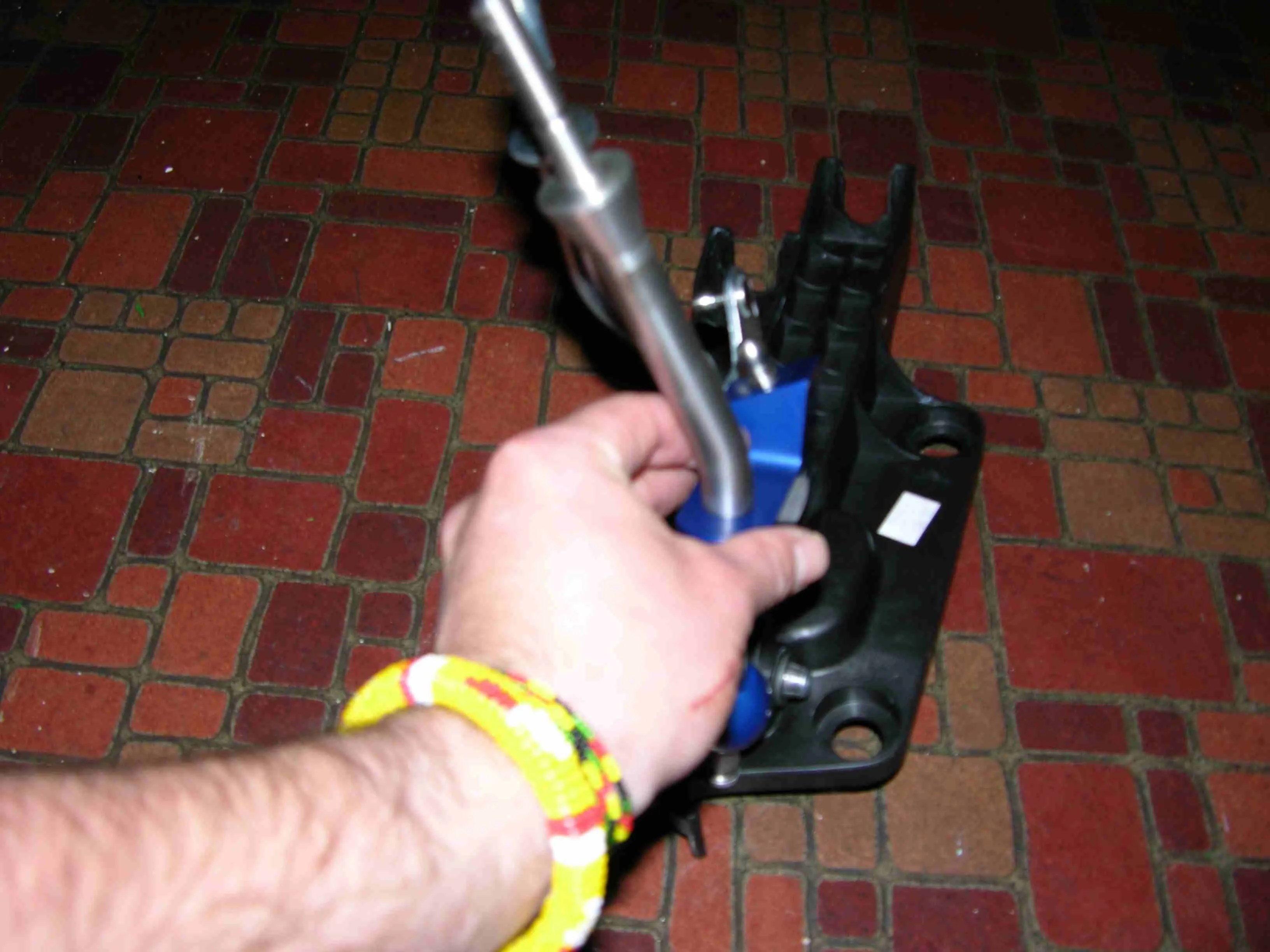

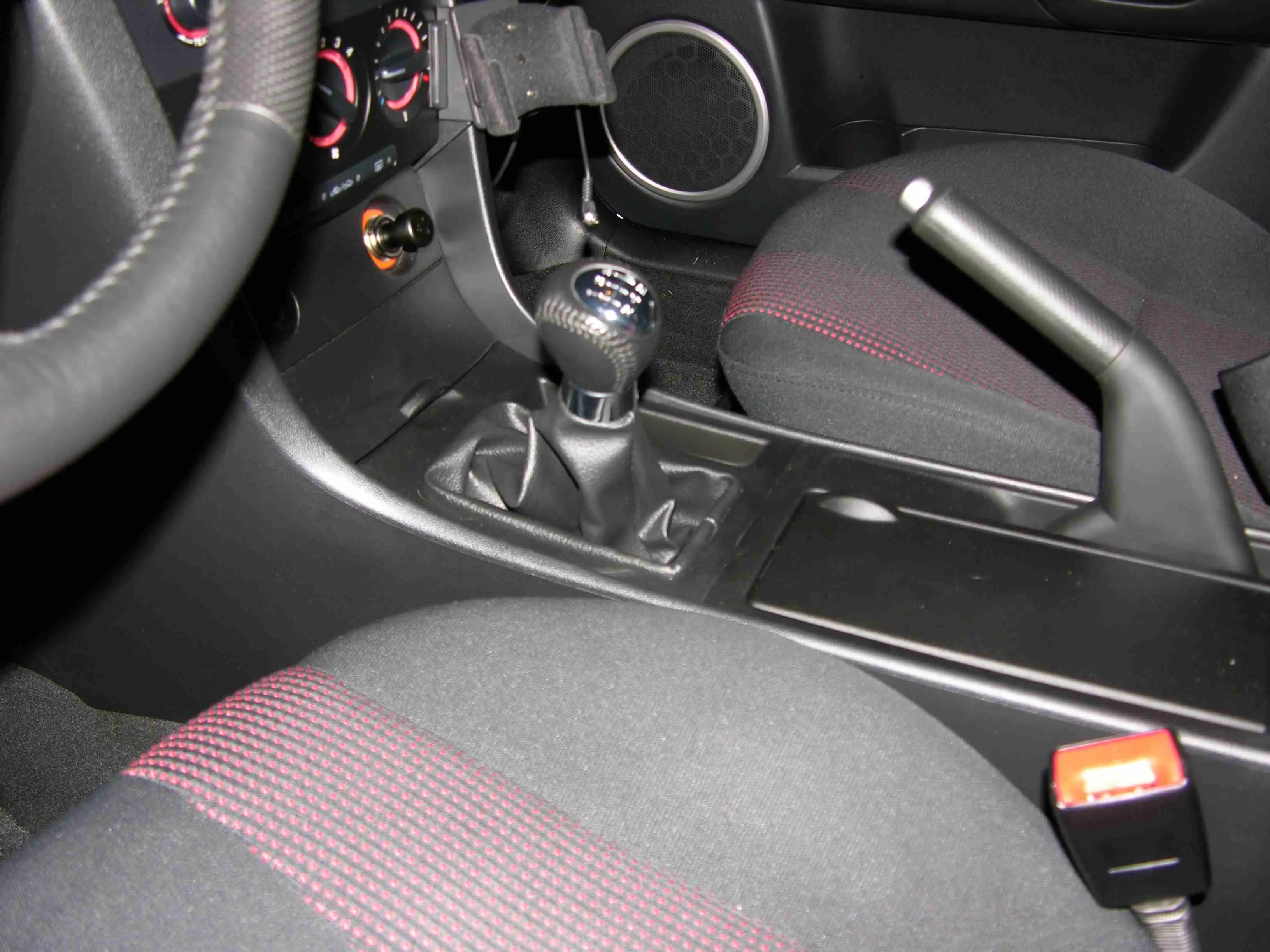

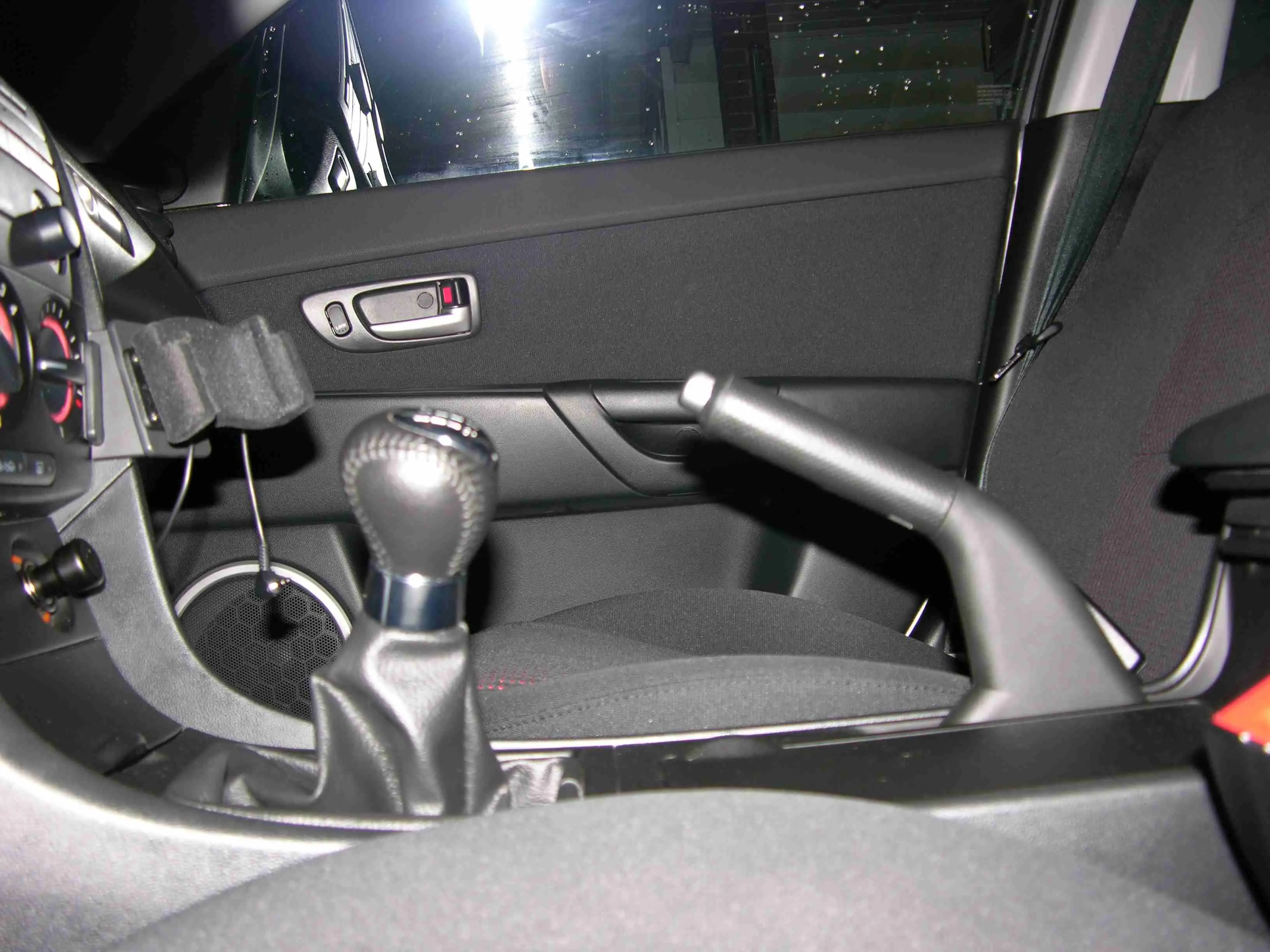

I just installed my MS sport shifter. So here are some pics. It orients toward the driver, which looks kind of lame, but it feels pretty good. Fifth gear is now in the center of the console. Shifts were reduced to 1, 3 and 5 gear, but 2, 4, and R feel the same. The shifting is much more precise with a mechanical feel. Shifting, however is not more difficult like people say about the TWM. It sits about a half an inch lower than stock. Overall its a decent shifter, I'm not sure about the bend toward the driver yet. By the way it was a b**** to install much more difficult than my intake.
The first picture is the stock shifter for comparison. You can really see the bend in the last picture. I need a round shifter knob now

install a b**** uh... that sucks... looks nice but you deffinatly need a new shift knob now.... strange how it doesn't feel like the throws to 2, 4, and R are any shorter. mazda always makes nice shifters and linkage... strange...
i think the razo is the best since is black and red like our interiors
I'm sure its a nice shifter, but I couldnt get used to the bend towards the driver. reminds me of a mustang. after seeing my twm also it doesnt really look that short. I wonder if install was for some reason different from mine, because I didnt really have much trouble and it was my first one ever. Also, when anyone gets a new knob, PLEASE POST PICTURES!! i really want a new knob but im have a hell of a time deciding what to get. thanks and congrats on the shifter!
Dread are you sure that it is supposed to look like that?
Did it come with install guide showing a pic of it bent that much toward the driver?
Yeah im sure, I have seen other installs and it looks the same. If you look at the shifter it does have a bend toward the driver. It is definately installed correctly. I dont know why mazda made it with the bend. It does reduce the side to side shifts and it is a comfortable position but it looks wierd from the back seat. Looks fine from the drivers seat. I like the shifting but don't like the look. I hope a round shifter knob will offset this. The install is the same as the TMW, I just had problems getting the shifter cables off and getting the spring back on.
