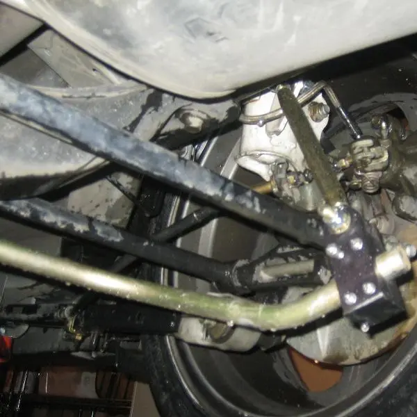

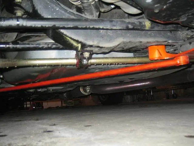

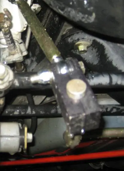

So I just spent 2 hours wrestling this b**** on (it wouldn't have taken nearly as long if I had just taken my GT spec stuff off before I started instead of trying to work around it), but it was worth every second of it. I can't even imagine what the 21.5 would be like, because the 19mm completely changed the feel of my car. Even in the rain, it's just amazing, ocmpletely changes the dynamics of the car. Understeer is virtualy eliminated, and even just cruising along the road at the speed limit in a striaght line, the car just feels soooo much more planted and solid all the time.
I would recomend this mod to ANYONE, wether you want to start autoxing or just have a little fun on the street, buy a new rear sway! It is worth every penny!
Sorry for the crappy pics, like I said it was raining and the car was already filthy. I'll post some better pics soon.

When hasn't it been raining up there lately? I went with the progress 21.5 or 22mm, whatever it really is. Like you said this made a big difference in the way the car feels & acts back there. I don't even have the illuminas & awr endlinks either. That'll be the next things that get replaced whenever the stock struts give out. Only lowered 1.3 so I don't think they're under that much stress for daily driving. Kudos on the pics, with that kinda weather not many folks woulda taken any. Good stuff, enjoy. Nice color on the car btw.

I don't think that it is so much a deal with adjustability, it is just the strength of the endlinks. They need to be stronger to match the stronger sway bar.
