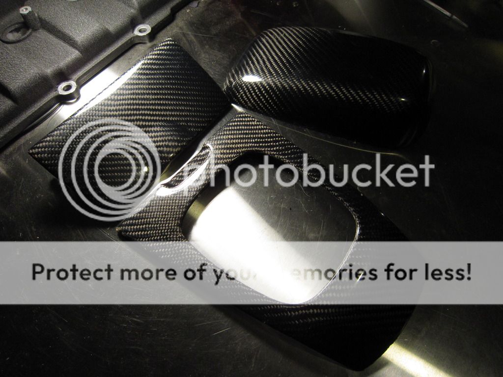

Today I came across a local guy who was in the process of turning his P5 back to stock and still had a couple of parts left.
I picked up these for myself, dont know if i'll use the cup holder, but I will be using the arm rest for sure.
And Also scored these, which you will soon see in the protege/P5 for sale section here on the forum. I was thinking about keeping them as spairs, but replacement struts from yellowspeed are cheap, and I still have my stock/eibach combo to run if anything ever happens. Pick these up guys, they're great coils. right around 1500 miles on them.
Sweet find! I love my Yellowspeed coils, and those are a steal with only 1500 miles on them.
Love the look of CF, but I was never a fan of the overlays, or caps. I know it doesn't matter much with these parts, or if the car isn't being raced, but the point of CF was always to reduce weight, not add it to the existing. Guess I'm just a detail nazi..
Yeah, I never was either. I usually take weight into account with everything that I do, so I never would have bought them. But heres the catch, Those cf peices cost me $10 haha.
