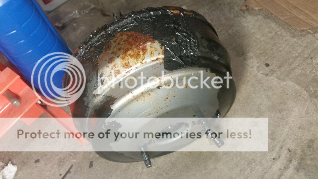

Just took the booster out, never have done that before. Super easy. New booster will arrive in the morning. Hopefully that solves the issue. Mine was rusty anyway from the old leaky master cylinder.
Was able to clean under/behind a bit too.

There is a pic of the bottom of the booster. The fluid ate the paint, and then is started to rust. Probably the worst condition part on the whole car, needed to be replaced regardless.
That's what I thought. Not too worried about it.
