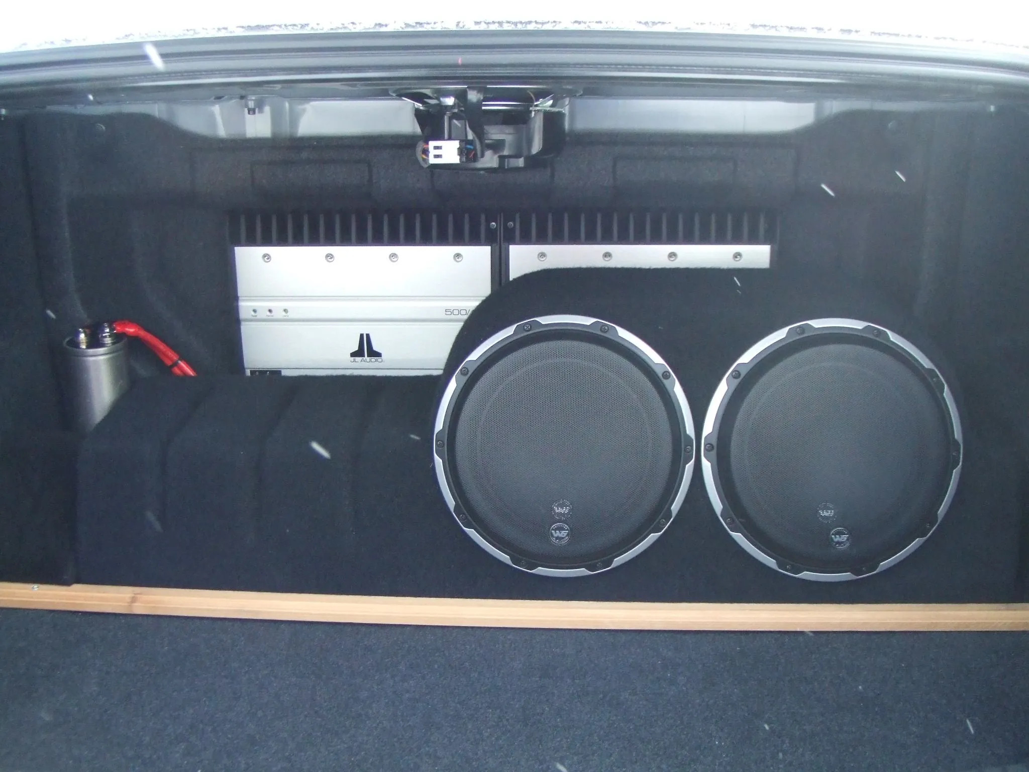

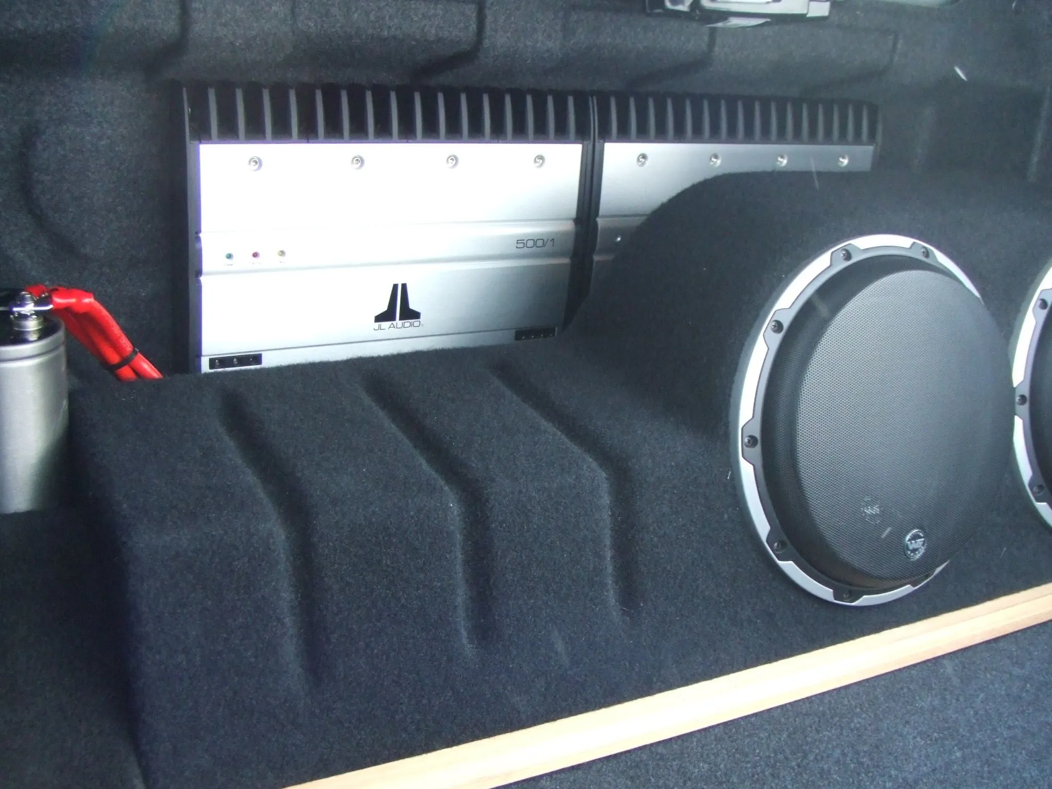

My current setup.
Not as custom as some but very stout! (headbang)
Yes I have Hushmat in the trunk and rear shelf along with the mounting board for the amps. I really need to redo the doors though or at least add more. I just don't want to add all the extra weight to the car.
Nice box tho man. Come this summer I think I'm going to find a good looking way to hold mine in place. Never thought about a piece of wood before.
I will be redoing the wood with a carpeted bar and 2 quick release pins on the ends so I can remove to get at the spare tire, just have not had the time yet. The box is a JL Stealth box out of my 07' Dodge Megacab. It is built for the Megacab but fits very well in the Spd6!
