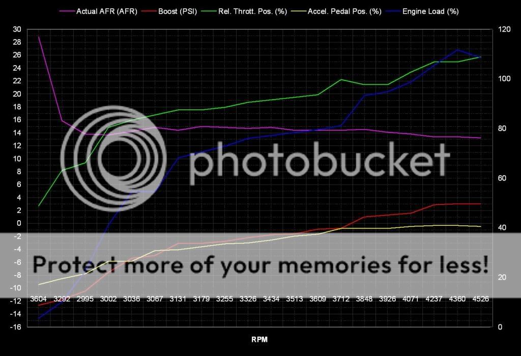

Just wanted to share my results. I modified my ltft's so that my trims are zero at WOT and adjusted my throttle requested load tables a and c for linear response.
Here are the values I used

Here is a part throttle log showing the linear boost and load. Load and accelerator position are on the axis to the right.

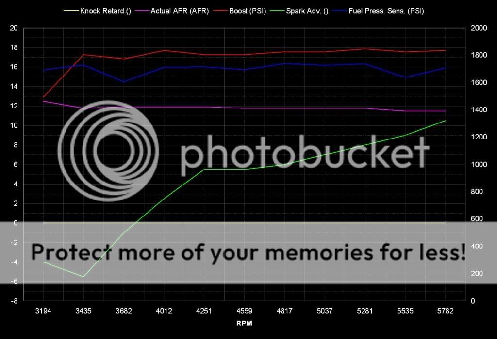

Here is a 3rd gear WOT log
