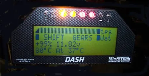

Attached is the handset and the dash unit pictures... The handset would be included in the cost of the unit... you just wouldn't get the laptop software and adapter included. If you want both it'd be a bit extra.
The dash unit would be quoted seperately.. but is relatively price (somewhere in the 300ish range by itself. )

If you want the dash unit instead of the handset or the laptop setup it would bump the system cost by roughly 200 dollars. If you want it individually it would run you an extra 390. It's not a cheap add on unfortunately. But quite impressive piece of equipment.
The Microtech can be programmed 3 different ways:
From a laptop
From a handset
From a dash unit

maybe a stupid question: can the microtech be tuned the same way using the dash unit instead of a laptop? What i mean is, do you lose anything by going with just the dash unit?
