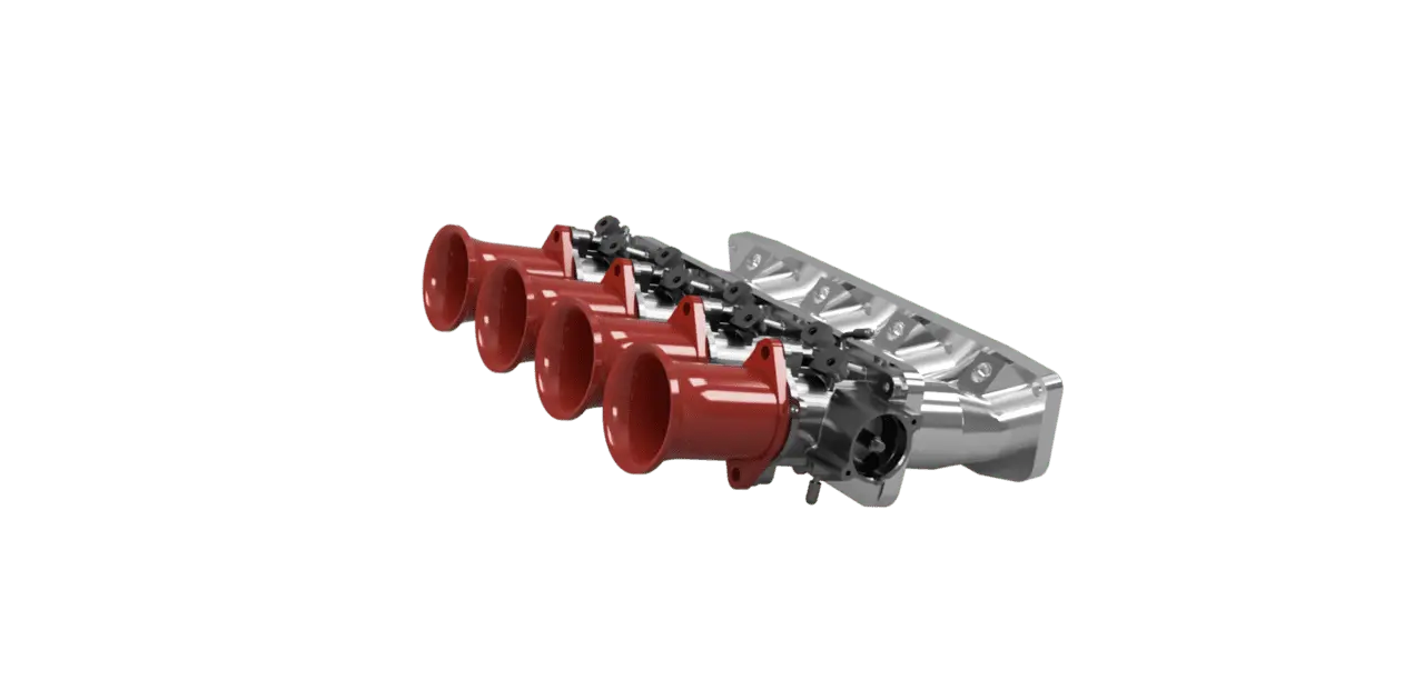

Figured I would cook up a new thread for this since i'm not really hunting for models anymore,
here is some progress on the itb kit for ZM/ZL powered proteges and various other mazdas.
I have elongated the intake runners to make room for the injector mounting holes, I have angled them at 15 degrees which I honestly don't think is quite enough but we shall see.
using 4AGE itb's in the pic, not 100% accurate in size but I believe there might be justttt enough room to make it work
The 4AGE throttle body holes are pretty bang on in terms of matching the size of the factory port holes on the ZM head.
