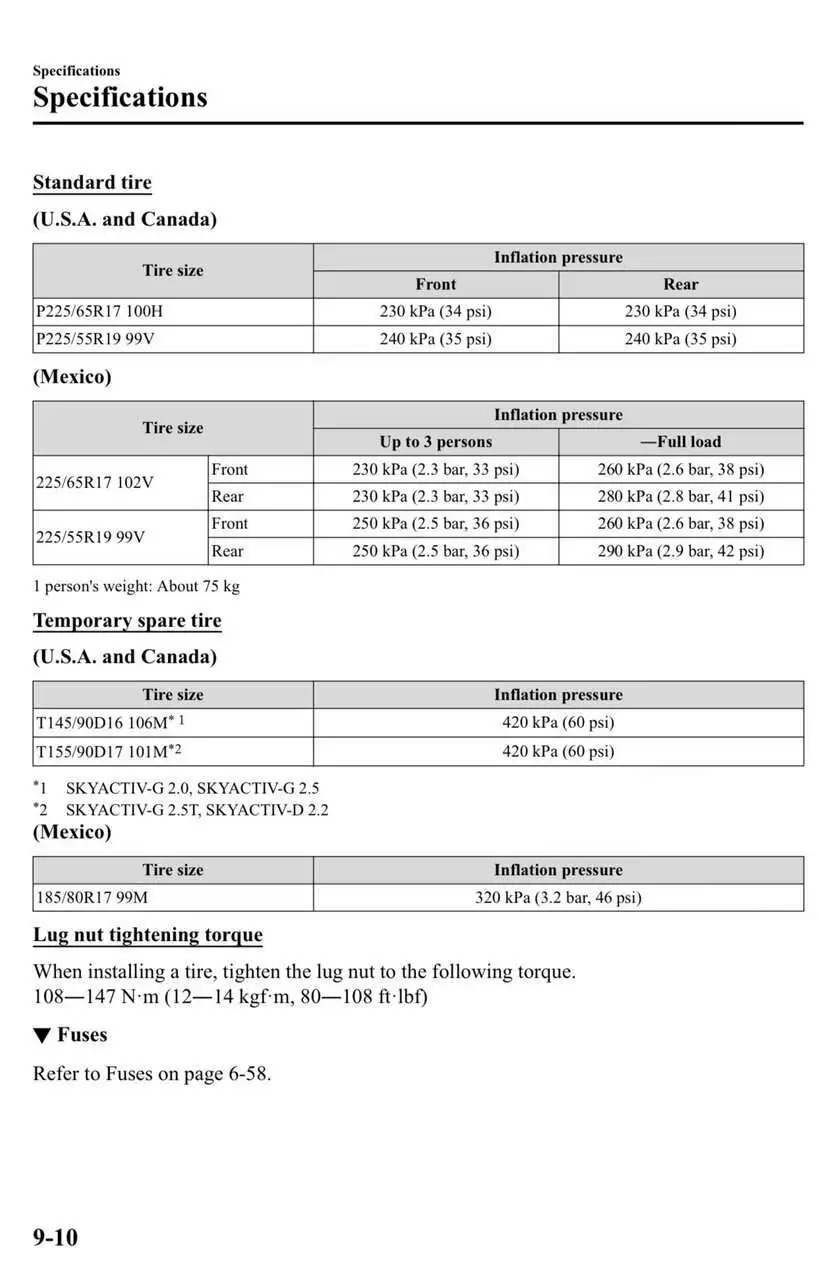

This’s only the problem in US and Canadian markets for 2019 CX-5 with a 2.5T which uses bigger dual-piston front brake calipers. Mazda has fixed it since 2020 MY and supplies bigger compact spare T155/90D17 101M instead of T145/90D16 106M for the 2.5T CX-5 which will fit the front.
2019 CX-5:
2020 and up CX-5:
Yes. I never paid much attention to it before, but there is a warning in the manual that does mention not to put the spare on the front wheel because handling would be terrible with a spare on the front wheel. And it makes total sense when you think about it.
Yes that’s the standard procedure stated in owner’s manual. But I personally had done tire change on the shoulder of the highway a couple of times and I really want to spend minimum amount of time doing the tire change due to the safety reasons with those 18-wheelers passing by fast. I’d put the compact spare at front and drive away ASAP if I do have a blow-out at front. IMO the temporary spare should be able to be mounted at the rear AND the front. Unfortunately Mazda gave only T145/90D16 106M as the compact spare for US CX-5’s on 2019 MY, where that’s the first year the 2.5T was introduced and the provided 16” spare can’t fit at front due to the larger dual-piston disk calipers.
