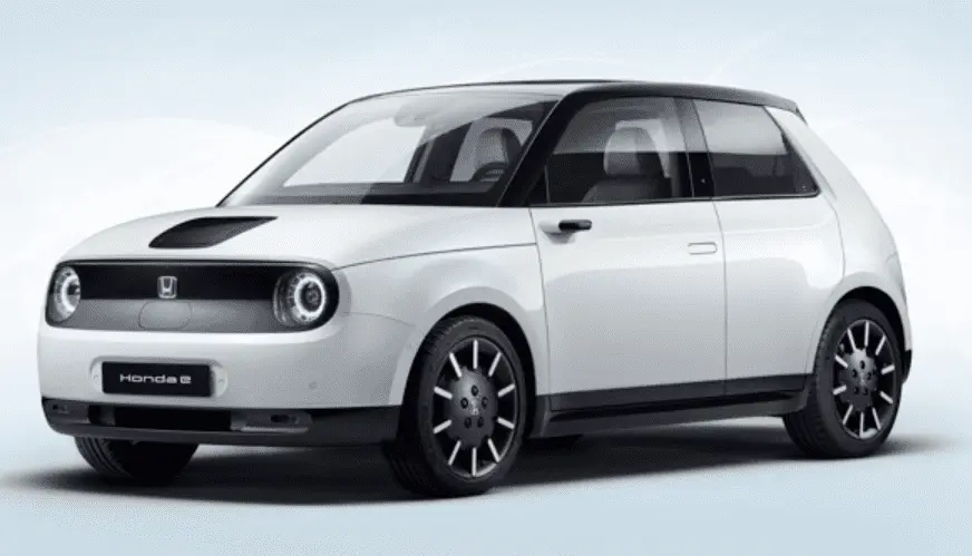

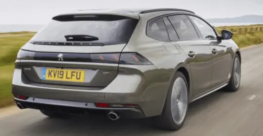

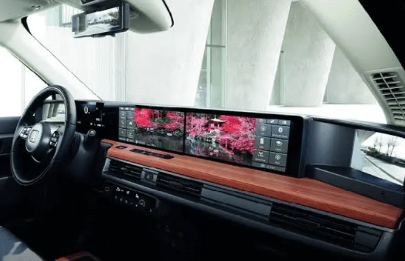

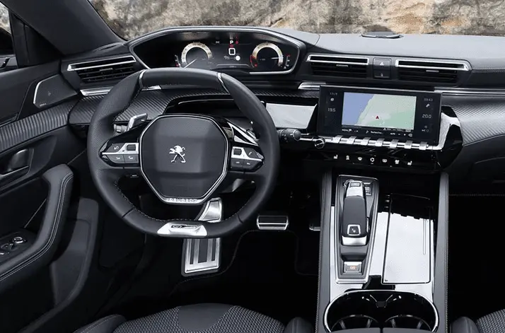

From an enthusiast point of view, I'd sell my CX-5 in a heartbeat if I were moving abroad.
Rest of the World gets so many fascinating vehicles that we can never get in the US.
I wouldn't hesitate to try out something French, reliability concerns aside...
Or even one of those small EVs...
Have a fun move, and don't let your existing US items restrict you - would you even need such a large vehicle in Europe?
