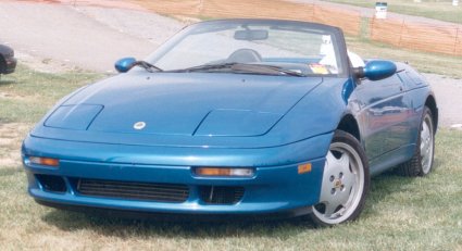

Good enough for Lotus, good enough for me. :)
