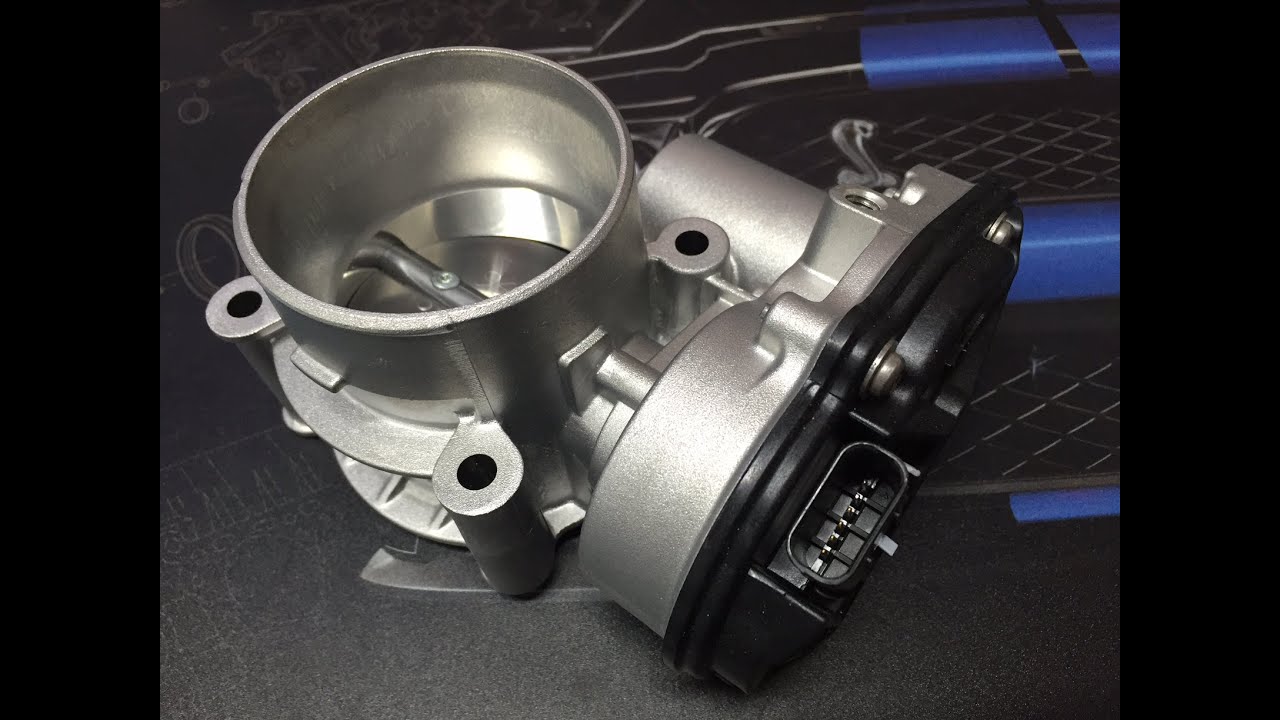

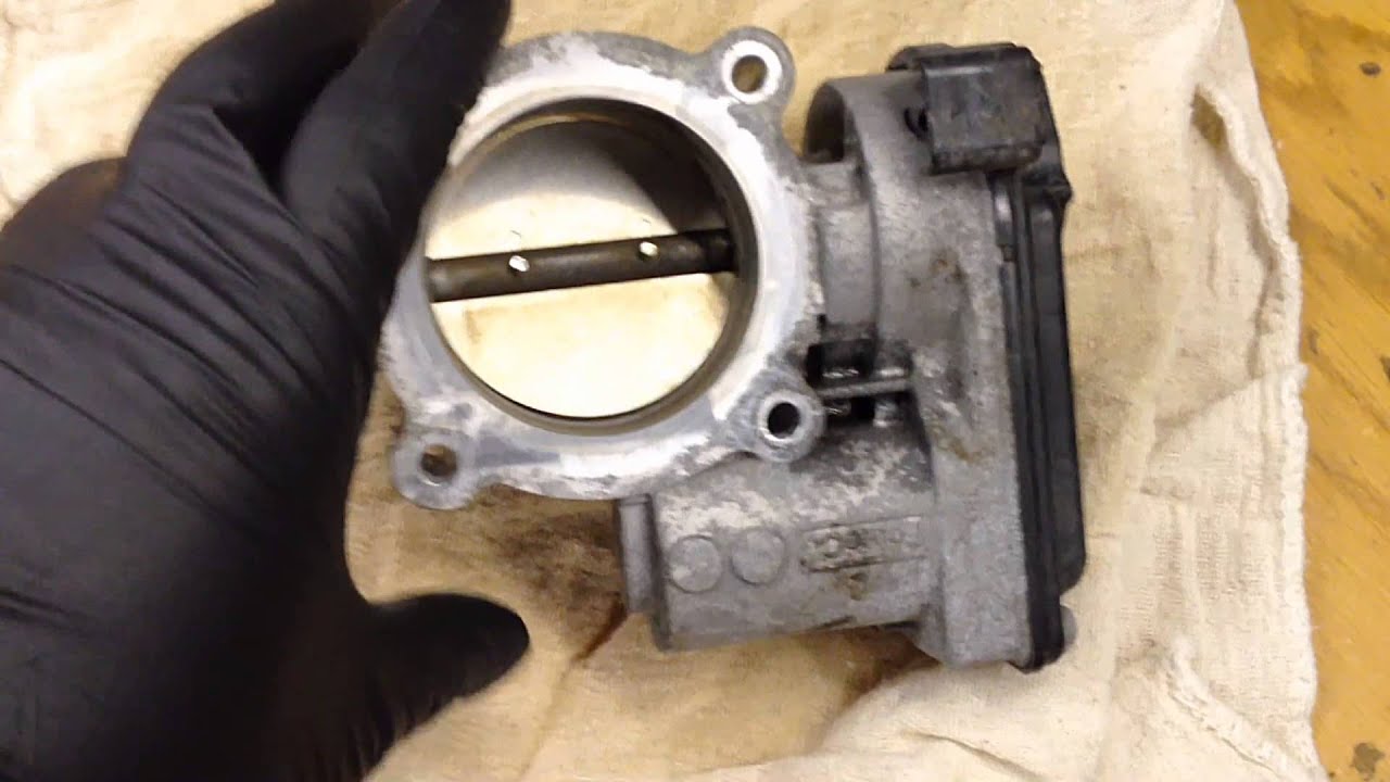

If not done so, clean throttle body and reset PCM and go through idle-learn process.
example guide: Mazda throttle body relearn

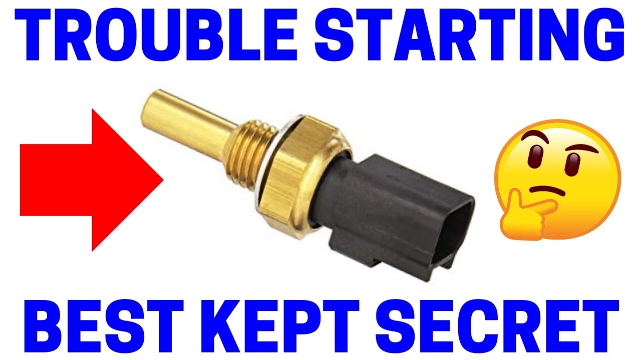

> Next start a few hours later will be difficult. Even managed to flood it last time it happened.
If the hard starting only appears shortly after it has been shut off, it could be a faulty coolant temperature sensor that flooded the warm engine with gasoline:

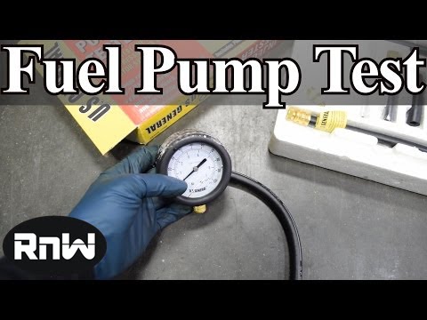

So let's say the fuel pump is the culprit. Will that necessarily show in a fuel pressure test?
It can. But won't rule it out either since you're chasing a weak pump and not a dead one. Could be a fuel regulator going bad too.
Hard starts can be a pain to find. Might ultimately not be a fuel issue. Like was mentioned above, it might be a coolant temp sensor or something.

If this is 100% reproducible, I'd take out the (FoMoCo) throttle body, clean it thoroughly, and go through idle relearn.
