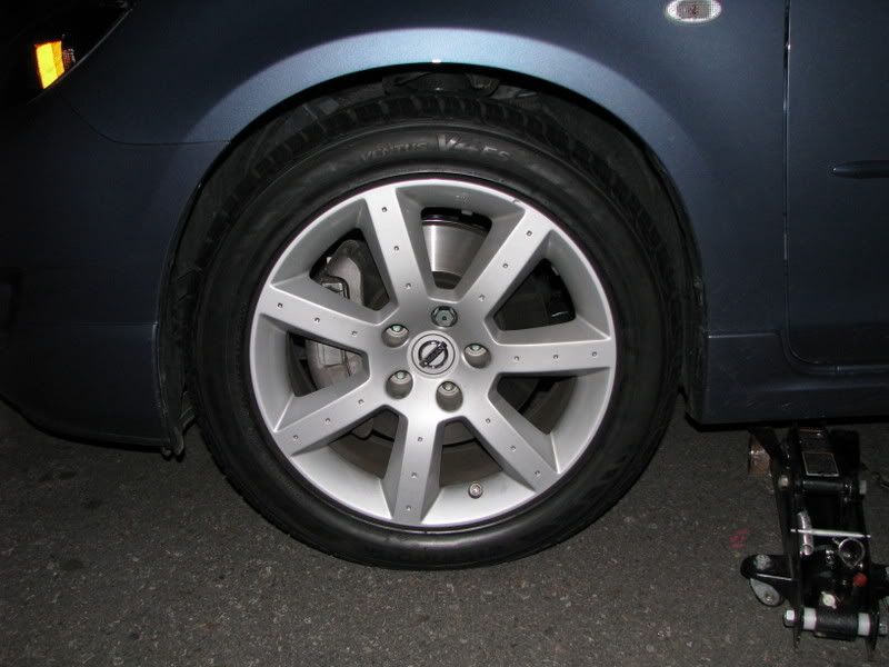

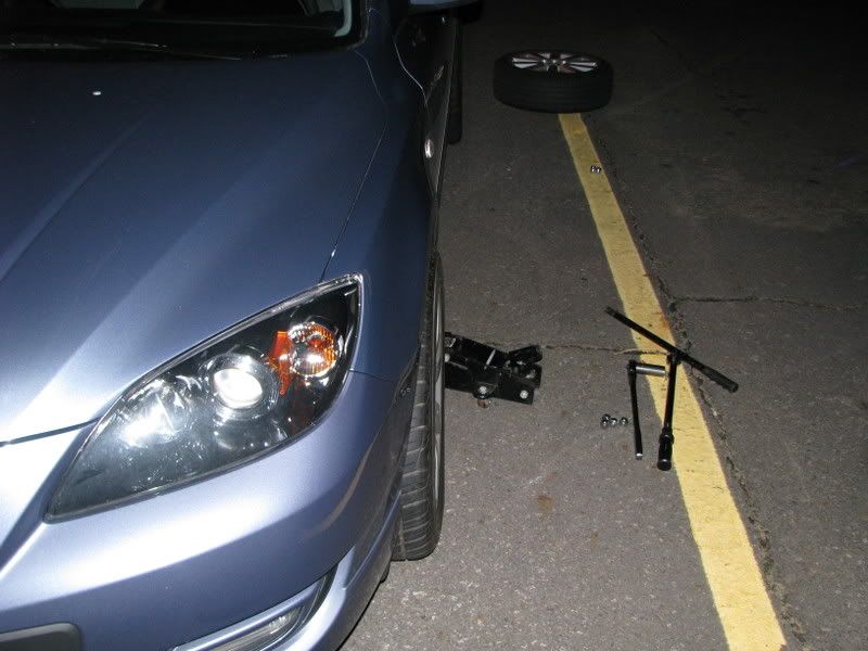

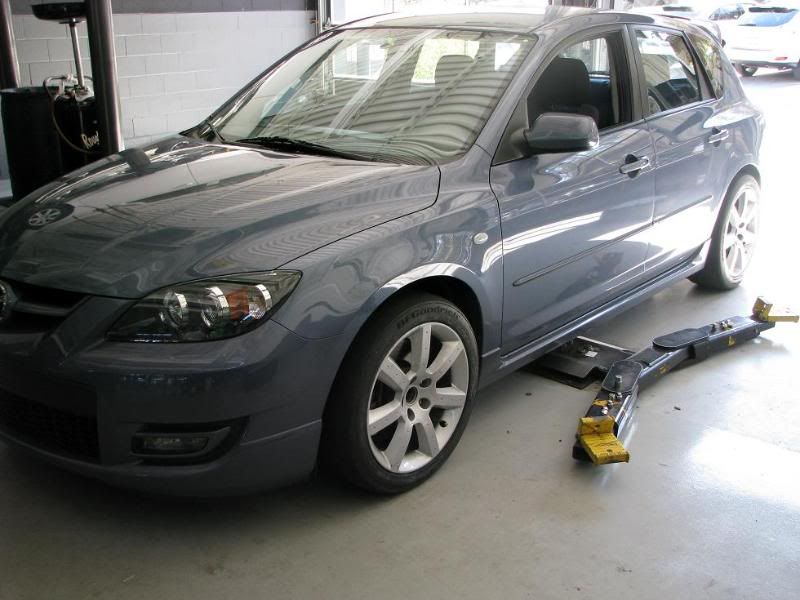

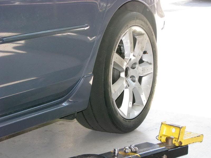

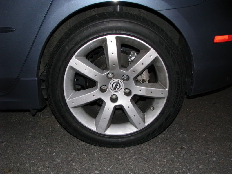

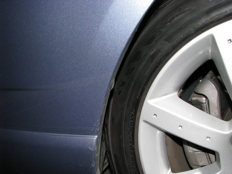

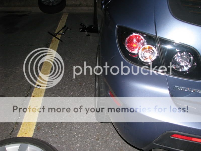

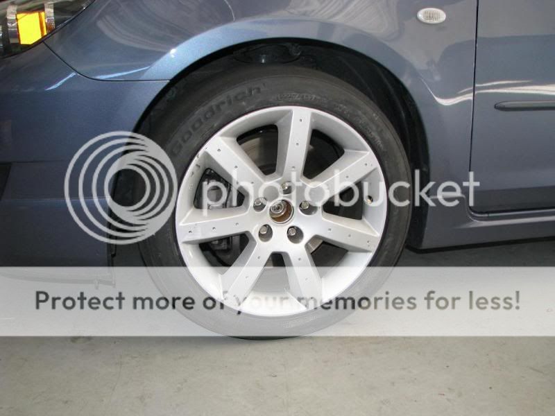

I have a 350z as well and my 08 Mazdaspeed3. I just put a new set of wheels on the 350z so I decided to see if the stock 17" 350z wheels will fit on my ms3. The stock 350z wheels are wider in the rear then in the front and also have 235's in the rear and 225's in the front...or at least thats how I bought it used from the nissan dealership. So I decided to put the 235's in the front and 225's in the rear. I was mainly look to test the offset and make sure I don't need spacers or anything. I didn't drive the car with the 350z wheels on it just test fitted. With the wheel at full lock the front of the tires hits the fender lining, but the 235's are a 50 series...lol. I'm going to be putting 225/40-17 hoosier a6's on the 350z wheels.
Anyways here are some pics...
