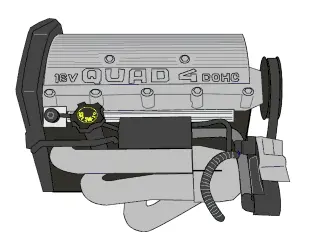

It'd be interesting to see what a manifold with equal length runners and no collector would do. Is it too late to change your course of action? :)
what do you mean by no collector? The way I'm building it is the throttle body will be between #2 and 3 cylinders to help equalize the flow between #1 and 4
Oops, I should have been more clear - I meant no collector pipe. With an equal length runner installation, each of the tubes would join at the throttle body, much like that of the GM Quad4 LD2 engine.
Attached is the only image I could find of the thing, but it'll do. If you're interested, I can get detailed pics of the manifold at work tomorrow as we have a bunch lying around the shop.
ahh, i know exactly what you're talking about. They have the same type of intake on Toyota Previa vans.
