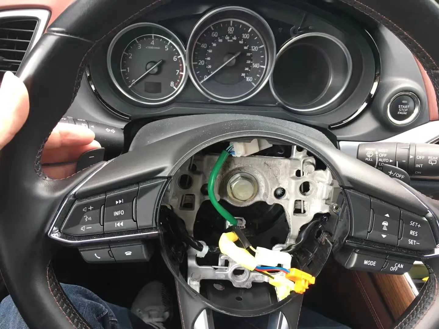

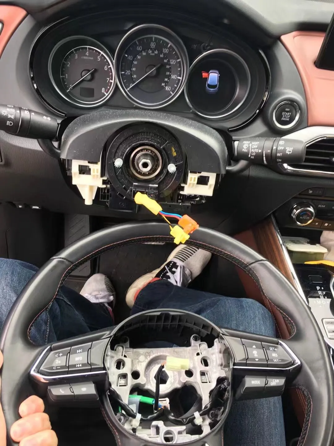

Installed paddle shifters in my CX-9
2016 cx9
and LED upgrade
https://www.ebay.com (commissions earned)
2018 CX-9AWD GT
Nice! I did the same for my CX-5 a few years back and was wondering if the wiring was there to do the same with the CX-9. Looks like i've got a new project!

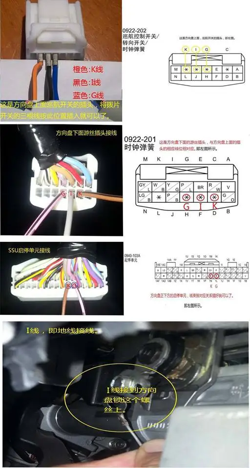

Regarding the harness, The 6 fische call out a "harness" with a part number: TK50-57-KHX, but looking at the drawing it sure does not appear to be an electrical harness? The part number you called out (BNK8-66-4M2) looks like the correct harness, but of course, it's not for a 6.
You'll likely also need the wire adapter from Japanparts to plug into the cars main harness inside the steering column, like linxiabing shows in his photos. Most likely the same one used on the cx-5 will work.
