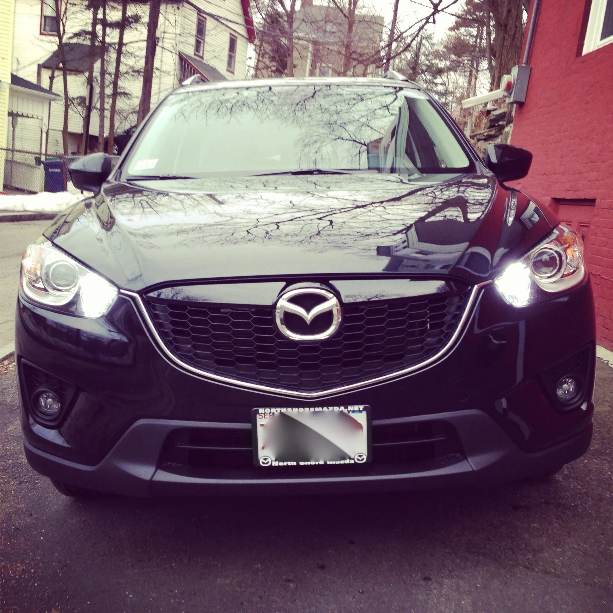

Installed the LEDs this weekend. Easy to do and really liking the look.

The LEDs look nice. Is it just held by double sided tape?
