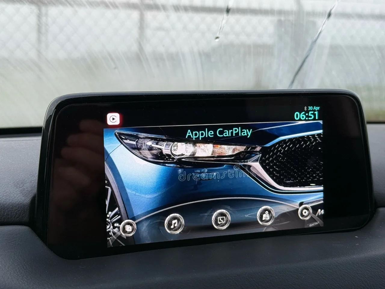

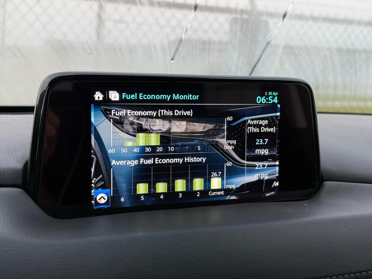

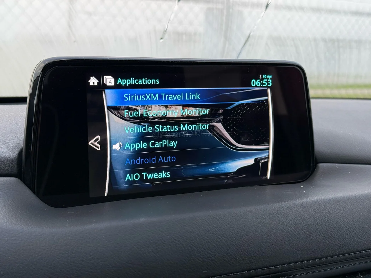

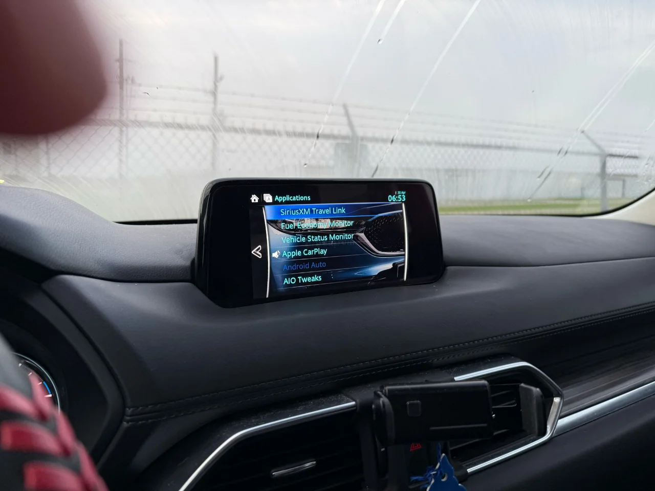

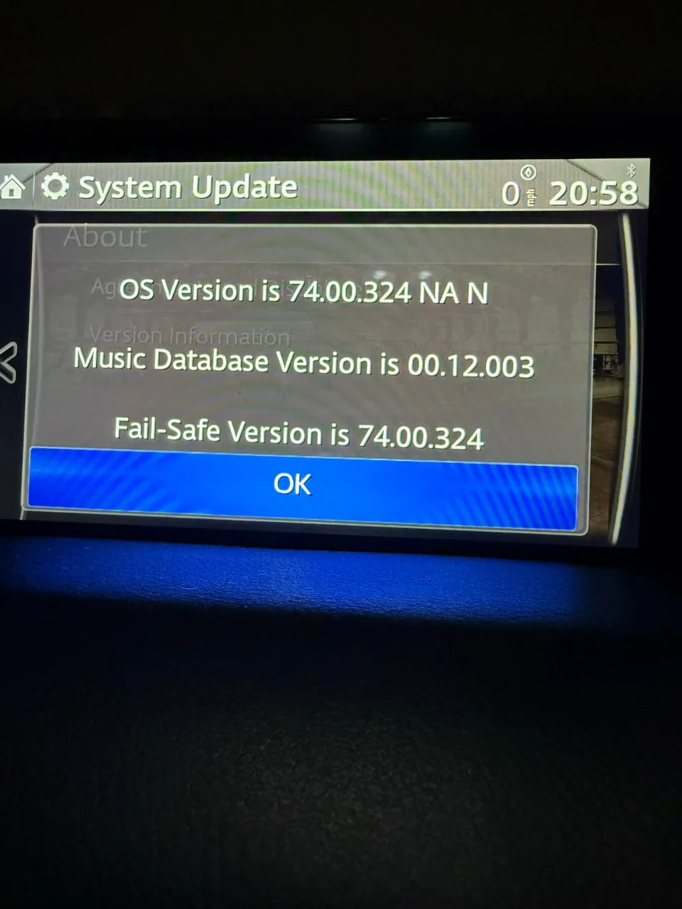

If you're afraid of losing the AIO tweaks, no need to worry. Some smart guys figured it out how to install the AIO tweaks on the latest OS version. I suggest to do the update to version 74.00.324 and then install the AIO Tweaks. I have a 2020 CX-5 and recently installed the AIO on version 74. See pics.
