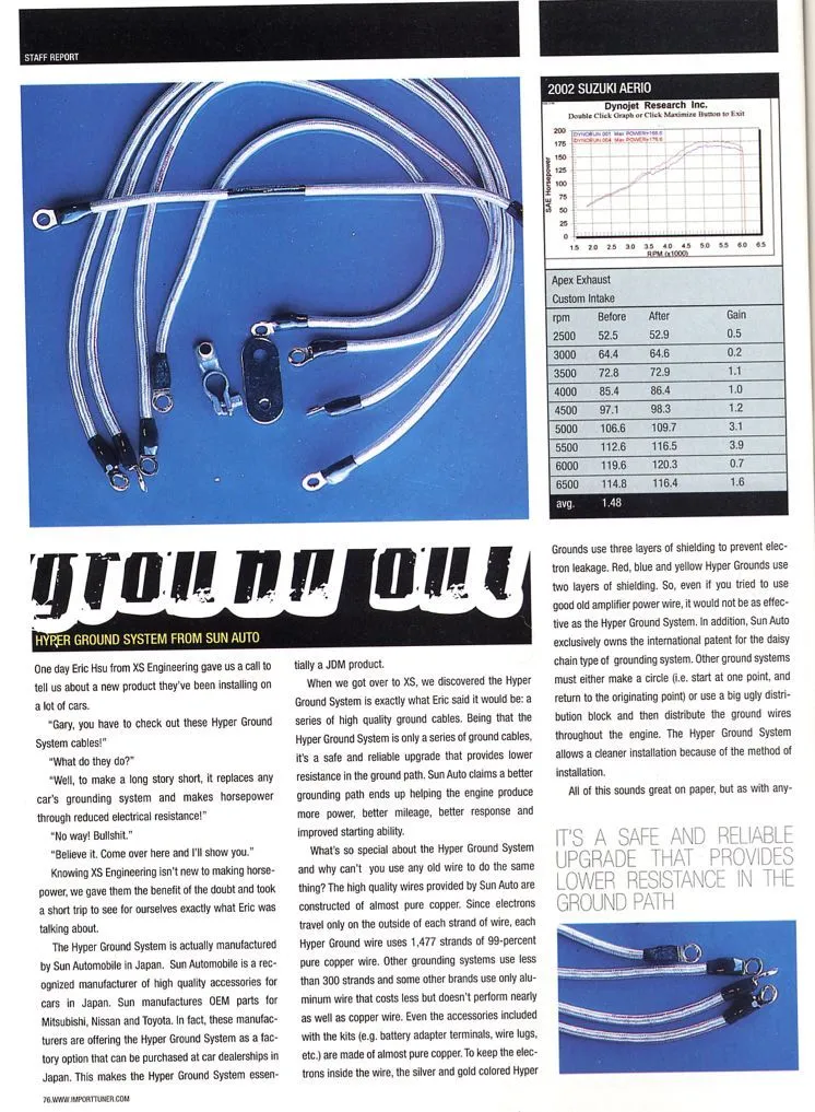

Impor Tuner Article on Hyper Ground-wires
Import Tuner Article Scans
Attached are the Import Tuner article pages
Page 1

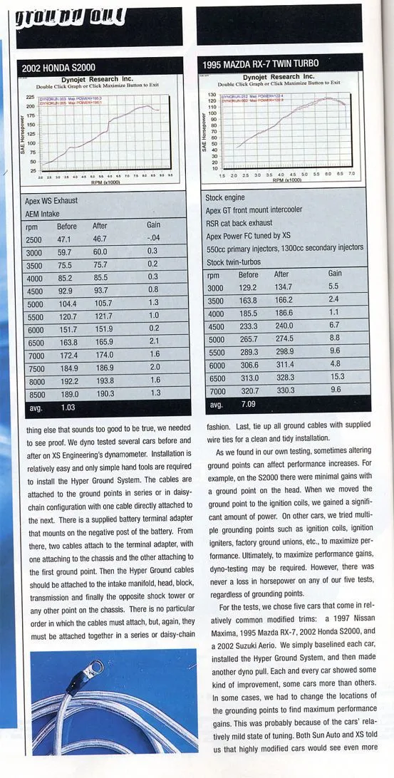

Attached are the Article Scans
Page 2

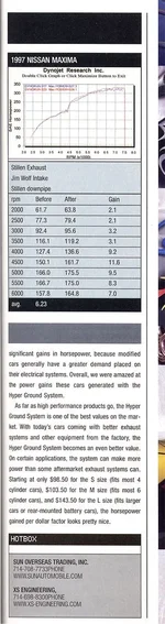

Attached are the Import Tuner Article Scans
Page 3
Thank you, Jrod for the article this reafirms my purchase. I can't wait to see how it works on a Protege. Hopefully I will have this kit in my greedy little paws next week. :D
