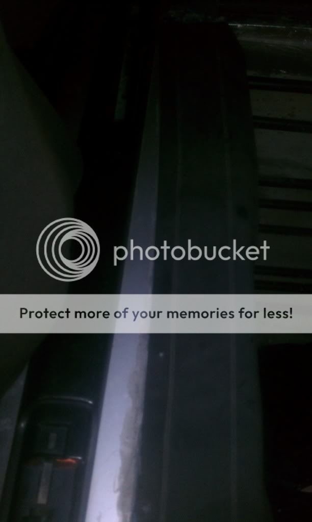

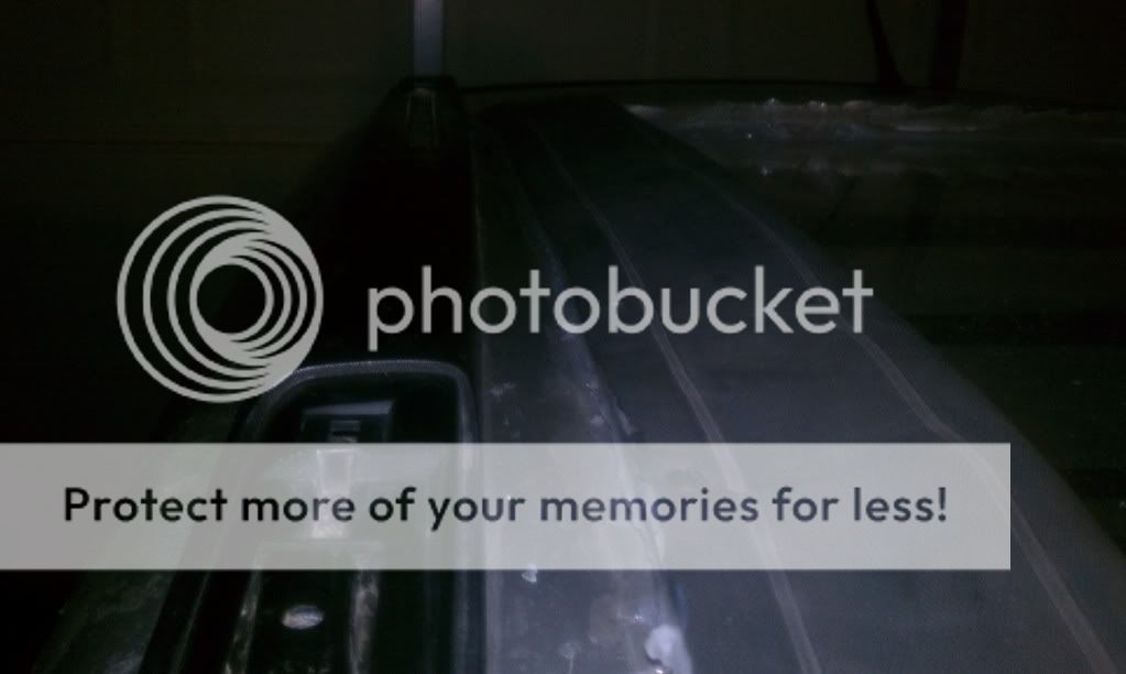

So i cut the old vinyl top and it looks pretty good!
These pictures represent a very rough draft the top is just folded and placed on top of the aluminum area and roof. It will be much cleaner when I put it on.
The only problem I have now is how i'm going to permanently attatch this to the roof.
I've been looking into different adhesives and none of them seem to be able to hold vinyl and acrylics together under these extreme conditions.
What I might end up doing is backing out the old screws and inserting them Under the fold on one side putting it back in, then using new screws on the top to attatch it to the other area of the roof, this will give it sort of a rugged look but this isn't that type of car and it would probably just look ghetto.... I also don't want to back the old screws out, because when i put them back in it will inevitably be weaker...
Maybe i'll get very very small self tappers and put them into the plexi.
I'm not sure but that's basically my next step is figuring out how to attach vinyl to plexiglass...
I don't know.. but the hunt for something to attach this begins....
Once i find that, all i have left to do is clean up after myself and smooth everything out.
