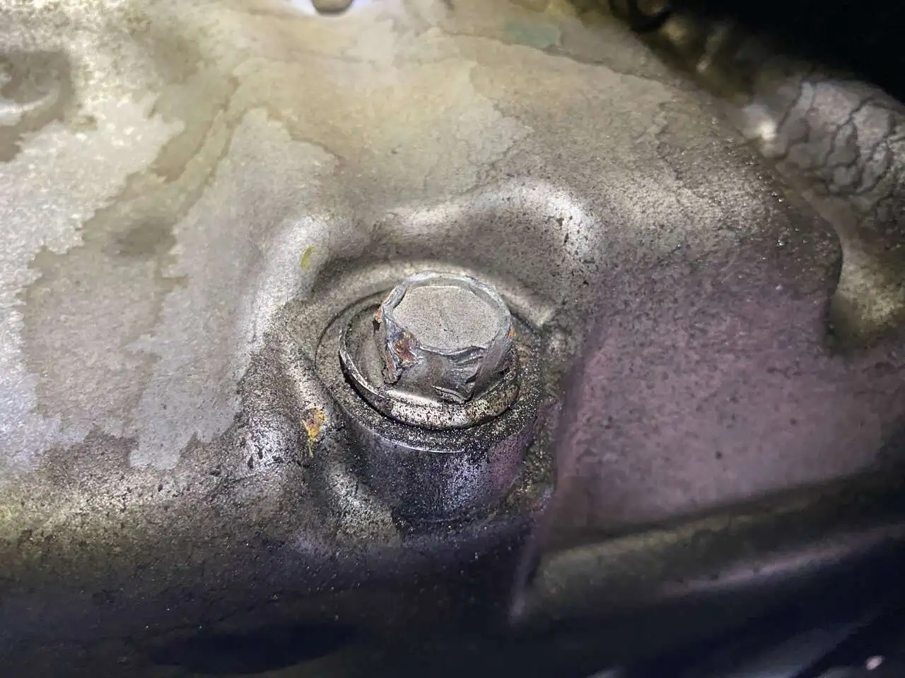

One of the first tasks was an engine oil change. Here's the drain plug as it came to me:
Fortunately it came right out, and a stock-replacement one went right in. Kind of blows my mind how someone could do this kind of damage without over-torquing or stripping the threads. Either way, I'll take the win.

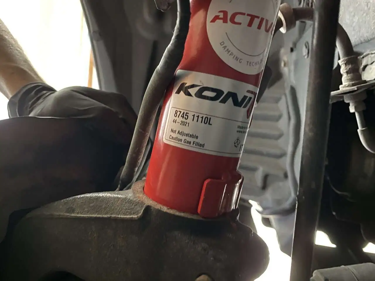

Shocks and struts were another early job. I was super excited for Koni Special Actives, having experienced the old FSDs on a friend's E46 3-Series. It rode spectacularly, and the only complaint I ever heard was weird limit handling. Seemed like a completely fair tradeoff for a FWD family hauler.
The front Special Actives are shared with Volvos, which means they’re available on FCP Euro. Not much of a value add as they are already warrantied for life through Koni; the main benefit of FCP Euro’s warranty is that it’s basically unconditional.

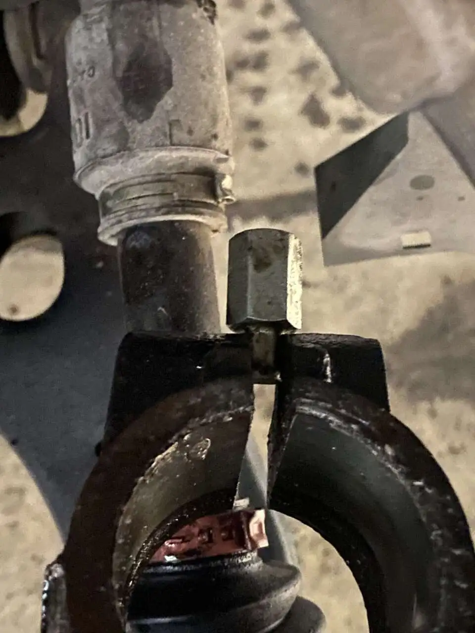

To aid the job, I had this tool from working on my M3, which also has MacPherson struts with clamps up front. You stick the tool in the gap vertically, put a wrench on it, crank it 90º, and it spreads the clamp. Made it much easier to get the struts out.
Wasn't enough to get the new ones in, though – but it helped. For final assembly, I used a big flat-head screwdriver that happened to have a 10mm hex shaft. With a jack pushing up on the spindle, I stuck the screwdriver head in the gap, put a 10mm open-ended wrench on the shaft, and cranked until the strut popped into place.
Installed pics:
Thought it was weird that the PS strut has that nice fin on the back but the DS one doesn't. Made the DS one more annoying to line up. Nothing a Sharpie and some fiddling couldn't fix, though.

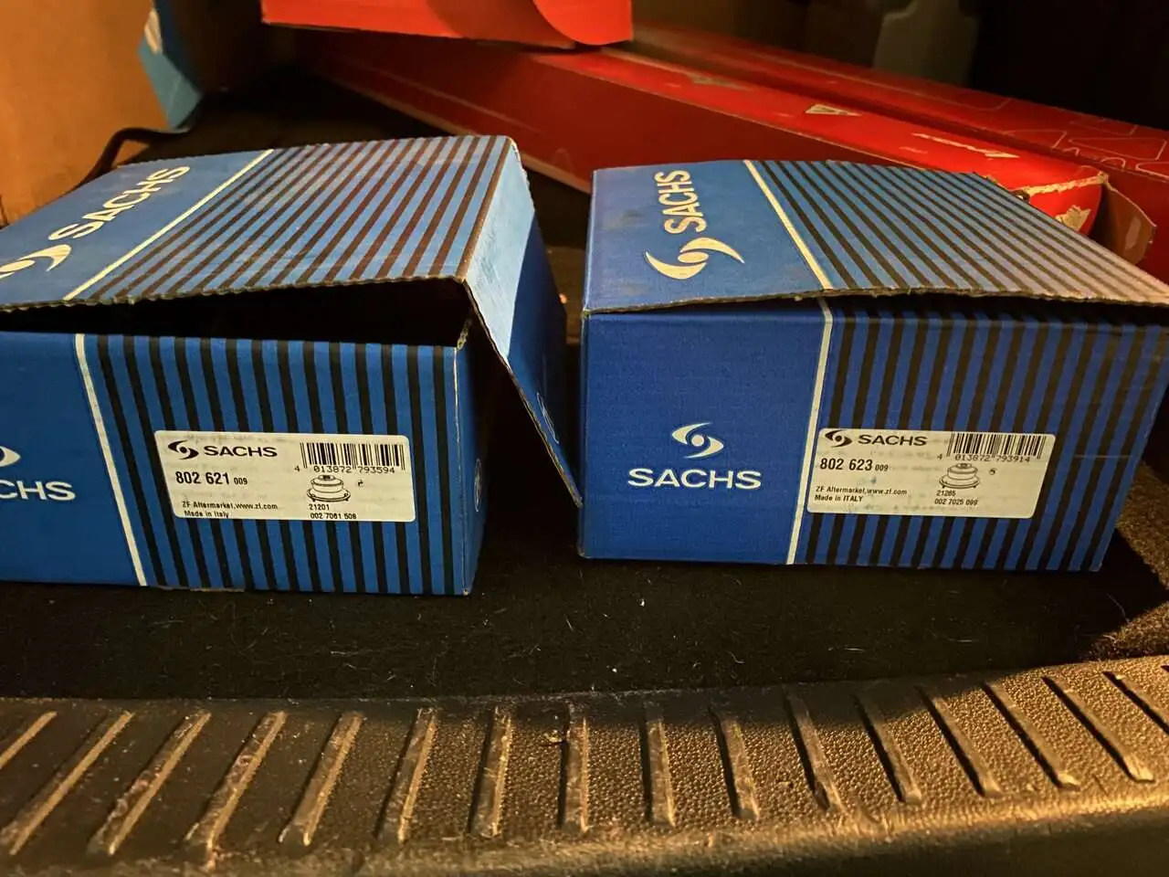

I originally went with Sachs from Rock Auto for the strut mounts. Figured that if the stock ones were keyed for LH/RH, I should probably stick with ones that were also keyed that way. So, I ordered the pair...
...but inside the box for the PS mount (left), there was another DS mount!
Wanting to get the car back on the road in short order, I overnighted another Sachs PS mount from Autozone. I got yet another box with the correct part number printed on the outside but the wrong part inside. 🤬
Figured it had to be a warehouse issue or something, and that I'd need to look elsewhere. The only decent-quality replacement I could easily get my hands on was a KYB – which doesn't have the locating pin, so can be used on either side. An Autozone near me had one, so I could get it same-day. So, now I have one Sachs and one KYB strut mount. #ShrugLife

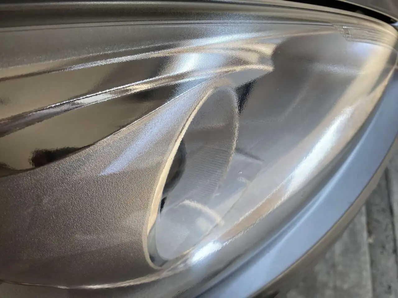

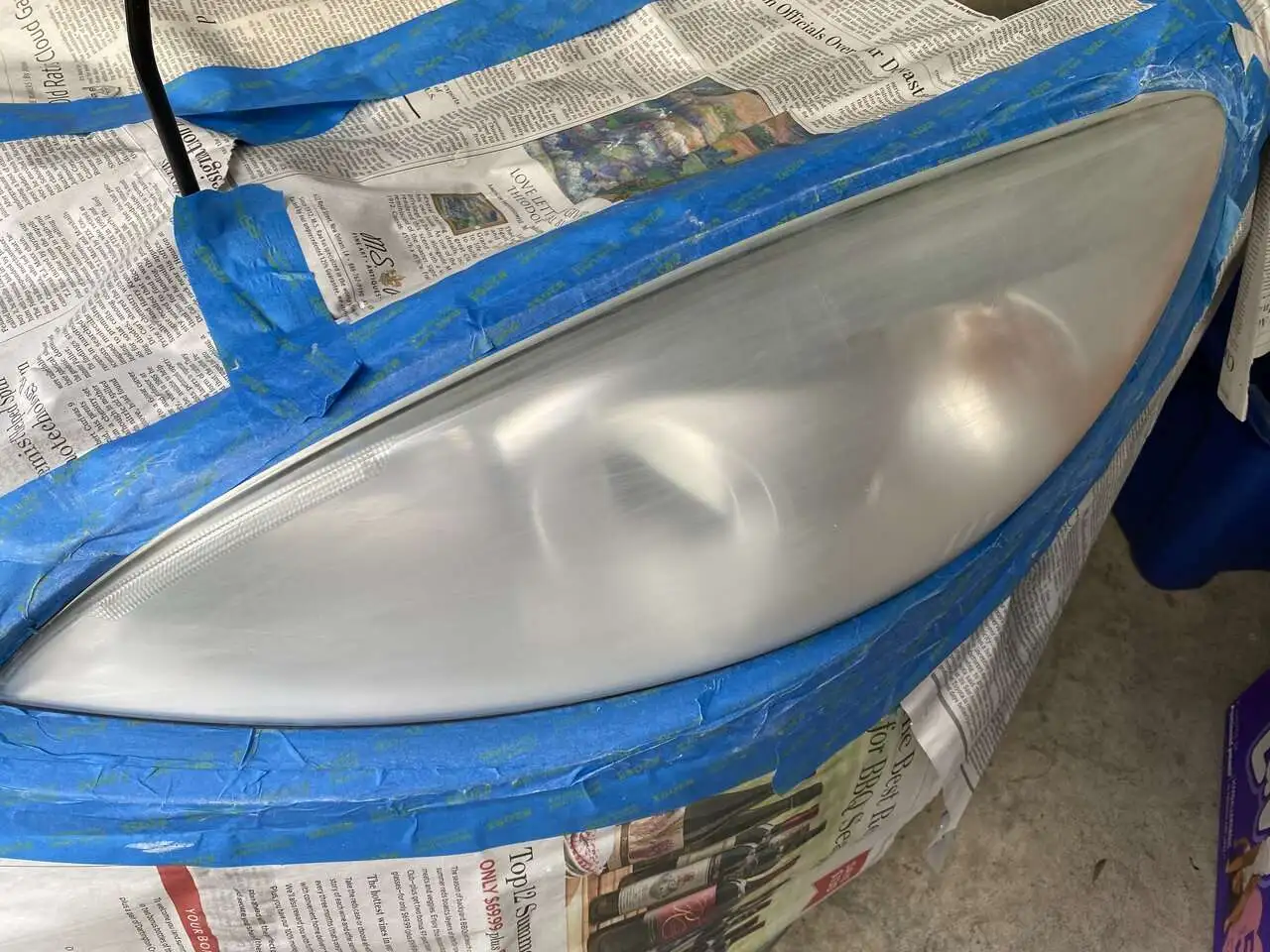

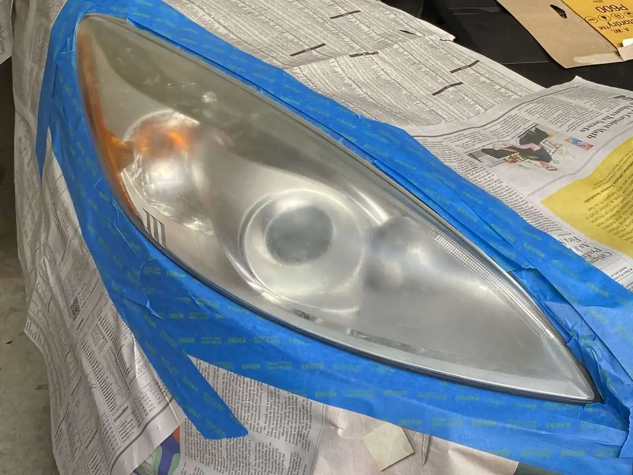

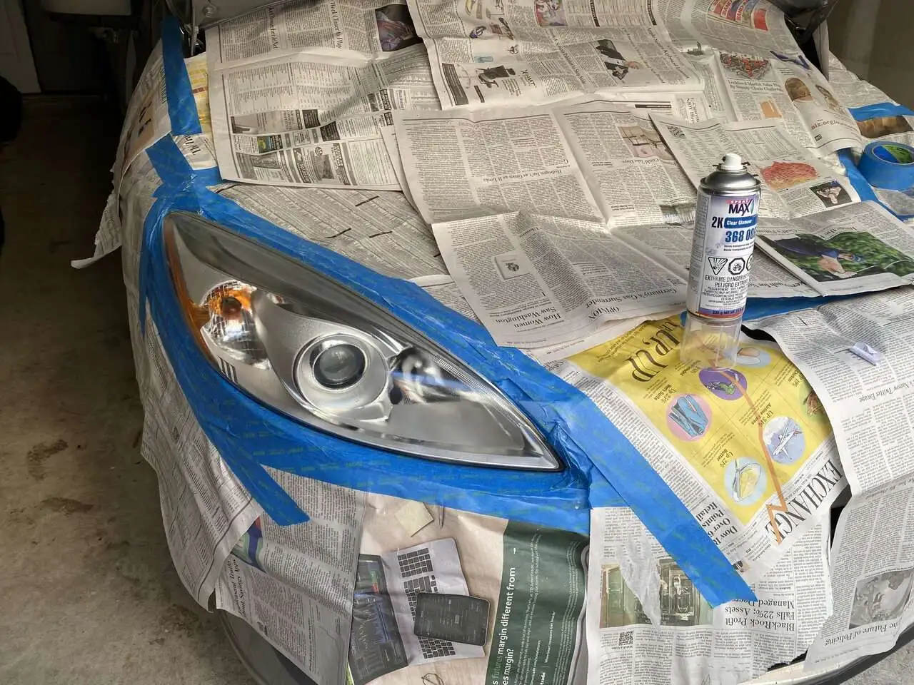

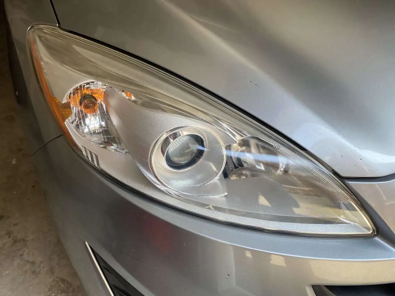

The eagle eyed among you will have noticed the cruddy looking headlights in the first pic I posted. I refinished them using the relatively simple method in this video as a reference: The PROPER Way to Refinish Headlights: E39 M5
Before:
During:
After:
Looks good in pics, but the orange peel is real:
...maybe because I didn't quite apply the clearcoat right.
Also, I know I didn't get all the fuzziness out because some of it is still there.
...But I kind of don't care. Does that make me a scrub? 😬

You can DIY the knuckle spreader tool buy using a scrap hex head bolt (larger diameter barrel) and grinding the tip to an oblong shape with flat ends. IF needed, use 2nd bolt to ensure it stays apart while you are working/jerking. Another member intro an easier method to simply insert the knuckle bolt in reverse and use a scrap piece of metal to act at the block to spread the knuckle -rock solid stability.

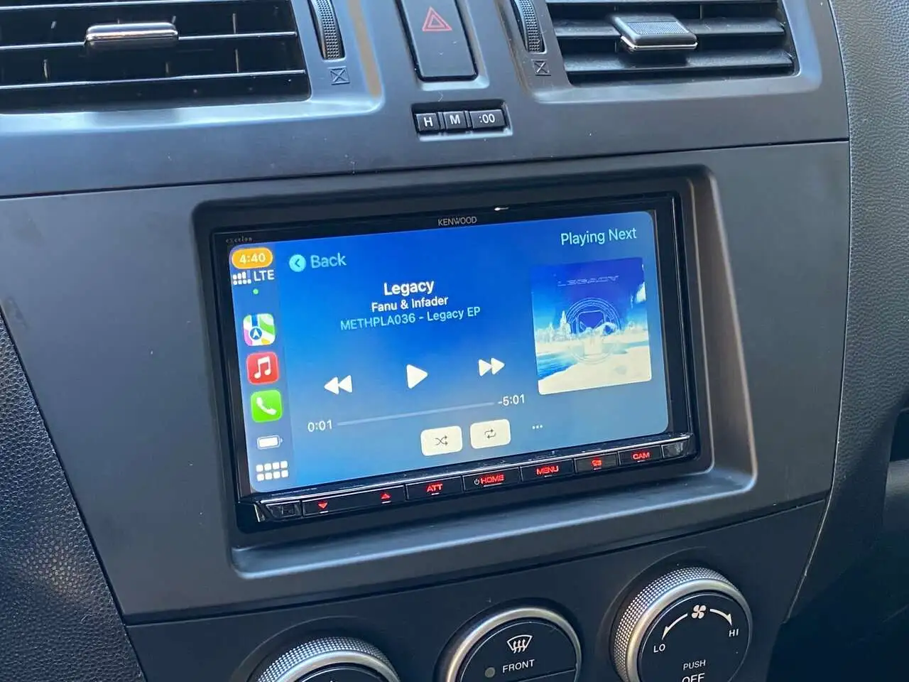

Kenwood DMX907S installed:
First thing on this car that I've had done by professionals when I could have DIYed. Not a fan of the money I spent, but a big fan of the results and time saved.
Already miss the volume knob. :ROFLMAO: So worth it for CarPlay, though.
Bonus: The radio tuner is better than the stock one, and of course so is the sound quality.
Those Kenwoods really are nice. That's what I run in my cars as well. Did you go with the Maestro RR for the steering wheel interface?
I did not, unfortunately. Wanted to go with what my installer was familiar with, and to control costs as this mod was already way more expensive than what I had hoped for (less expensive wireless CarPlay touchscreens were all out of stock).
Haven’t run aftermarket stereo in recent years, but kenwood excelon used to be my go-to deck. Good power and sound with lots of adjustments and settings. Are you planning to upgrade the speakers?
I'd love to, but there are a lot of other priorities now and in the near future. This car is taking more than I had anticipated to bring it up to my standards, and I'm planning a nice but large project of maintenance and mild upgrades on the M3 next year.
We'll see. Maybe I'll blow the stock speakers and use that as an excuse. :ROFLMAO:
