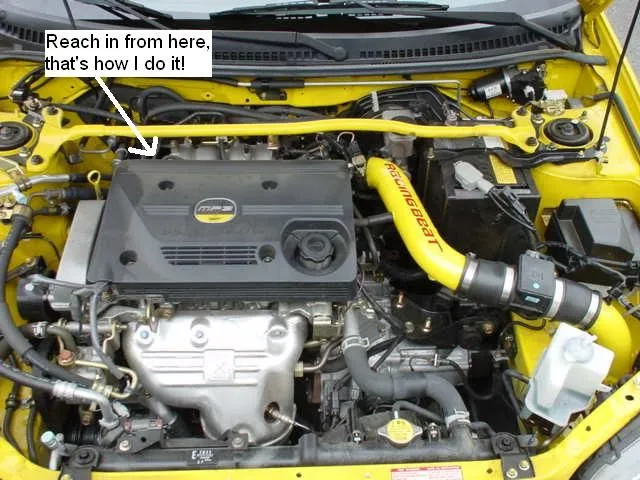

I can't take off the Oil Filter!!
MP3_PR5 said:
Not too far, it's in the middle of the engine about half way down, probably not even that far, hard to explain!
That's what I use, well not a glove but one of those jar openers; if you know what I mean. You can really get a good grip!!
You know what they say about guys with small hands....
They can reach the oil filter from the top:D
alexlitov - that was funny!
I really wish I could explain how I get to the filter from the top, but everything I've said before is about the best I can do. I see everyone thinks I must be full of myself or some kind of midget, but I just stumbled across it one day cause I thought I might be able to get to it from the top. You do have to reach in a bit, but not too far. I can do it, and I really don't see why anyone else wouldn't be able to do it, unless you got fat arms! Wait I finally thought of a way... Here's a pic!
It's about mid-way down under the engine cover. Hope that helps a bit more.

I think I figured it out, by your picture. Although our engines are the same, there seems to be a bunch of other "barriers" up in that corner on the P5 (which explains why those who have done it as MSP owners while we P5 owners have no luc). Unless a P5 owner has done it thru the top....either way..off to Walmart to buy some Rhino Ramps.
You must be refering to the cruise control drum.
As I stated earlier, I use the ramps cuz I have to get under the car. If I were to go from the top I would probably burn my arm on the HOT engine. You DO change it HOT, DONT YOU!!!(flame2) (laugh)
1244 (mspo)
I just figured out it's really easy to reach mine from the top! But that's cause I have a nice big first gen engine bay :D . It doesn't make it any easier, IMO, actually. I still like going at it from below.
