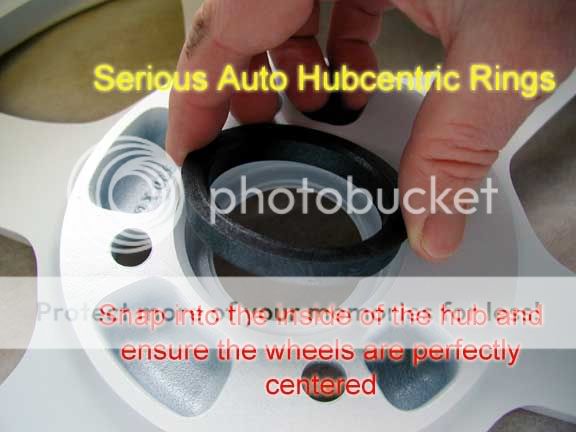

There are rings that you can get that will change the hub diameter of the wheel to match the hubs on your car.

I was told by a tire dealer that the hub rings can only be mounted on the alloys and that there is no room to put it in the steelies.

I have had hub rings installed with my steelies. They are somewhat of a pain to put on, but if you just take care, it is very very very possible.

Depending on the Mazda5 stock center bore compared to the center bore of the steelies, the hub rings might not be worth it.
