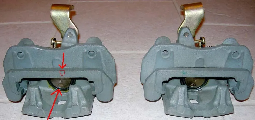

Ummm guys... My rear brakes did NOT look anything like the pictures. I did not have a piston rewinder behind a fake bolt. All I had was just the one bolt next to the one you guys claimed was a cap.
Instead my pistons had the indents on the face that have to be screwed in by a special brake rewinder tool. Forunately I have one for my 99 Jetta and it fit my calipers as well.
Am I the only one?

this how-to is specific to the ES/P5/MP3 and Japanese/Australian spec variants with rear disc brakes.... this how-to does NOT apply to the MSP and european versions, the pistons on those cars are retracted DIRECTLY from the piston themselves... thus also WAY easier to work on them!

Thanks for clearing that up, I didn't realize that and here I was following your directions! I still managed though. Your first link worked. I am posting the picture from that site to indicated the pistons.
But if you see the indent I am pointing at, there is another one just like it on the opposite side. You have to take this tool (http://www.premiertools.co.uk/cat156_1.htm) that has a round disk on the end of a shaft with two nipples on it and while applying pressure to the piston, twist CW. I can't remember if the MSP has a piston boot but if it does, just make sure that the boot is free from the piston by running a screw driver around the lip of the rubber.
But whatever you do, do not try to compress the piston with a C-Clamp, it simply won't work. It is threaded and the reason for that is so that when you set the park brake, it "winds" out until it hits the disc. I learned that the hard way when I first ran into these on my Jetta. I was cranking on that clamp for almost an hour!
