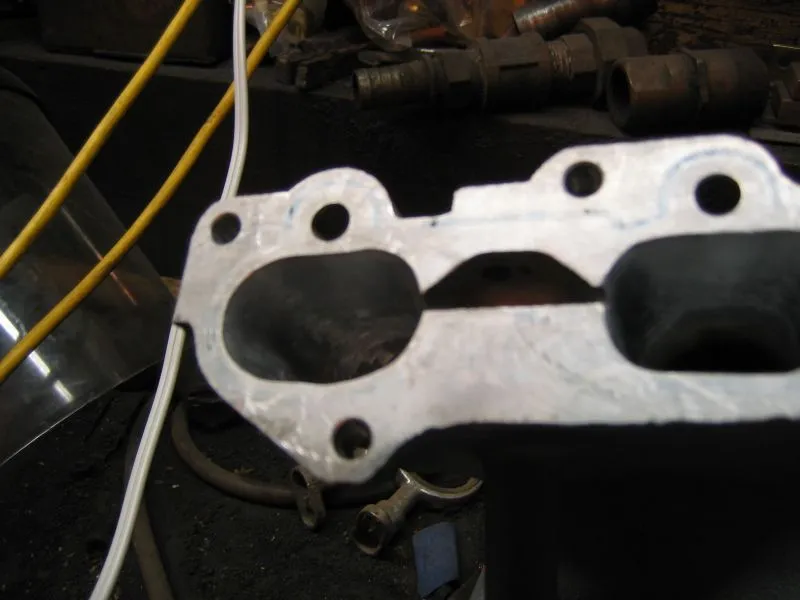

Why would you lose low end? the VTCS butterflies are only closed when the engine is cold, and when they are open they are a restriction in the flow at all RPMs. every bit of air has to go past the rod/butterflies.
