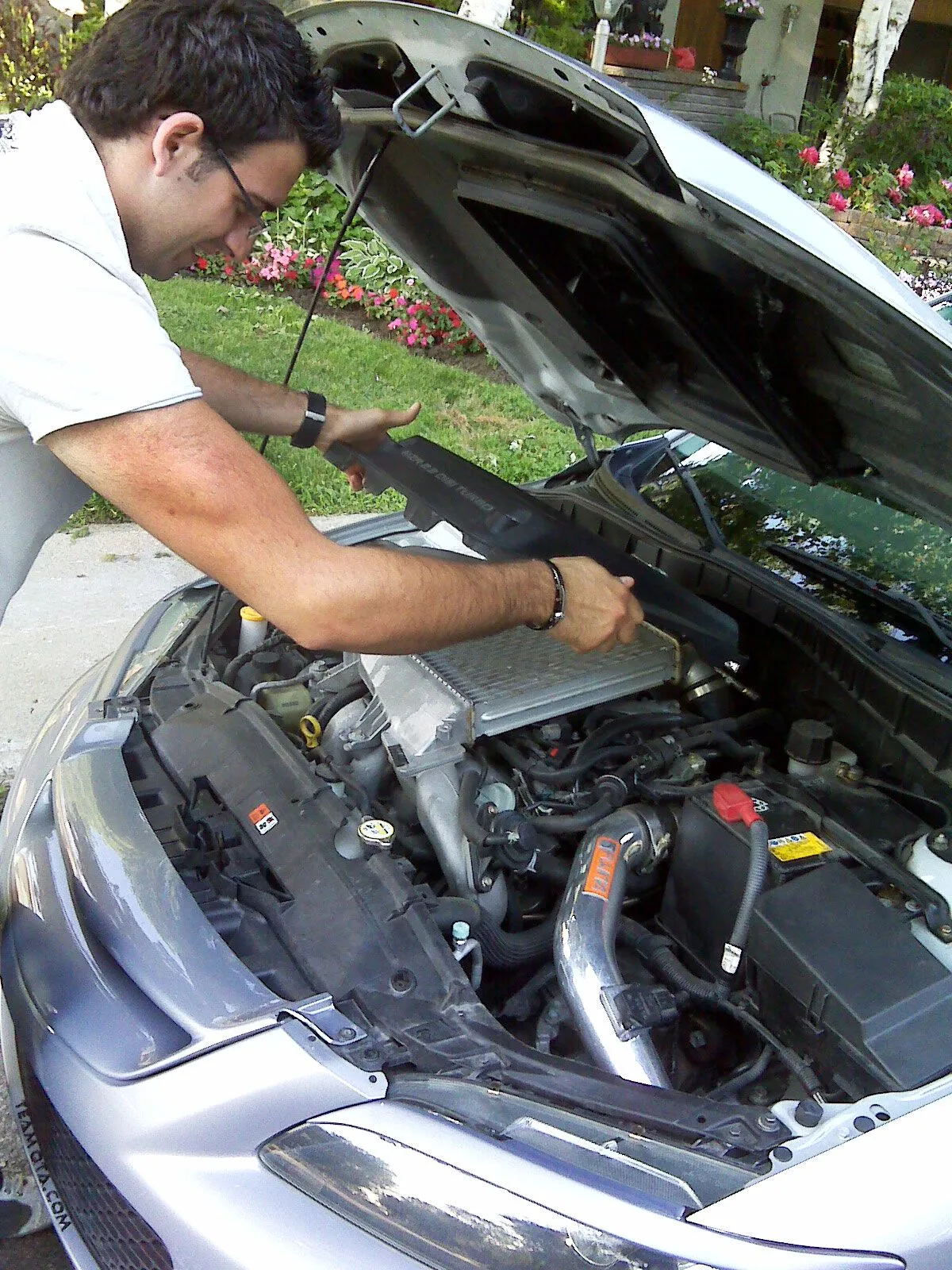

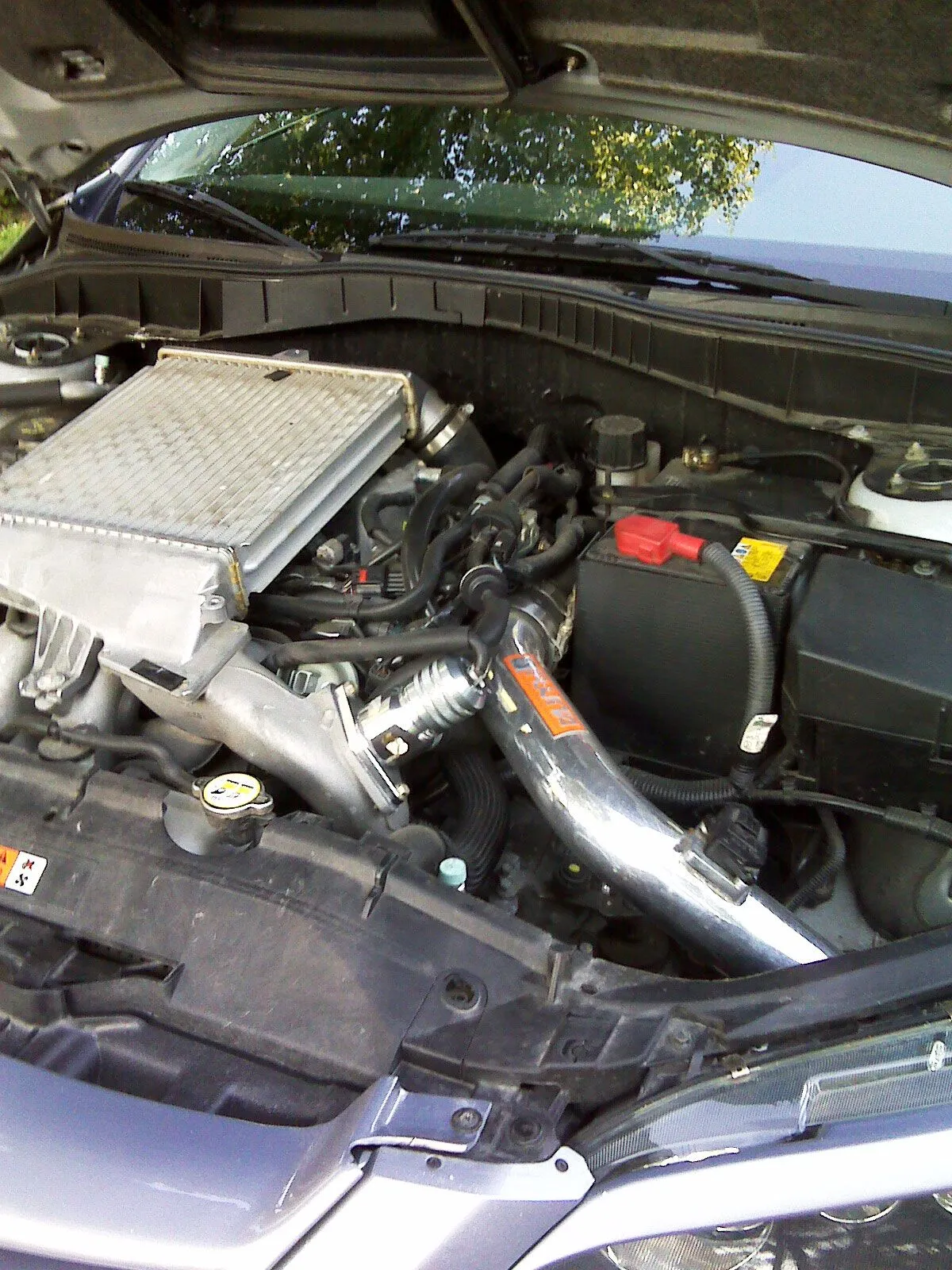

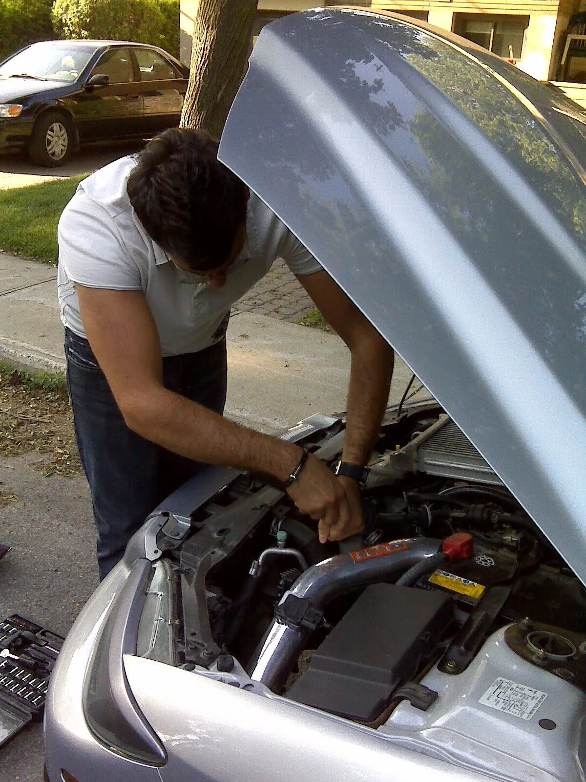

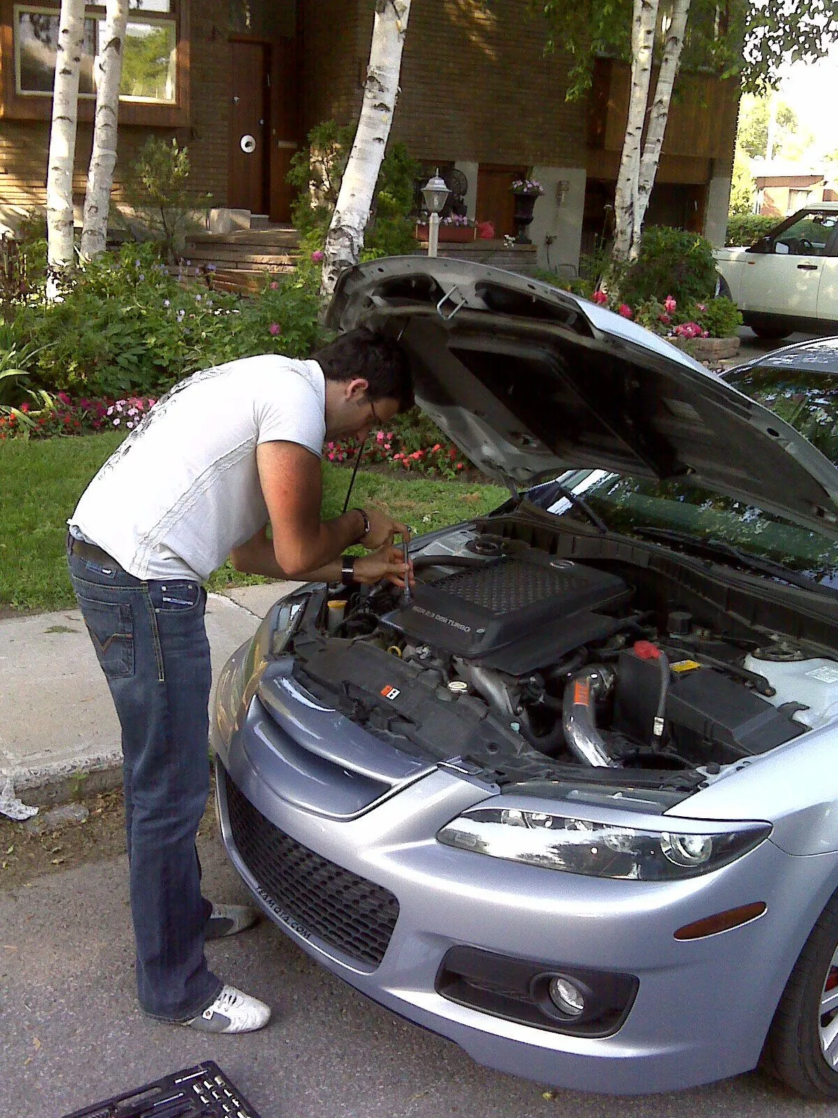

okay took me like 5mins to do but i took pics as i went along. thanks for all ur help guys!
