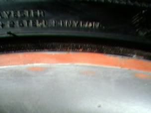

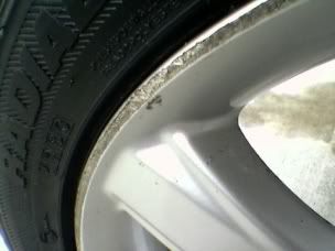

3) If you you have any curb rash, scratchs, corrosion, or chips on your wheels sand them with the 240 grit sandpaper, also give the whole wheel a good sanding. Here is an example of some of the bad spots on my wheels I will be fixing:

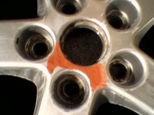

4) Now that you got the sanding done now is the time for the bondo spot puddy to fix those bad areas. Before you put the puddy on the damaged areas put masking tape around the edge of the wheel(I didn't do this and got puddy all over the tires, learn from my mistake). You don't want this stuff on your tires. The best method I used was to put a bit of pudy on at a time on my finger and spread a thin coat of the puddy on the damaged areas, if you put to thick of a layer on it will crack:
5) Now you will have to wait 30 minutes for the puddy to dry(if its warm out, longer if its below 60-70 deg. F.). After that take you 400 grit sandpaper and sand the puddy down to a smooth surface.

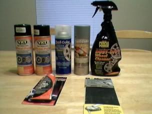

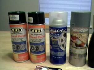

What you need:
- Wheel cleaner
- Wheel paint
- Sandable filler primer
- Wheel clear coat
- 240 and 400 grit wet/dry sandpaper
- Bondo spot puddy
- Deck of playing cards

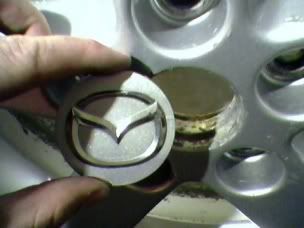

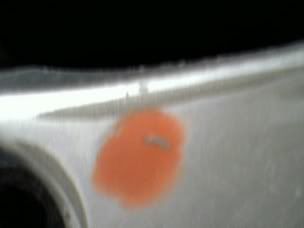

2) Take out your senter caps, unless you want those painted to:
