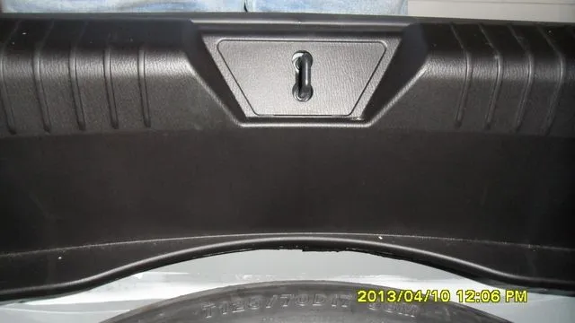

I want to put sound deadener in the trunk. I see how to remove all of the interior pieces except the long rigid plastic piece that covers the back of the trunk lip at the latching mech. There are two snap fitting on each side, but I can't find how to release the middle. If there is an experienced interior service tech that would offer an answer, I'd appreciate it. Can't hurt my wife's new set of wheels!

Just tug on it gently (straight upward and slightly toward front of car), you will feel where the retention is and the tabs will let go "one at a time".
