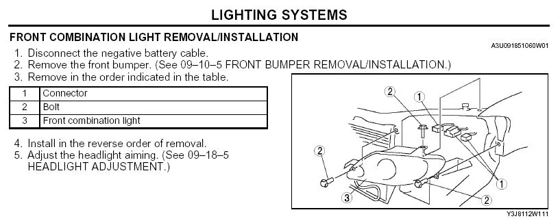

workshop manual to the rescue...
This was taken from the 2002 workshop manual:
:cool:
