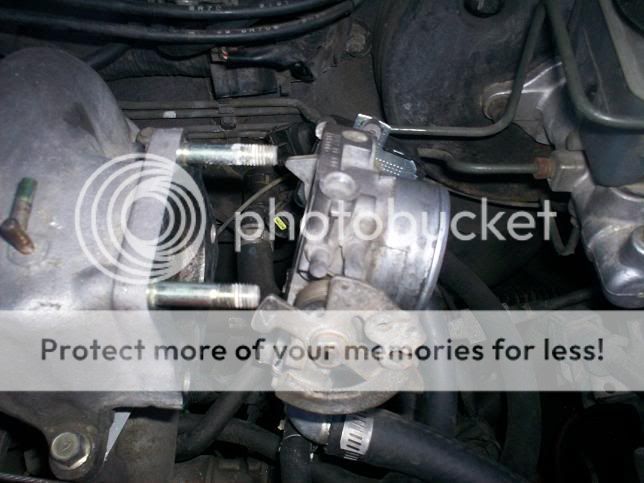

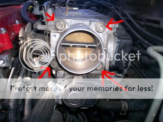

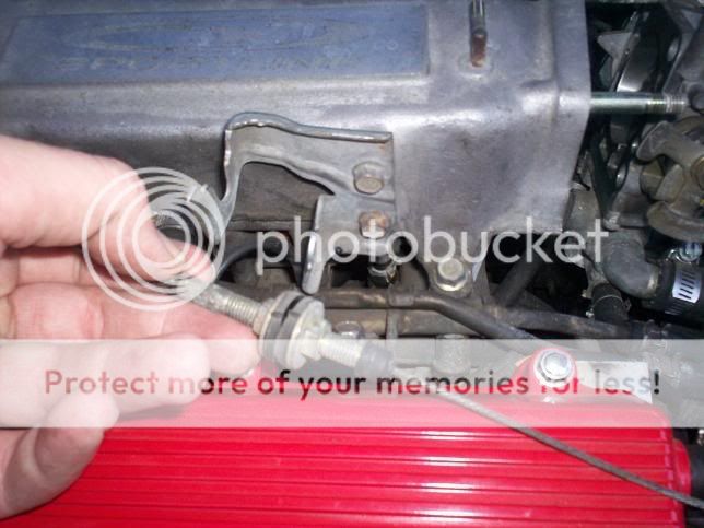

remove the throttle cable and 4 12mm bolts/nuts that hold the tb on. Remove tb assembly

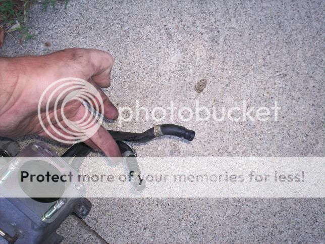

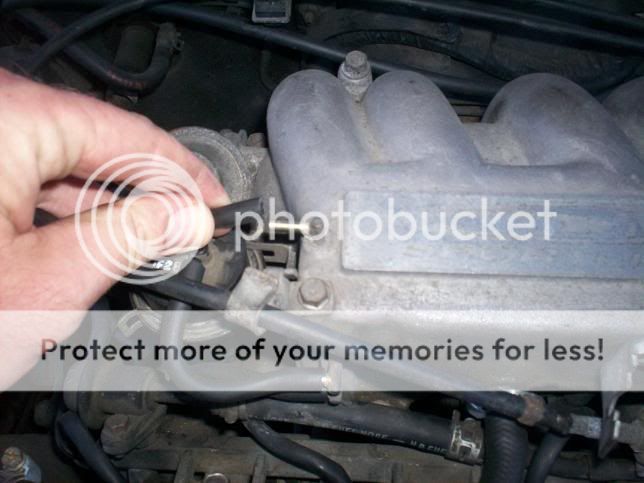

remove vacuum hoses
Remove pcv hose

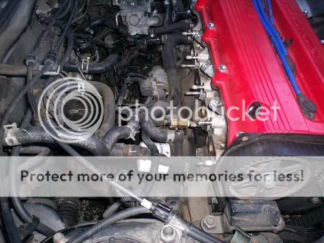

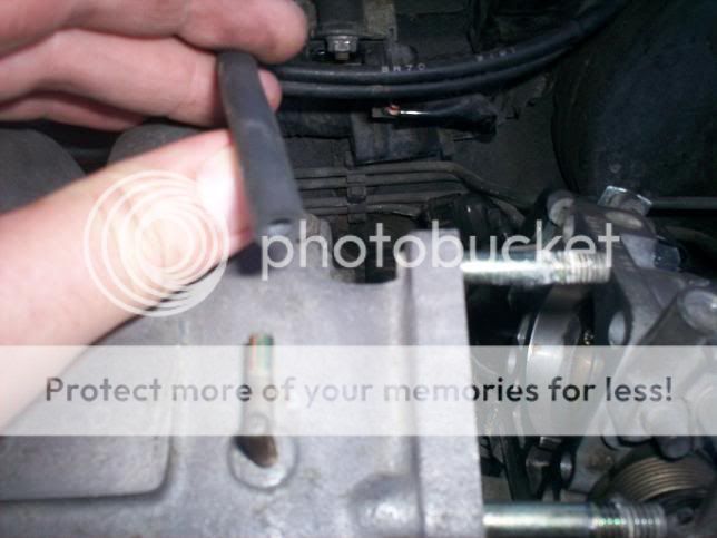

Disconect the 2 electrical connections going to te vic and fuel pressure solonoids

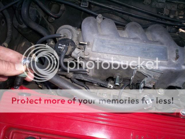

Remove all these 12mm bolts/nuts. There is also 4 12mm bolts on the bottom half that you have to remove to get the top half off.

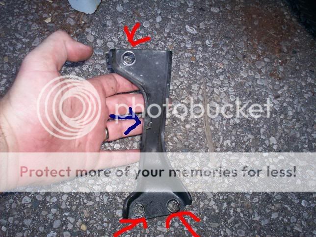

also remove this bracket while you're down there getting thos bottom intake manni bolts off. It's right by the starter.
Grab another

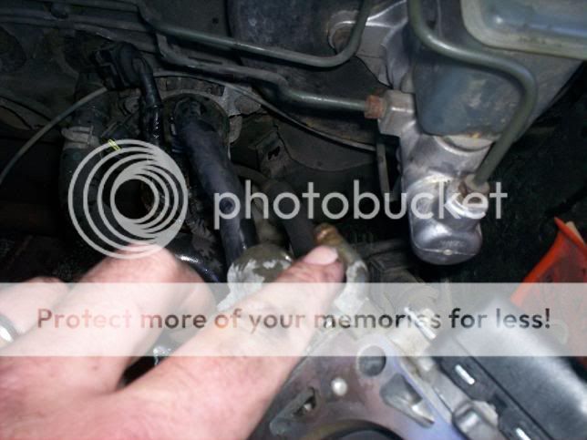

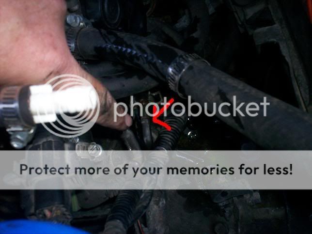

to get the top half free you must remove these 2 coolant lines.

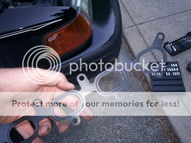

Now that all that is out of the way tak the old gasket out and drop a new one in.

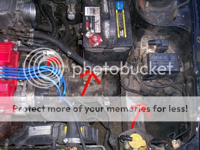

Just a shot of what you should be looking at when the intake manni is out. I never relized how much of a cluster fk it was behind there.

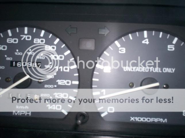

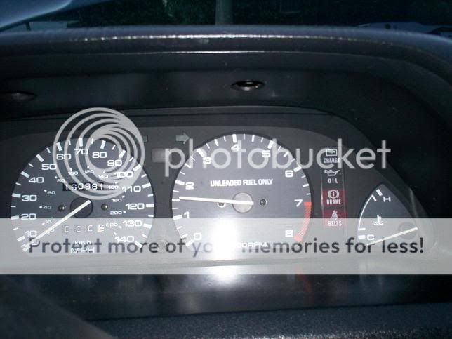

I had an idle issue for months and now with a cut bottom half and a very clean intake manni with new gaskets it idles like this.
COLD
warmed up
