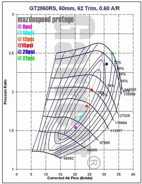

while using the same forumla except the specs for our engines, i used the turbo most similar to ours, the map for the GT25R
this is what i got...

Just did it up for my T3 60 trim, and right around 19psi it starts to fall off the effieicncy islands...
good stuff you should plot out the points on the compressor map if you still have it and post it. i know people would be very interested on that particular trim turbo as many run that one.
i did it for the gt25r and gt28rs but they not on the post above anymore... i guess i must have deleted the pictures or something...
using estimate numbers this is what i got for the Garrett GT2860RS aka Disco Potato....
