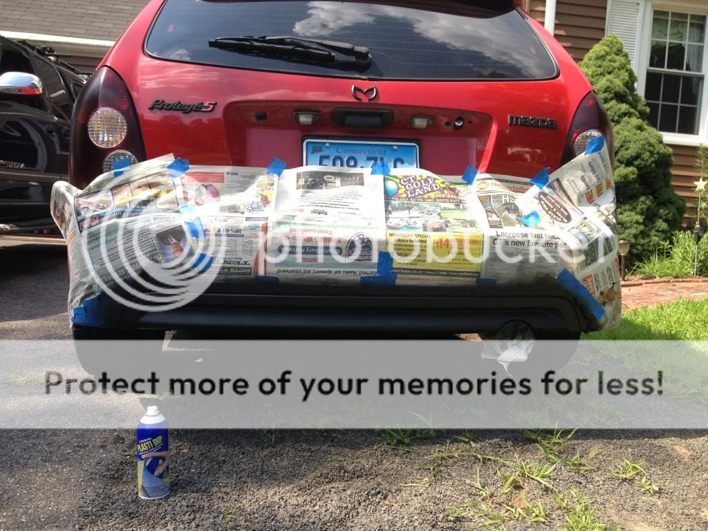

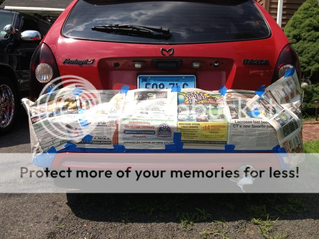

When I did my rear valence I used painters tape and newspaper. For some reason I didn't even think to pull off the tape before it dried, but even though I pulled it off after, I took my time taping it and used a razor blade/exacto knife as I peeled off the tape and it looks perfect. Might need a touch up in a few months I only did 2-3 coats
so, my friend, either try using a razor but be careful not to cut your bumper, or peel it off and re apply. taping is everything!

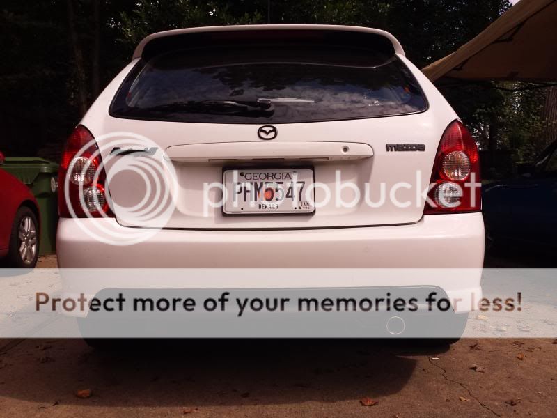

Went in with a razor and cleaned it up. I think it looks much better now. Also did the badges...not sure if I like the look will feel it out. Thoughts?
I like the emblems in Plastidip! B/W is contrasting nicely, and if you end up painting the trim strip as well it would offset everything nicely.
That's an OEM Mazda accessory you could purchase from the dealer, rear bumper guard. My P5 had one, I remember installing it after scratching the bumper when the car was brand new. Covered the scratches perfectly and prevented any future damage.
I like the black emblems, I rocked a similar setup years ago with my P5. You should look for a Mazda6 wagon wiper arm, that was one of my favorite mods.

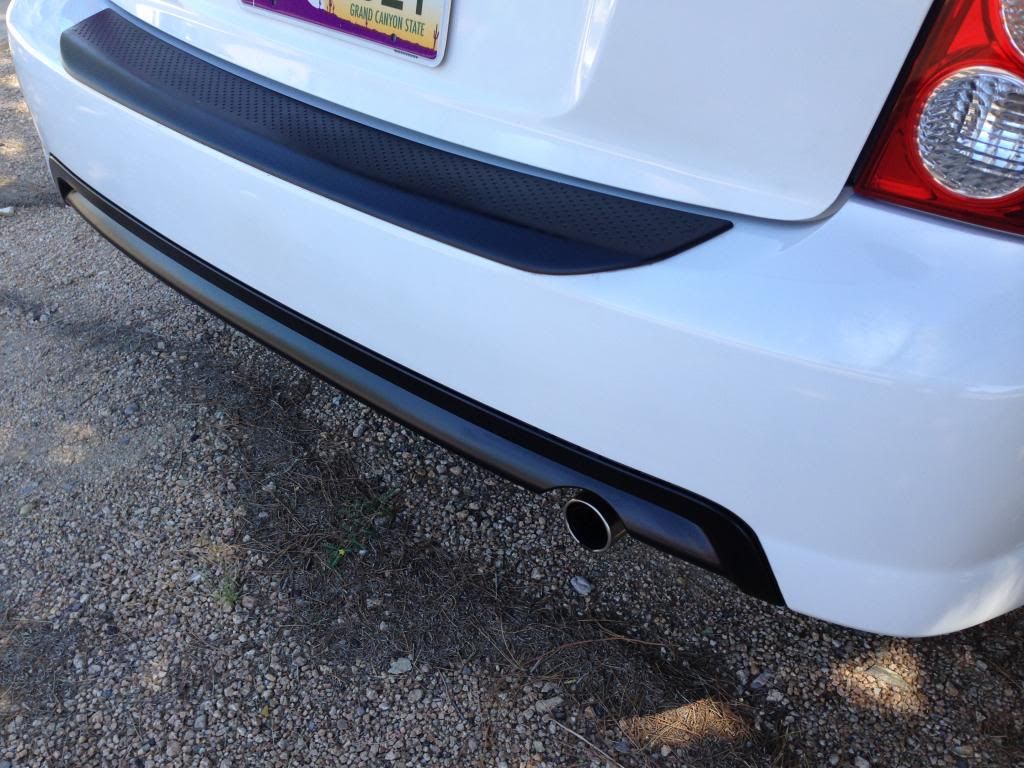

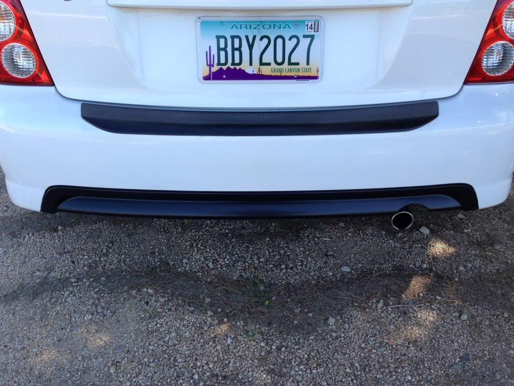

oh and i also found pics, this is how i did my valence. i wish i found these earlier for you
Before:
After:
