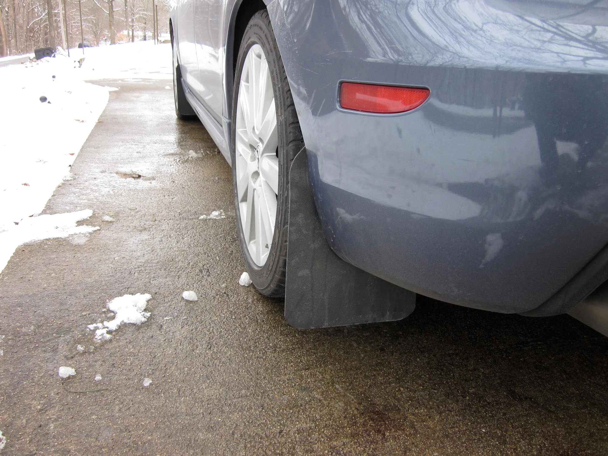

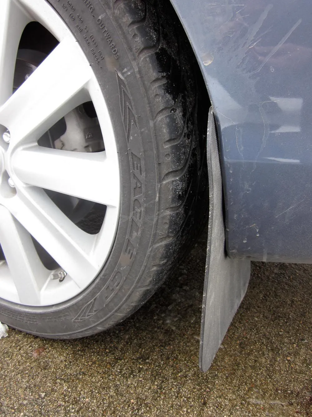

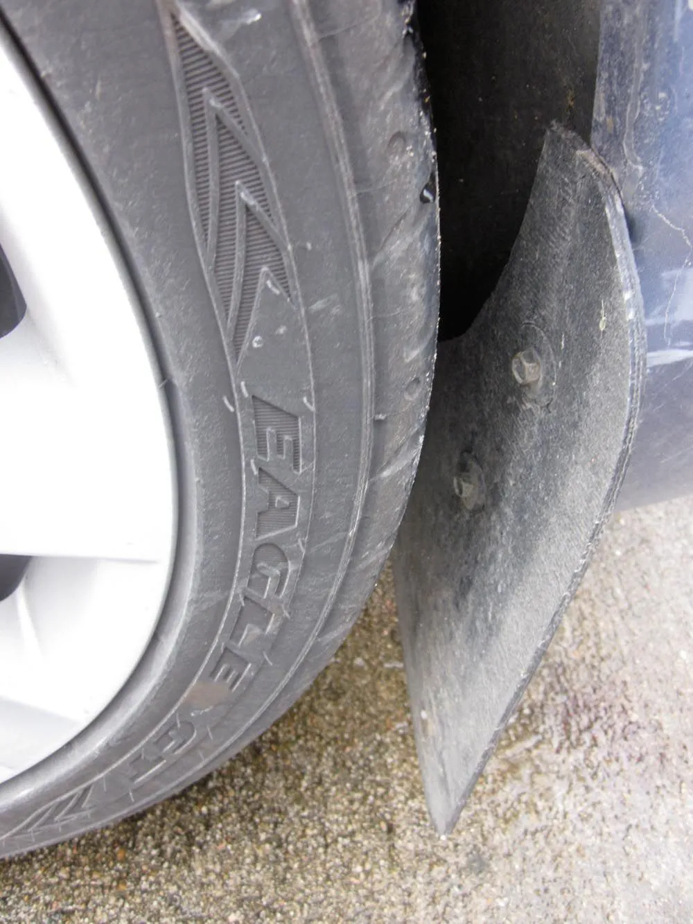

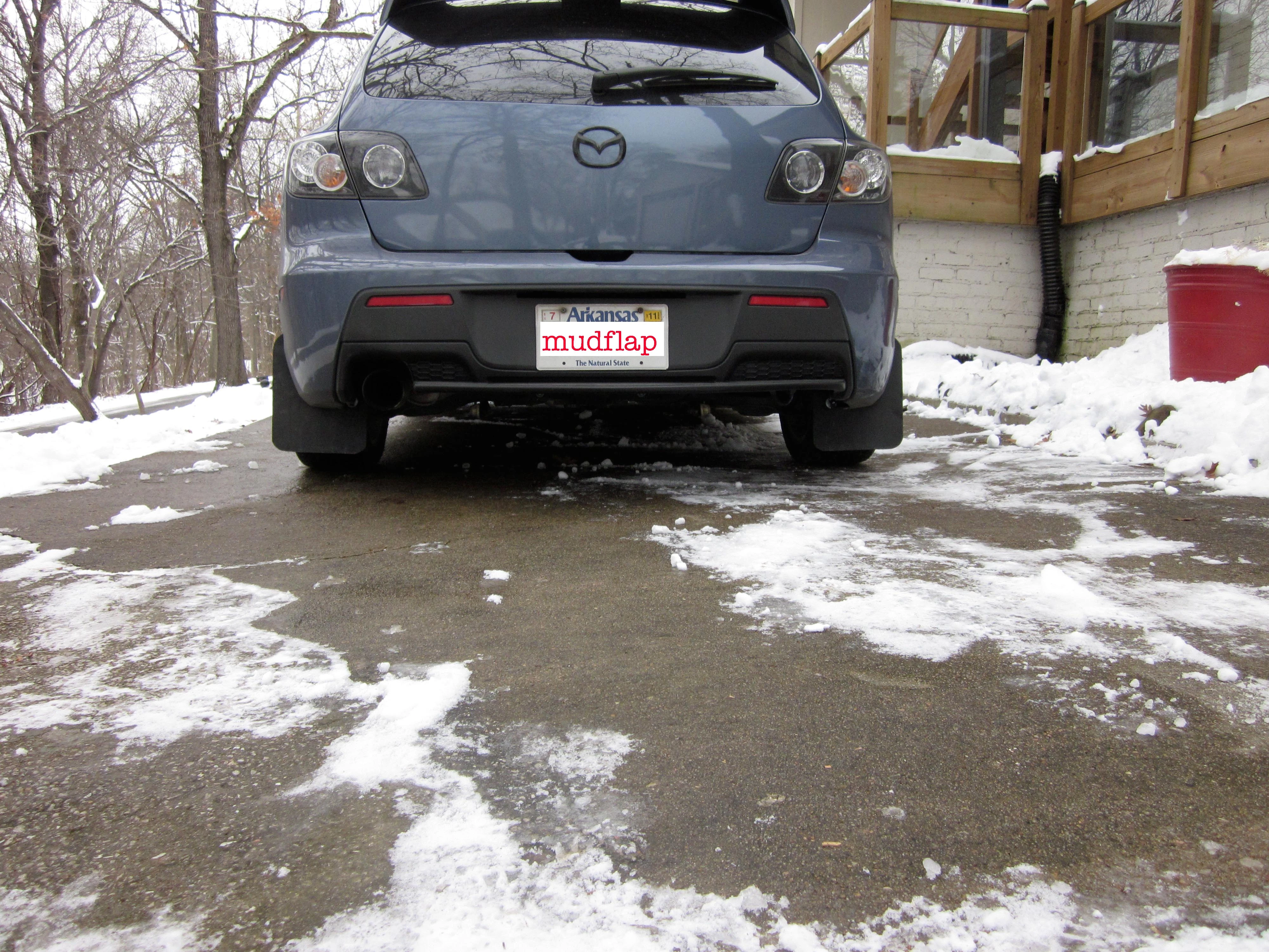

hey, i did this but changed the shape to be a bit more like RA. i also made mine out of conveyor belt i bought tractor supply co. it cost me $20 but will last forever. it is 1/8" thick and has a woven core with burly rubber on both sides. i felt it was worth finding a good material that would last me a few years and hold it's shape well. they've been on for 2 weeks now and still look new..

The pattern for the front and back flaps are the same. The only difference is where to drill the holes for the rear flaps. You can drill the holes anywhere you want to install the rear flaps because you get to decide where you want to drill into your rear bumper. For the front flaps, the holes are already there.
