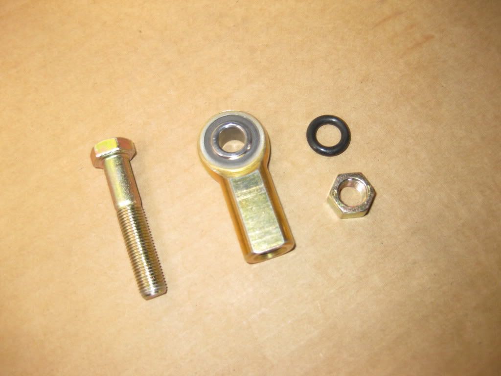

Parts from Mcmaster
$5.39 eachQTY 4 2458K341 Carbon-fiber Race Ball Joint Rod End, 3/8"-24 Female
Parts from Local Hardware Store
$0.12 each Qty 16 3/8 Rubber O-ring
$0.30 each Qty 8 3/8-24 (fine thread) nuts grade 8
$0.30 each Qty 4 3/8 lock washers
$2.00 Foot Qty 1 (36In) 3/8-24 (fine thread) Threaded rod Grade 8

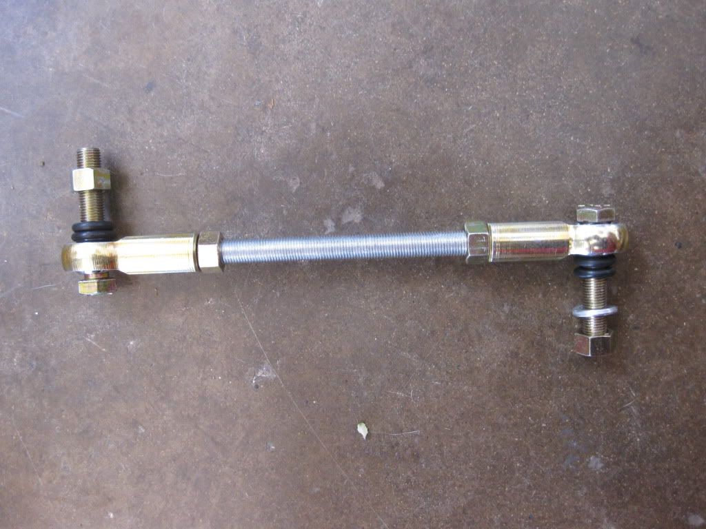

This is what it looks like assembled.
I ended up using two O-rings on the inner side because the ball joint was hitting the bracket.

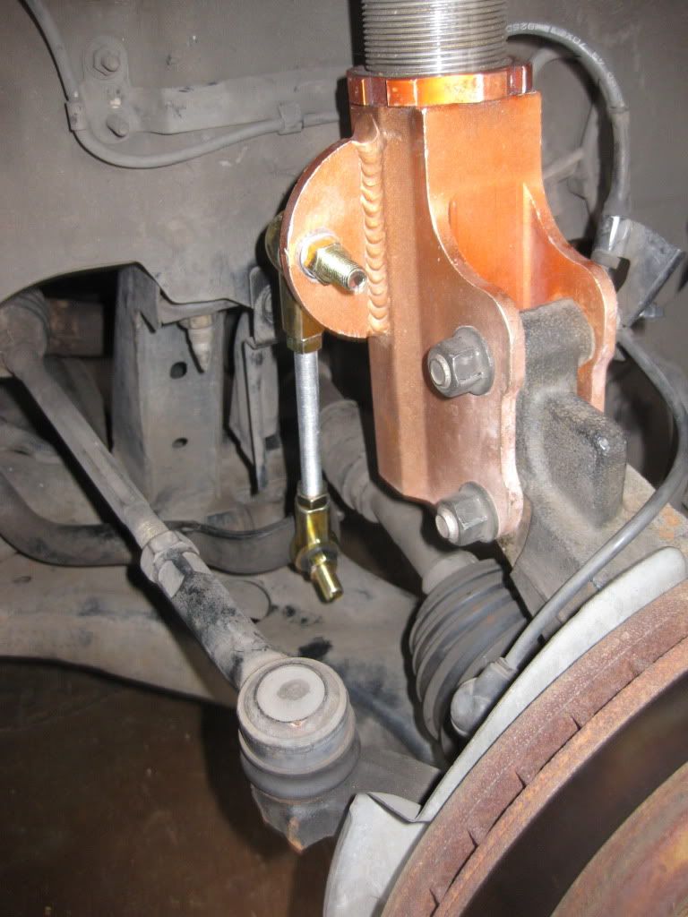

This is what it looks like installed.
Picture on the other side

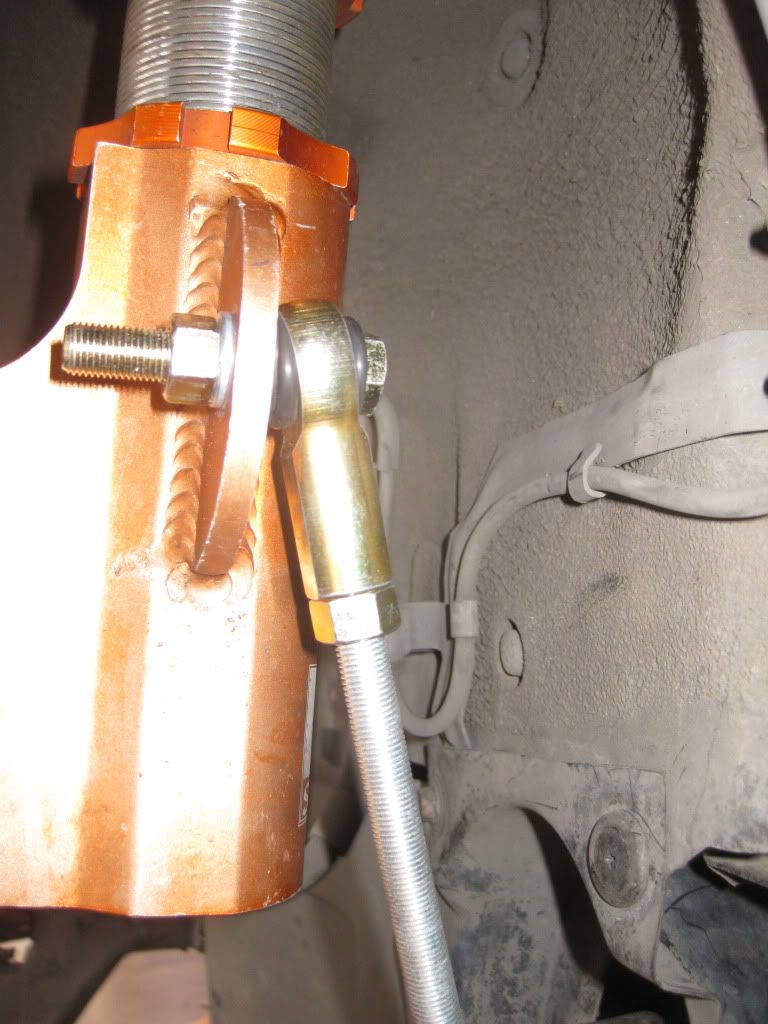

Close view of the upper

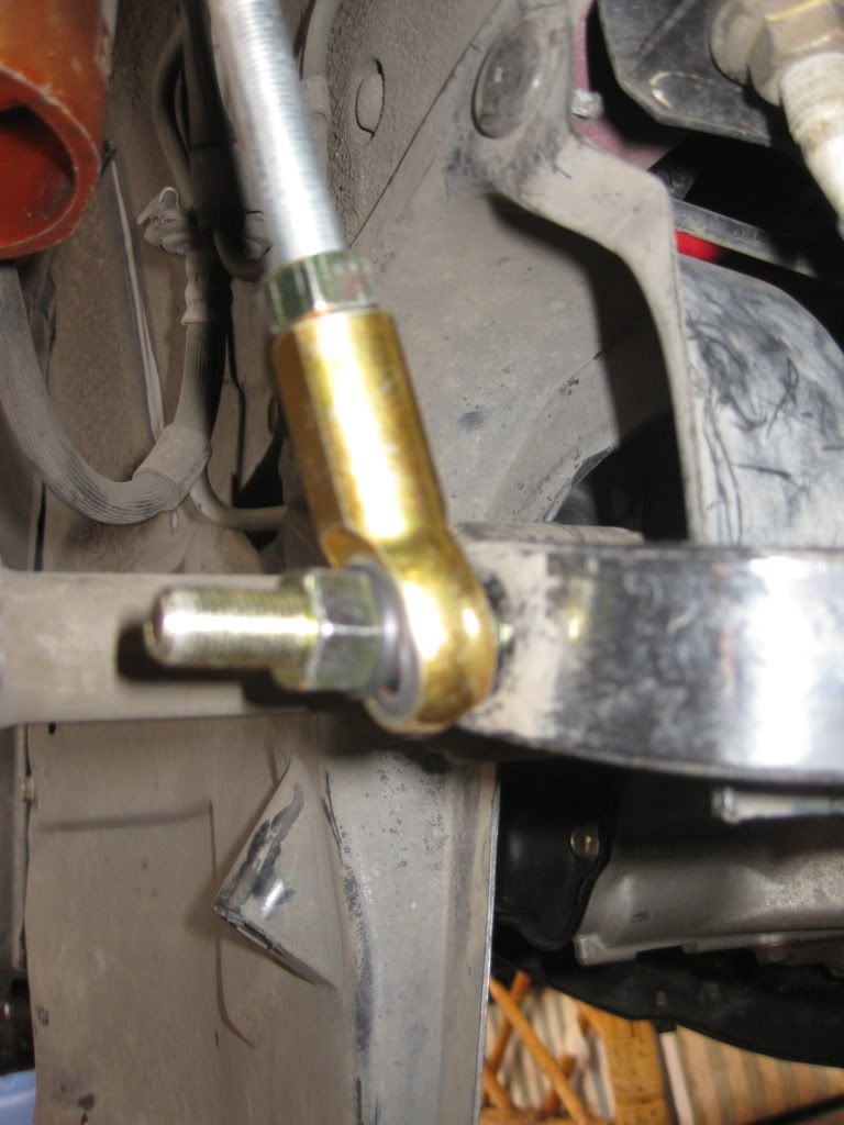

Close view of the lower

Very interesting. A couple of questions (could not determine answers from the pictures):
1. How much clearance is there between the threaded rod and everything else, especially the hoses which look like brake lines and the drive shaft? Any chance it might rub? Because if it did, it would almost certainly saw through whatever touched it.
2. How much does the end link move?
3. Please keep an eye on the rubber washers and let us know how long they hold up. Those things can last many years when employed in a constantly compressed state between two plates, but I suspect they are not going to be long for the world if they are flexed constantly, especially in a hot, gritty, and oily environment. Heck, in LA the air alone will destroy a little piece of rubber like that in just a couple of years. Did you consider using metal spacers (for instance, brass washers) instead?
1. The endlinks are no where near anything in that area. I did everything to try to see if there was any rubbing. donuts, s turns u turns going up ramps and even a slew of speed bumps. After all that It seemed fine. There was no damage to any of the surrounding pieces... (I wanted to make sure it worked before I made a how to...lol)
2. The endlink is a little tight but still moves. The specs on the bearing say 12 degrees of movement.
3. When I was looking at the AWR endlinks I seen a rubber O-ring that was in the same place. If anything I would try and get a urethane oring. (if they make it) If not I would just replace the rubber ones... The reason why i didnt want to use metal washers is because of rubbing.
