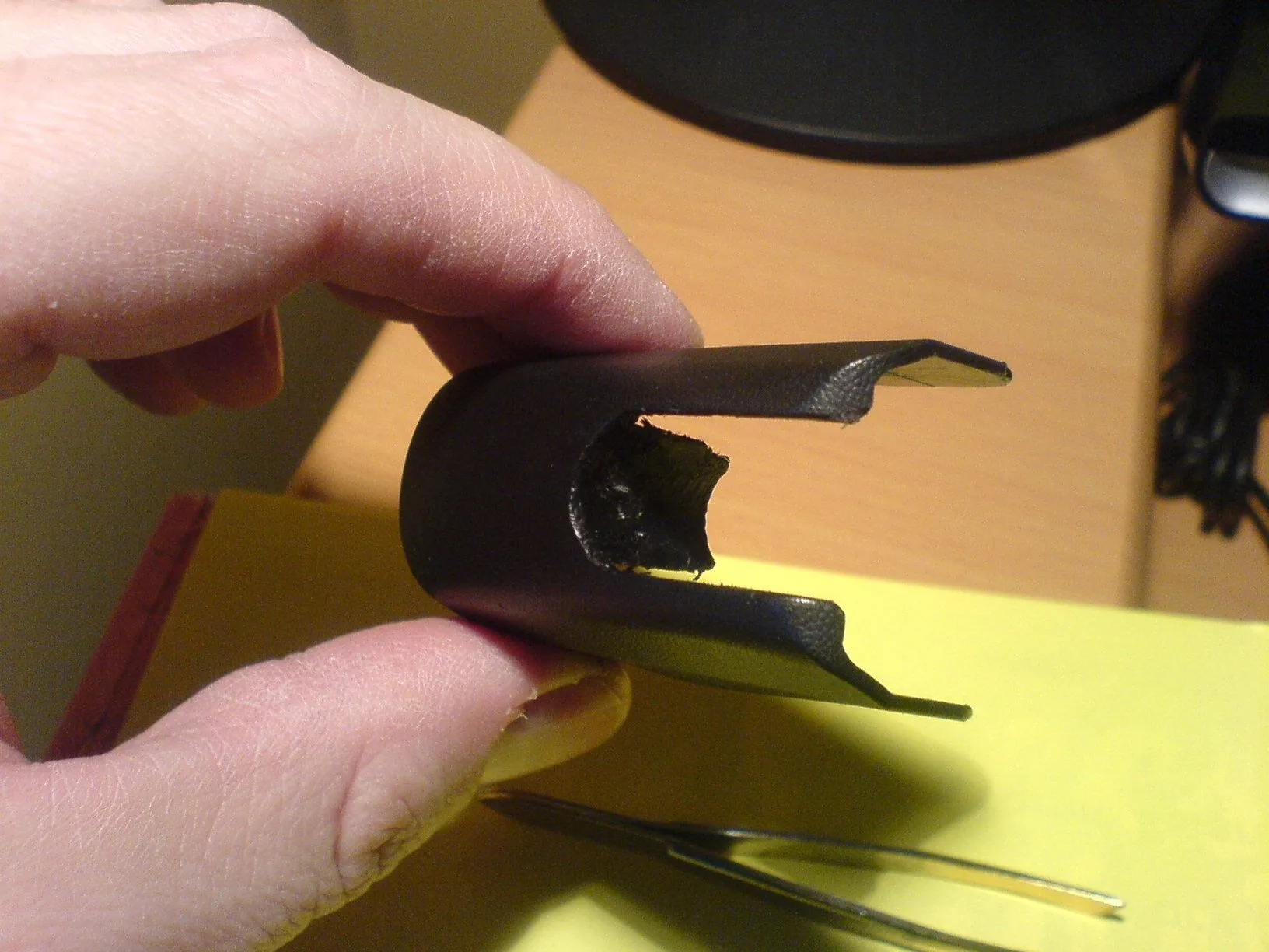

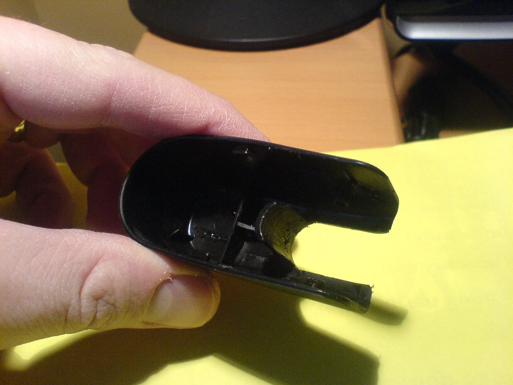

Modified nut cover pics
Here's what I did with mine . I used a flat file, but a rotary tool(Dremel, ie.) would be perfect for the job. I also filed the rounded base of the wiper arm that sits in this space( careful not to go too far with this, you don't want too big of a gap here, looks wise.

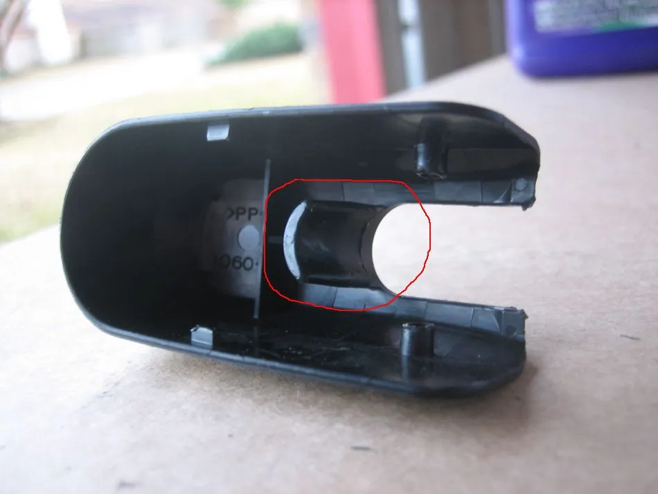

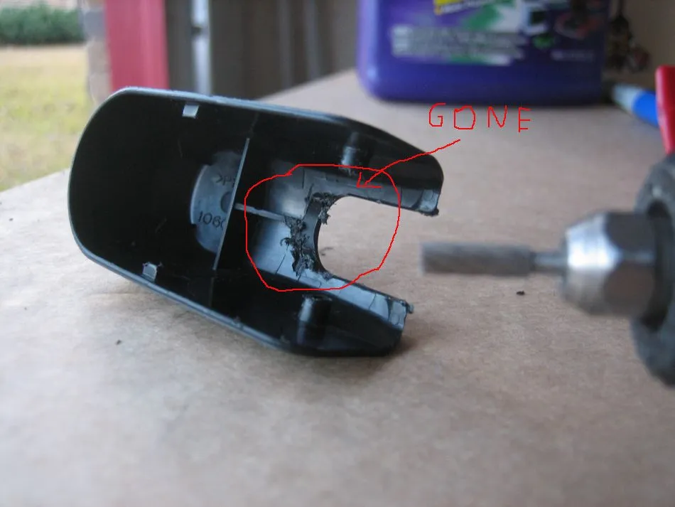

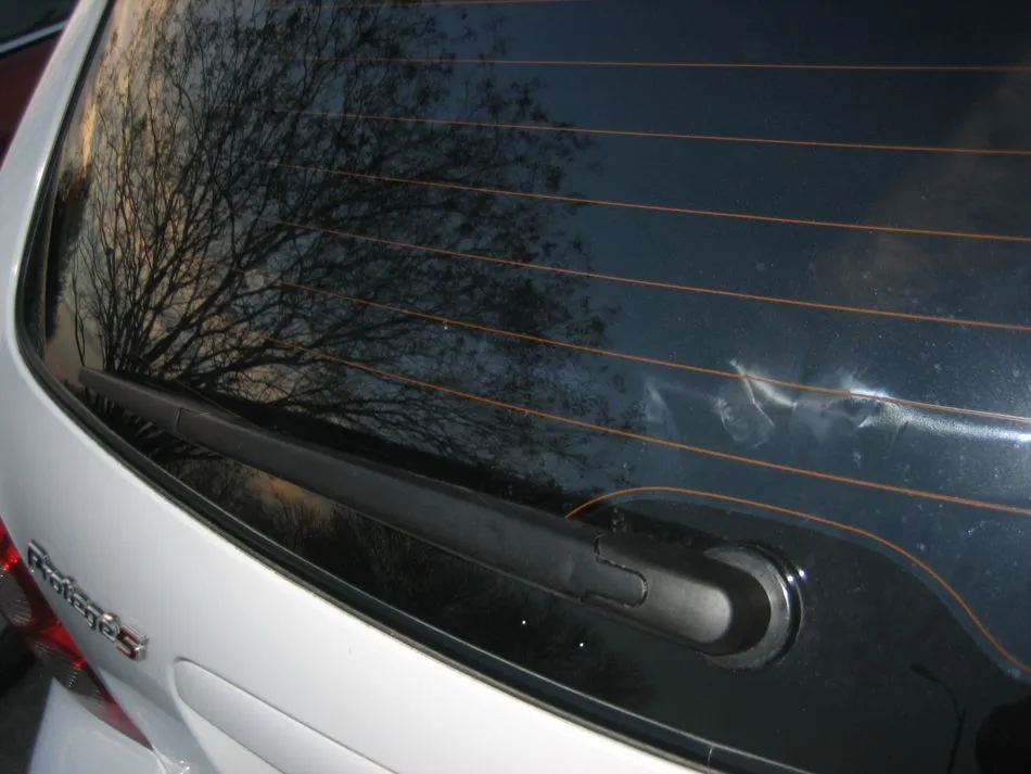

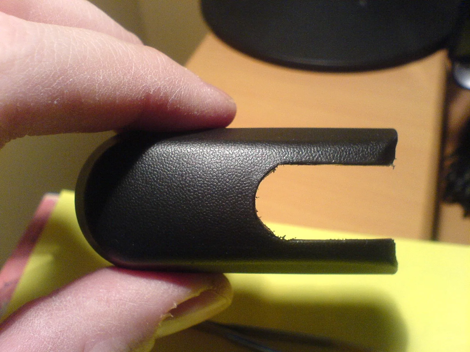

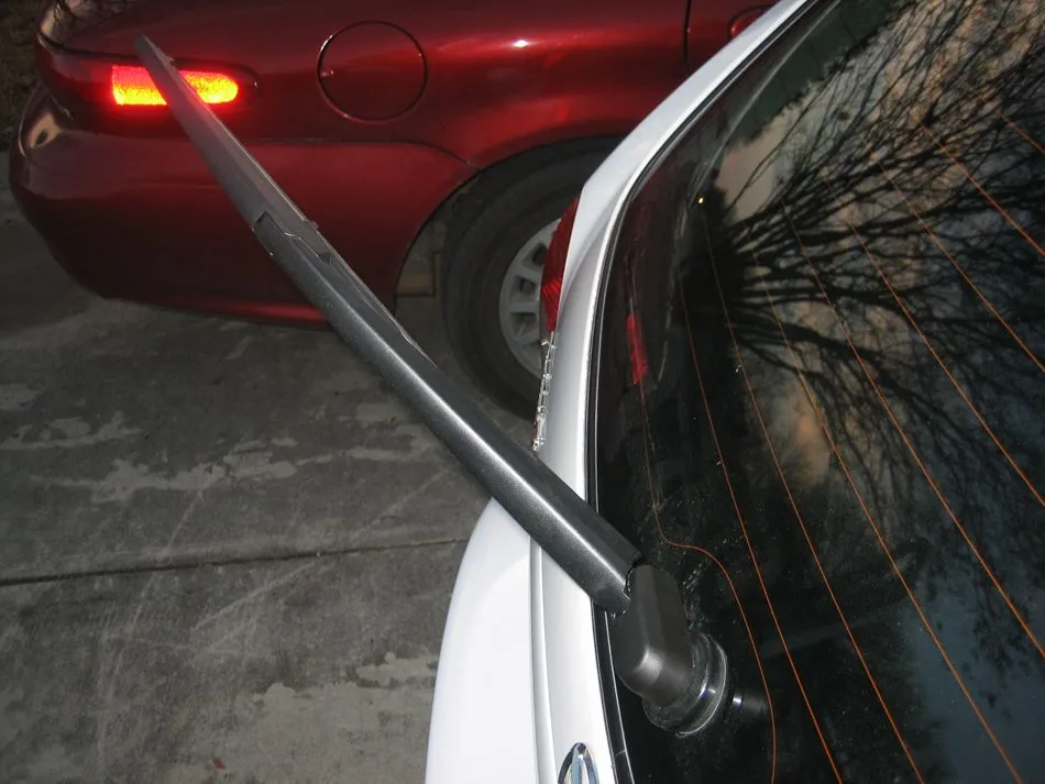

Hey, after you pointed out your post on the previous pages, I went ahead and modified mine and took pics. I just used a dremel tool to eliminate the tab. Just adding my pics to yours. . .
first pic = cover with tab intact
2nd pic = shows the tab ground down, (dremel tool in foreground)
3rd pic = rear wiper installed, normal position
4th pic = illustrating how the wiper may be now lifted up away from glass.
Rained today..got to try it under real conditions. No problems! Great mod.
--jason

looks good,man. Hmmmm, never thought about grinding that whole tab right off, hope it doesn't affect the overall integrity of the piece or allow it to fall off too easily. Oh well, it's only worth about 2 bucks anyway, no biggie if it does break/fall off, huh?

Just used my fingers to bend that tab, and it breaks right off. thanks
