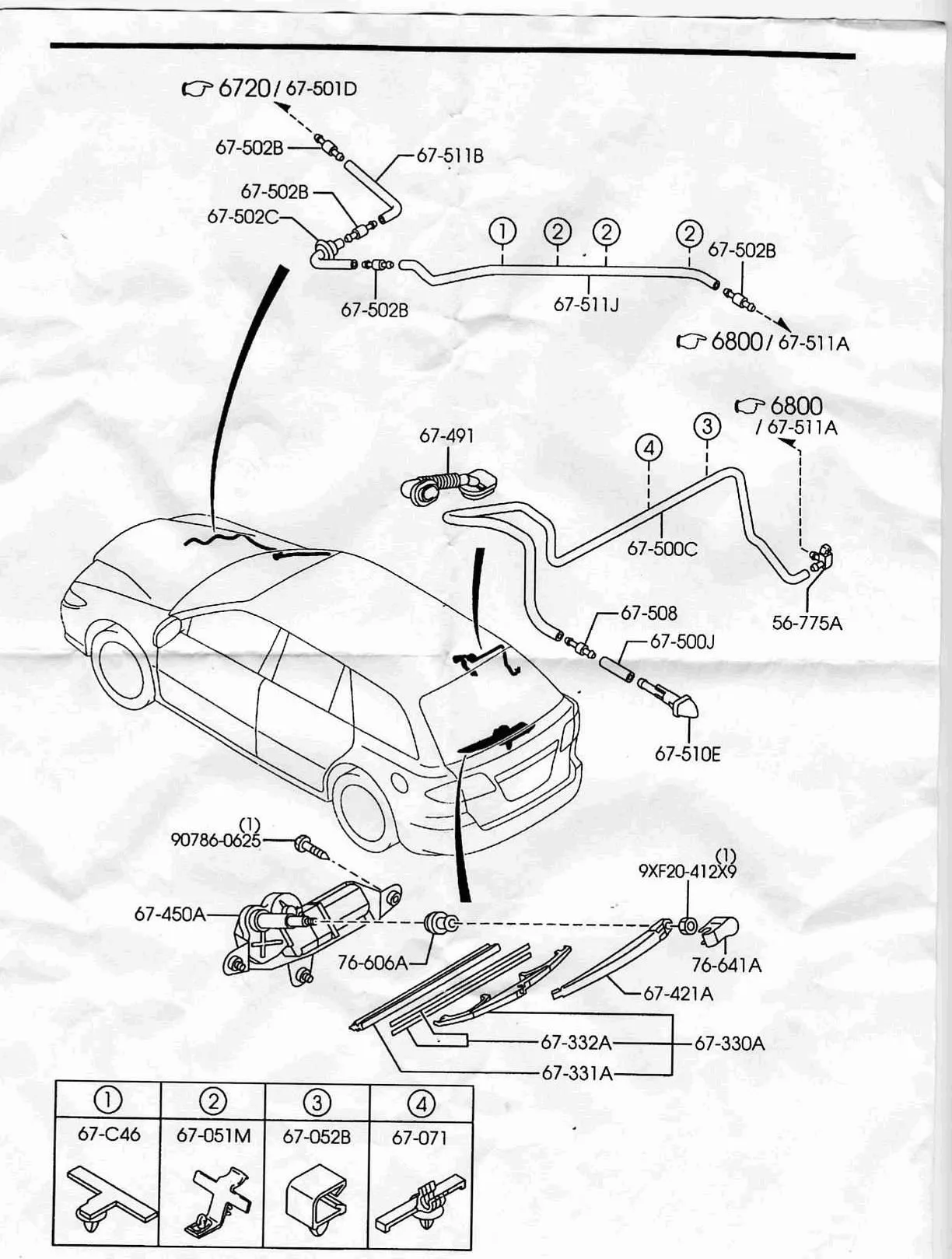

okay, here's the deal...the damn cover doesn't come with the wiper arm??? anyway, i ordered one it should be here tomorrow. for you information, here is the parts list for this mod.
arm
cover
wiper blade

Mark, did you get your 'kit' from onlinemazdaparts.com? That is where I bought mine and the cap was included and if I remember correctly the cap was $1 thru Jason.
na, got it from my local dealer...i got it tucked to me fo shua!(glare)
