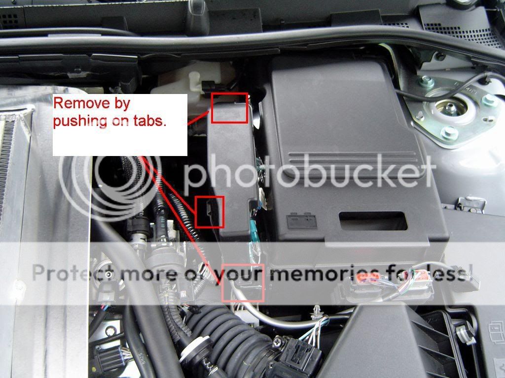

First, remove the harness cover seen here.

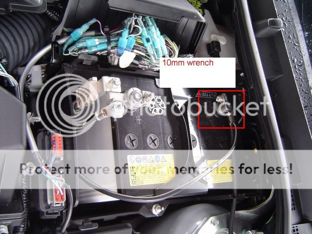

Then remove the battery cover.
Disconnect the Negative (-) side and tape it out of the way. I am extra careful because I hate electricity and actually covered the terminal with tape.

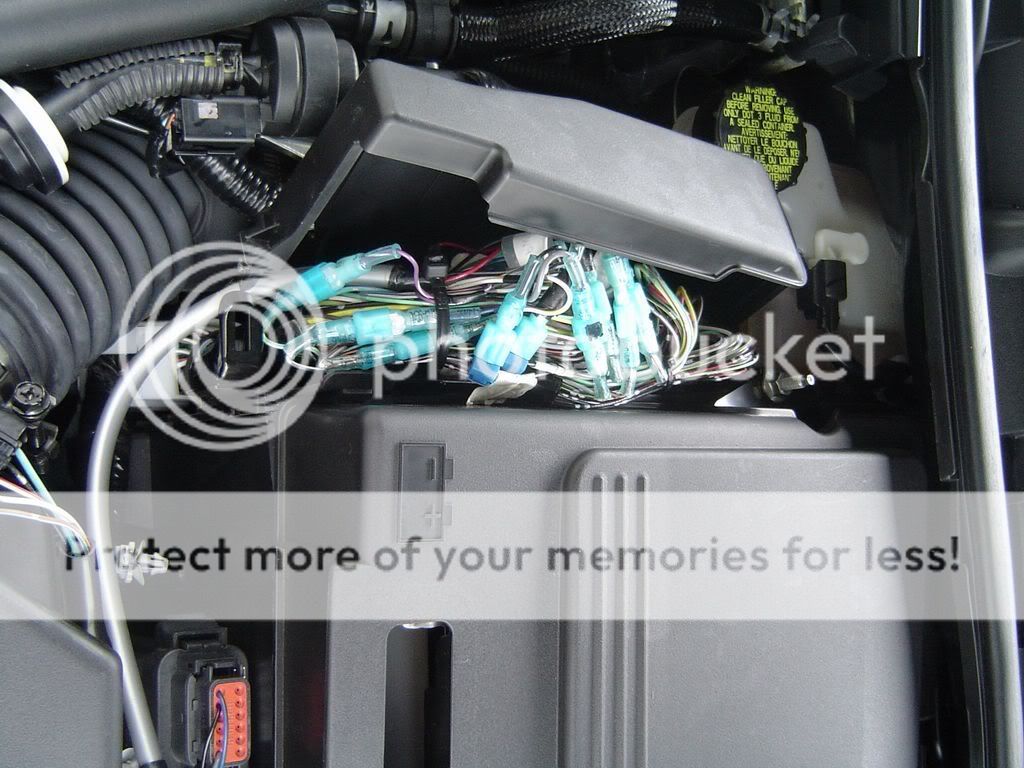

once you have all your wires crimped, use a soldering iron or mini torch (be careful not to hit the other wires) and hit the heat shrinking to insulate your crimps.
All the spade connectors (male and female) and the three wire taps are all supplied by BEGi as well as a bunch of zipties.

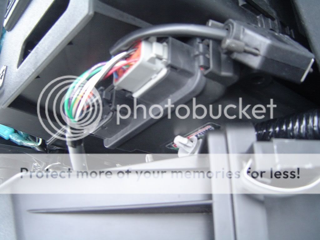

Then, plug in the harnesses to the XEDE unit, black to black, gray to gray.
start zip tying and decide where you want to stash away your XEDE unit.
I was just barely able to put back on the covers on both. If I had taken a little more time, I could have done a better job and chose to cut the wires further down.
If you take a look at the pictures, it looks almost stock. You wouldn't be able to tell unless you knew what you were looking for.
