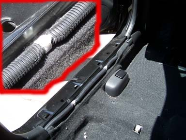

What gauge wire are you running? I was able to sqeeze 4ga beside the factory wire loom. I just zip tied it to the factory wiring every 6-8" and the door sill popped right back on afterwards.
If you are running 0ga or really need to get under that carpet you can just cut the white clip. Replace it with zip ties afterwards.
On the passenger side, I sqeezed 2 CeNet cables, 2 optical cables, and 3 pairs of speaker wire...

For running wires under the seat, I just ran them to the pilar panel and then slid them down from there without lifting or cutting the carpet. I have my CD changer under there. I wrapped the wires in loom like you see in the photo so it looks factory. Unless I pointed it out you would never see it.
