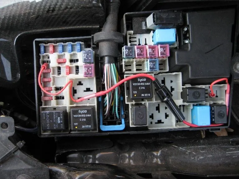

jam asian85 .... I was thinking of trying out the independent fog light mod you posted with just running the wire through the fuse box under the hood next to the battery, and was wondering how big a fuse I shoudl use....u think 10 amps is good? or should I run 15? or 5?
nevermind, I just took the chance with the 10amp fuse and hooked it up, took 5 minutes to connect the wires and stuff to the in-line fuse holder and spade clips, but other than that, such a cinch. Picks will be up tomorrow once I find my camera......

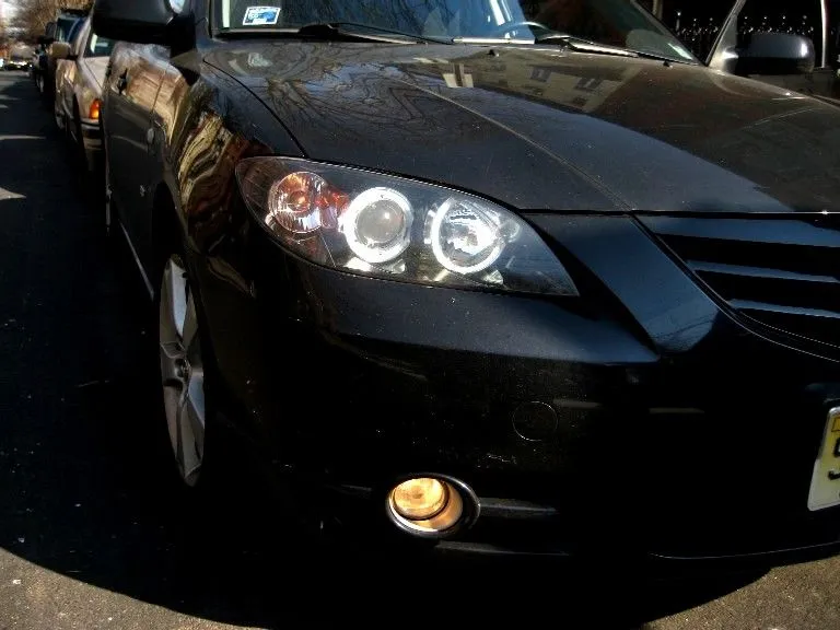

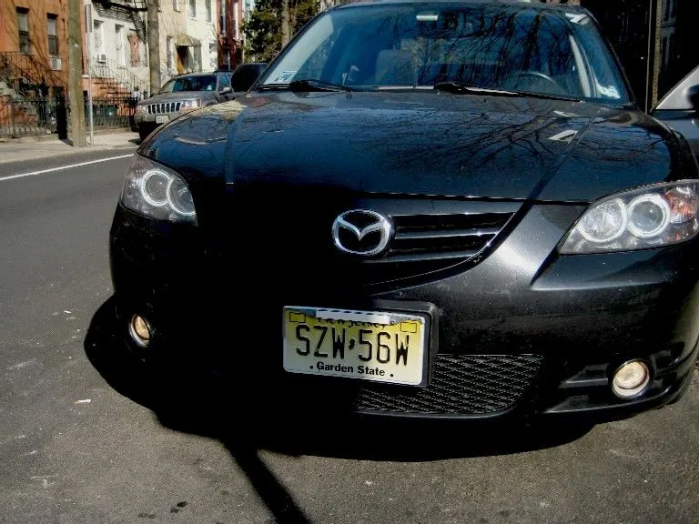

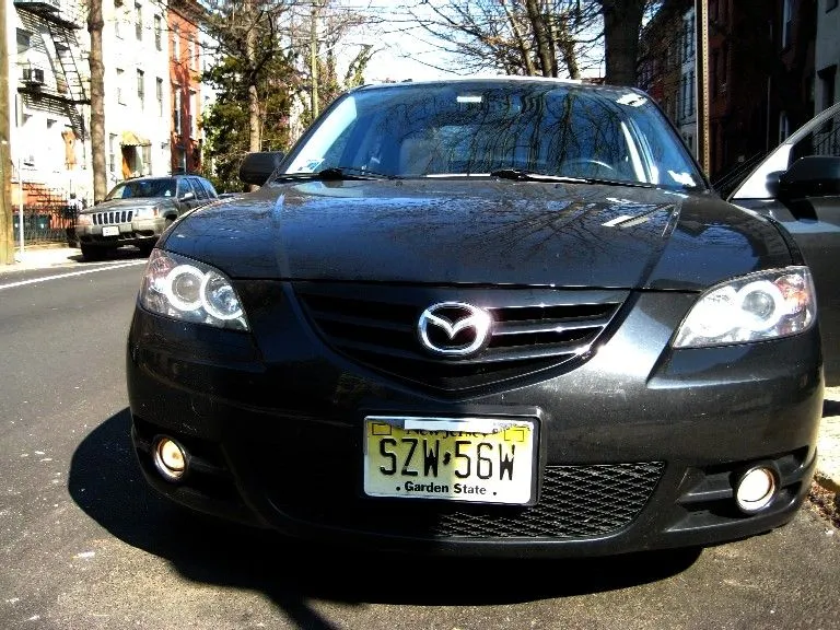

hey guys, just did the mod yesterday, and here are the pics...granted they are during the day, so I had to play with the contrast to really get the angel eyes to shine, but at night time it looks sick!!
Also, here is the wiring I did, again, super easy to do...

you turn the car off and 7-9 seconds later, the fogs turn off...it's kinda cool, like the "courtesy lights" thing that is on audi's and bmw's
yeah, so when I turn the key to ACC or whatever, right before you the engine starts to turn over, they will turn on. It's really kinda cool. I've been enjoying them this way, especially since I have the angel eyes too... now I need to go get HID fogs in like 3000k would be nice and have them as my daytime running lights...
