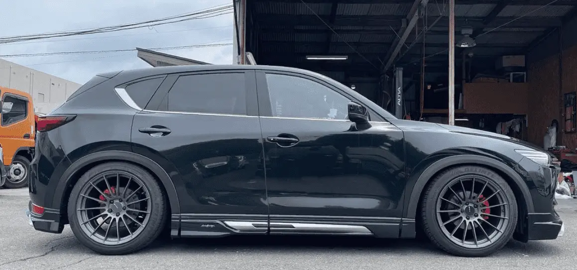

Digging these, but $600/wheel isn't in the budget

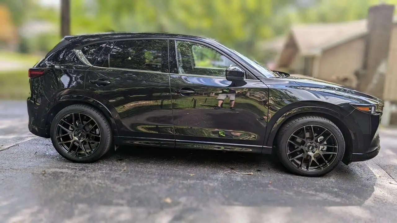

FWIW, I went with these and am very pleased so far.
